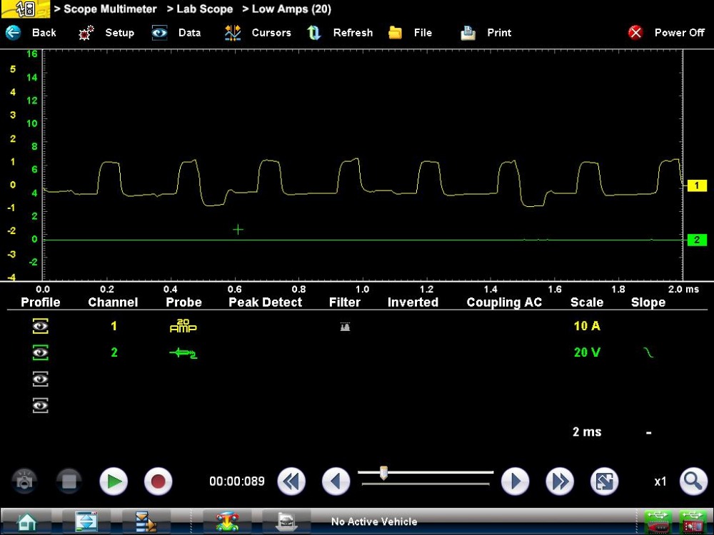

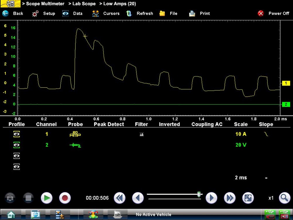

Hi ive placed this link
Hopefully it will work.
What i woulld like do is to have this setup on my verus . Has anyone tried this , and how and what would i need to accomplish this task.
Thanks .
My problem is a very small miss firre at 2200 rpm under slight load.

You will need a Low Current Probe. This clamps around either the power, or ground, (it does not matter which) And produces the Coil Current Waveform.
www.aeswave.com/cart.php?m=affiliate_go&...ric-brand-p8486.html
For Secondary, in the video you linked, he uses a COP wand. I prefer to back probe the coil ground and look at a voltage wave.
www.aeswave.com/cart.php?m=affiliate_go&...n-and-COP-p8764.html

What vehicle are you working on? What wire is your amp probe clamped around?
- paul.simpson
- Fat fingers and small kèypads don't get on
- Posts: 47
8 years 8 months ago #18096
by paul.simpson
Replied by paul.simpson on topic Like for like verus / pico
The amp probe is a max 60amp with two settings 10 & 100 m/amp .
10m/amp as been selected. And wrapped around the main ground for all 4 cop's.. its a vw golf 1.4 mpi 2009.
It had a major miss fire on number 4cyl which was a faulty cop..
It has now a very slight miss fire at 2200 rpm ,slight load but no fault codes recorded.
Idle and full throttle no problems..
