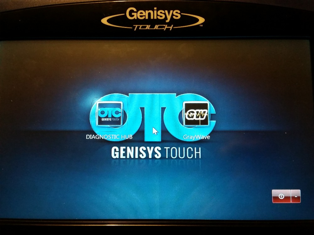

OTC Genisys Touch can be a great tool though I found a couple things I did not like about it. Now its a bit more usable to me.
Video:
Genisys Touch Quick Specs
Operating System: 32bit Windows 7 Embedded Standard
Memory: 2GB DDR3 1066 (Might try upgrading to 4GB)
Storage: 120GB MSATA SSD
Processor: Intel Atom N2600 1.6Ghz Quad Core
Graphics: Intell 3600 Series 1596Mhz. No Dedicated Memory
Keyboards and Mice are allowed.
If anyone knows what replacement lcd panel (high resolution) would fit and work in this scanner please let me know :)

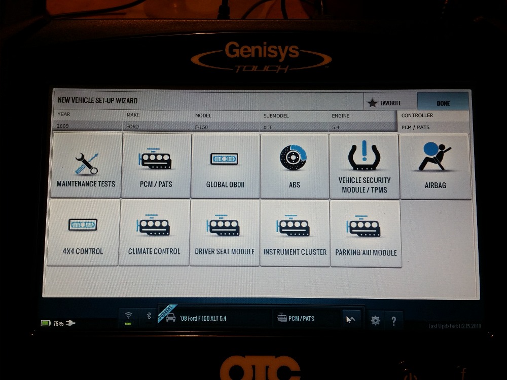

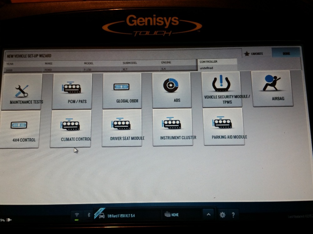

Issue 1.

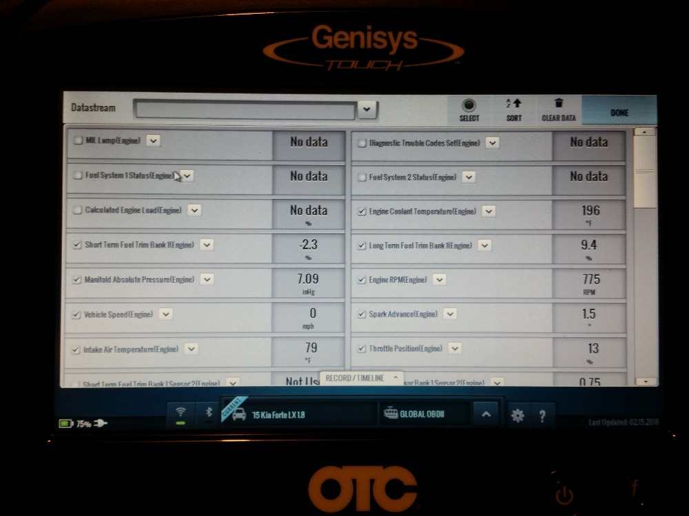

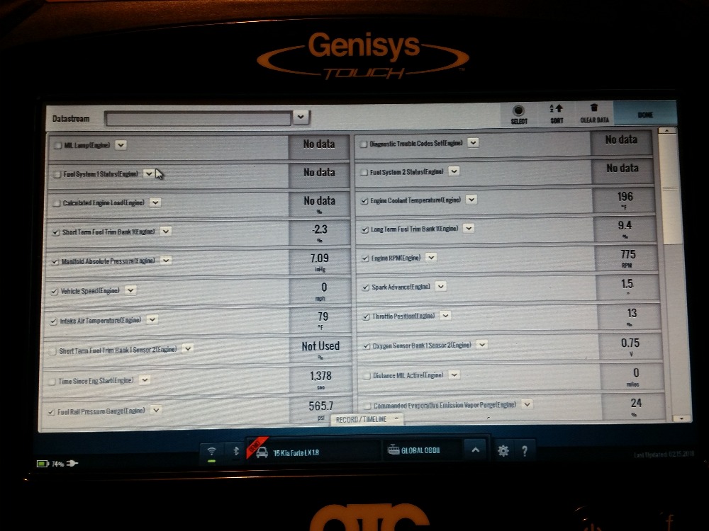

The data pid buffer erasing when having to many PIDs on the screen. Shorter PID lists work but if you need to graph some of those pids and one or two go off the screen, you need to scroll, well now the history buffer gets erased. Really dumb.
Fix 1
Allow the tool to use external monitors at much higher resolutions than it allows natively with externals and decrease the windows DPI setting to 80% vs 100%. The reduced DPI setting has its draw backs such as the text in the "boxes" for PCM, Transmission and such end up slightly outside those boxes. Not a huge issue, the data PID list now fits about 20 data PIDs total vs 14. Unfortunately the physical screen on the tool only supports 1024x600 as a resolution.
Issue 2
Web browser in Diagnostic Hub is HORRIBLE! Did you know if try to add a web address ending in ".org" to favorites the browser will crash? STUPID! I needed access to a real browser and on top of that, I could really use a normal windows 7 layout
Fix 2
Hours of editing off line registries and adjusting security policies to allow the administrator accounts full access instead of restricted access, I now have a fully functioning window 7 desktop.
The two separate user accounts are used to keep the Diagnostic Hub as the primary SHELL so windows explorer and other components do not load. You can still use the Diagnostic Hub in the personal user account. Just takes a little longer to load and the possibility of an issue arising with other components loaded increases which is why I still have the Kiosk Diagnostic Hub as its own shell in its own account

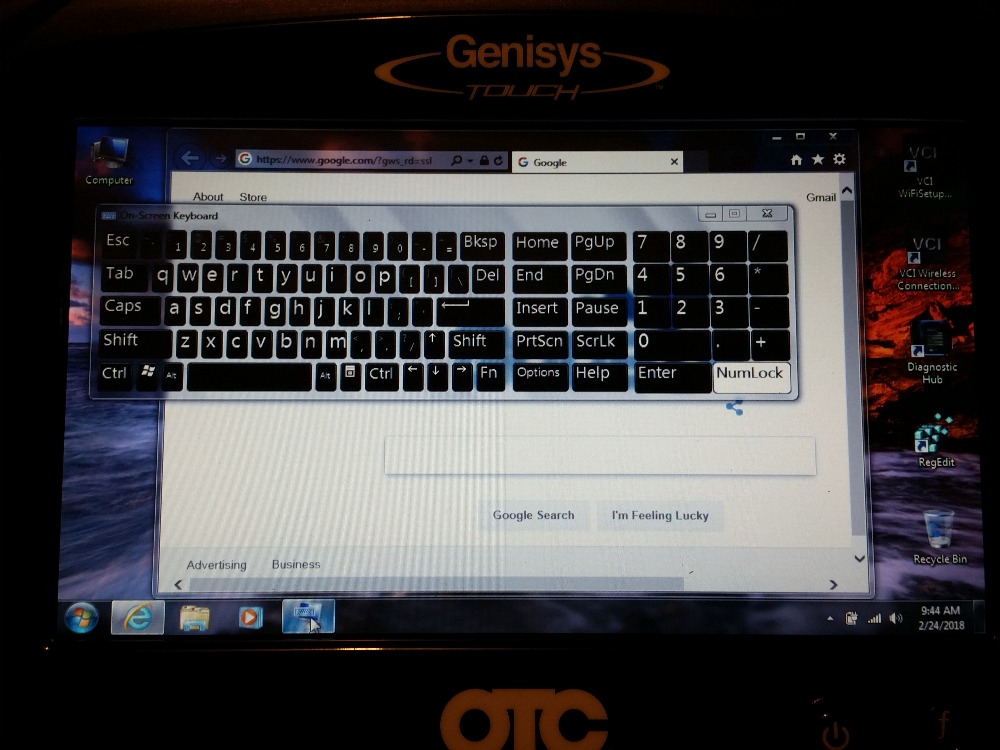

Some more features changed/added/fixed
1. "Print to Email / USB Drive" was broken after creating different users. FIXED
2. Tether to Phone for internet using clockworkmod's tether app
3. Google Drive is used to upload and save all "printed" DTC lists to Google Drive automatically so I can get them on my phone or another pc at anytime.
4. "BROWSER" in the diagnostic hub now opens Google Chrome (Tricky fix)
5. Full network share support
6. AOMEI OneKey Image Recovery used in case Windows or Diagnostic Hub fails. F11 Key during boot up will recover the drive's image. I also have an original image on my other PC
7. Installed Office 2013 so I can create customer invoices
8. Thunderbird installed for a new email account to email invoices
9. Screen will now DIM and TURN OFF after certain amount of time. Seemed this never happened before.
10. After 30 minutes the unit will sleep.
Only annoyance I am trying to get rid of is Diagnostic Hub loading full screen / kiosk mode. "ALT + TAB" works to bounce back and forth but you need a keyboard for that or go into a text field within diagnostic hub so the on screen keyboard comes up and then you can use alt tab from there. If anyone has some suggestions for that let me know. I've tried a few different things & 3rd party software with no luck.
Overall, I wish this thing had years worth of updates coming to it because its got so much more potential now.

I wish I knew how to migrate the OTC software into Windows 7 Pro so I have more features available or even put the software on my laptop which has bluetooth which is required for the vehicle interface. If you know how, I am all eyes :)
The Diagnostic Hub does run on both user accounts. The difference between the accounts is that the "Diagnostics Hub" account uses the diag hub as window's shell instead of explorer. This way it starts up faster and doesn't have other components loading behind it. The GrayWave account loads like regular windows 7 and uses a software called Dexpot to create virtual desktops that allow me to switch from Diag Hub to Explorer very easily. Its the only virtual desktop software I have been able to use successfully due to the fact that DIag Hub runs in a full screen / kiosk mode which is annoying to get out of when just the touch screen is used. Just found the software last night.

Regarding that ALT+TAB problem of yours, you could try to create a batch file that contains the ALT+TAB command then pin that file to your taskbar in windows so that it will be a one-click maneuver. But that would work only if you're in windows going to diagnostic hub. Going vice versa, I'm afraid I don't have a solution for that because even though you lock the taskbar, it will not show once the diagnostic hub is in fullscreen mode.

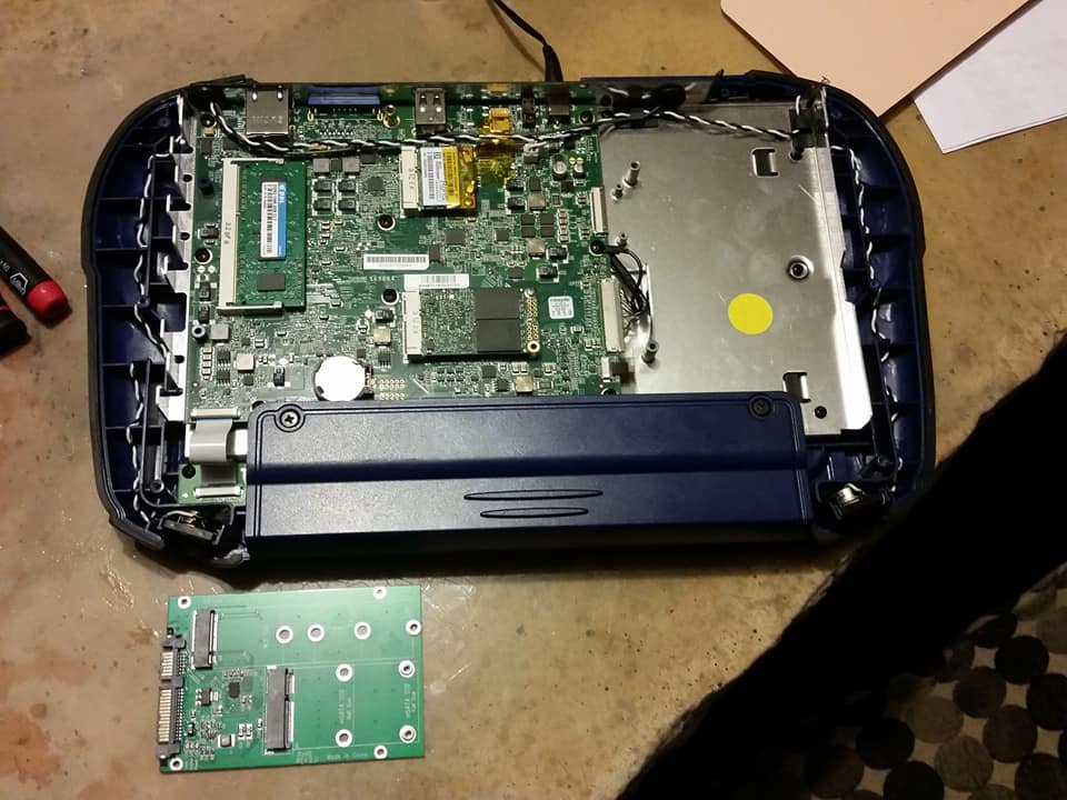

Already did. Removing the MSata SSD, putting it into an adaptor and hooking it up to my PC was the only way I could edit the registry off line and make the changes required to get into explorer. After I was able to gain access to it I then had to reset the group policies for all accounts, even administrator because they had windows locked down hard.
I made a block level disk image of the original setup just in case I screwed it up. I also did a file level copy so I could play around with the files and registry before editing everything on the ssd.

I don't have an issue with the ALT+TAB anymore. Now that I use DexPot Virtual Desktop software I can easily switch back and forth with the mouse arrow. Once DIAG HUB is loaded, its in kiosk mode and you could not gain access to the taskbar or explorer previously. Now I can with Dexpot software.
