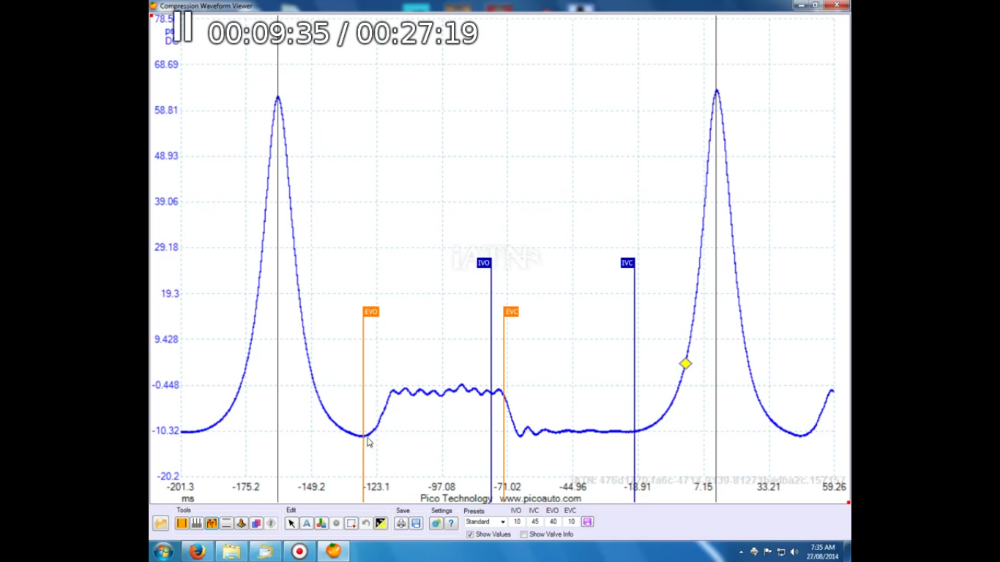

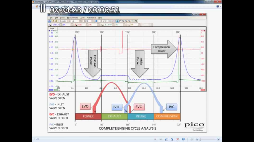

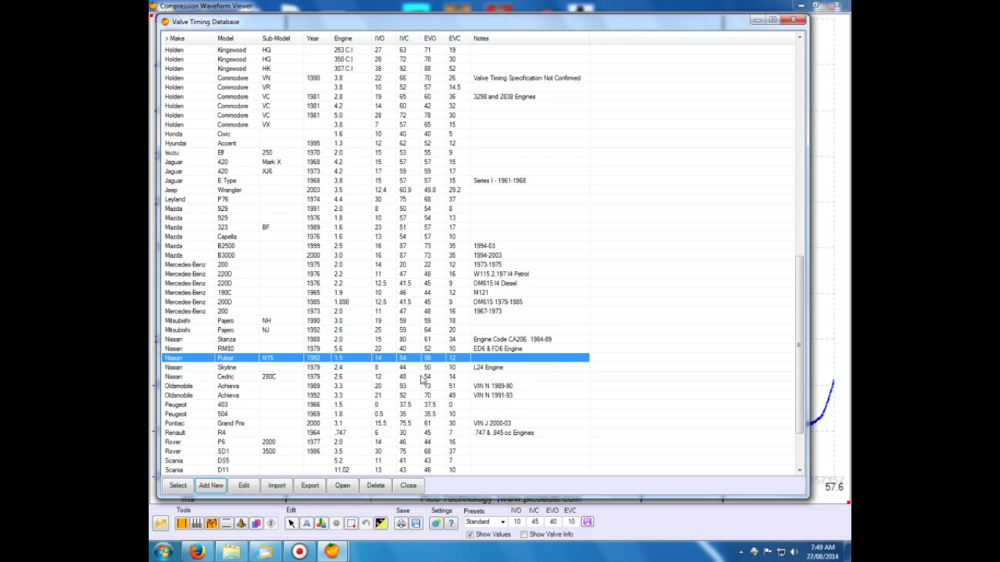

Here are some graphics for reference purposes:
