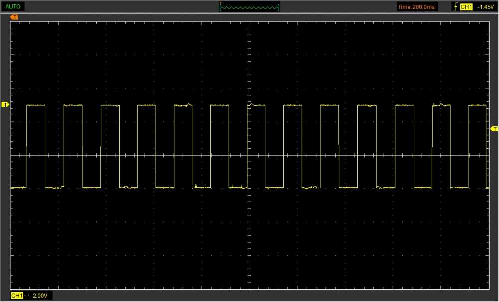

9 years 10 months ago - 9 years 10 months ago #2416 by scopeman
Replied by scopeman on topic Need help on picking inexpensive scope
As Andy says the hantek has it's limitations but for a cheap scope it will work.Here are a couple of waveforms i took when i first got the hantek . I was Just playing around with it and as you can see it will capture waveforms ok . I was a novice when i did these captures (still am really lol ) and got better with it as time went on .I soon saved up for a second hand pico as i wanted more of the features that a pico offers but for the price the hantek is ok to learn with.
cam sensor

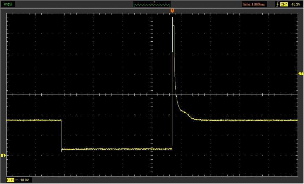

9 years 10 months ago - 9 years 10 months ago #2417 by scopeman
another..
injector voltage
Last edit: 9 years 10 months ago by scopeman.

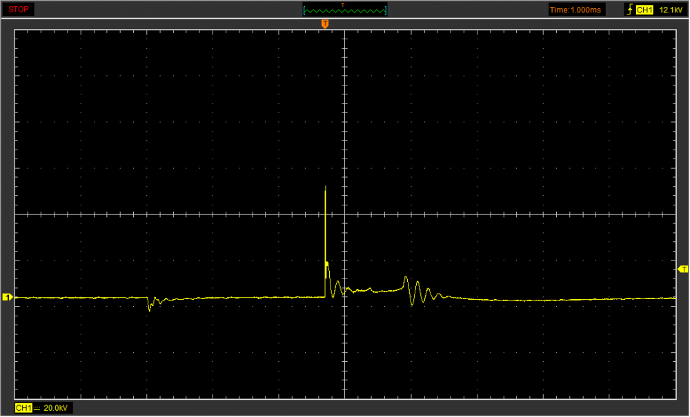

9 years 10 months ago - 9 years 10 months ago #2418 by scopeman
secondary ignition with blowing exhaust

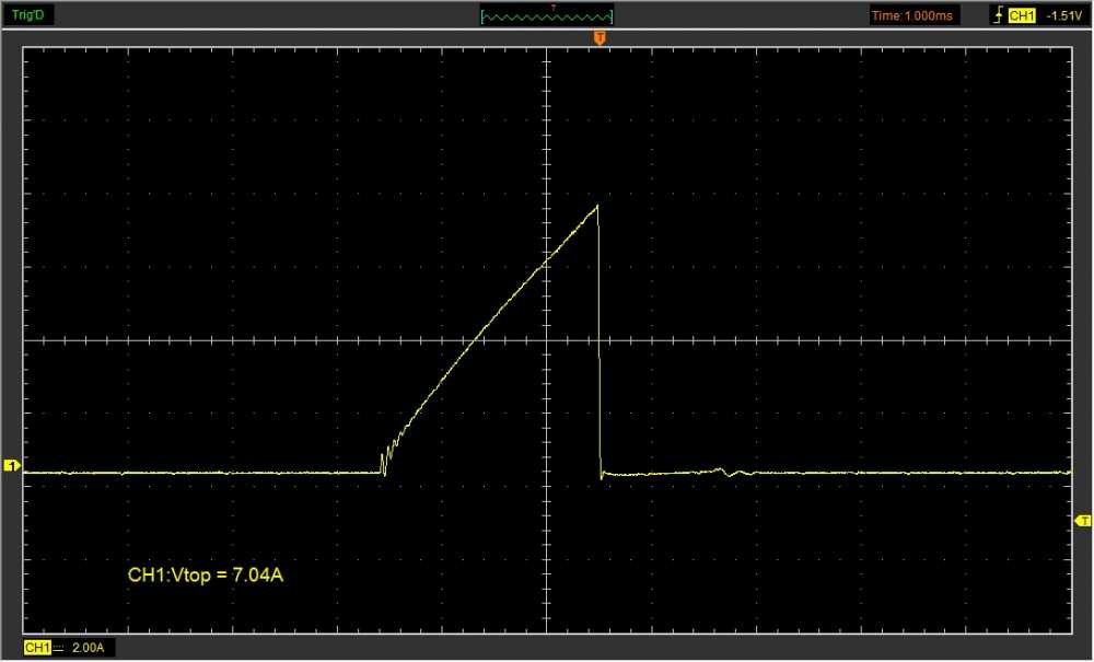

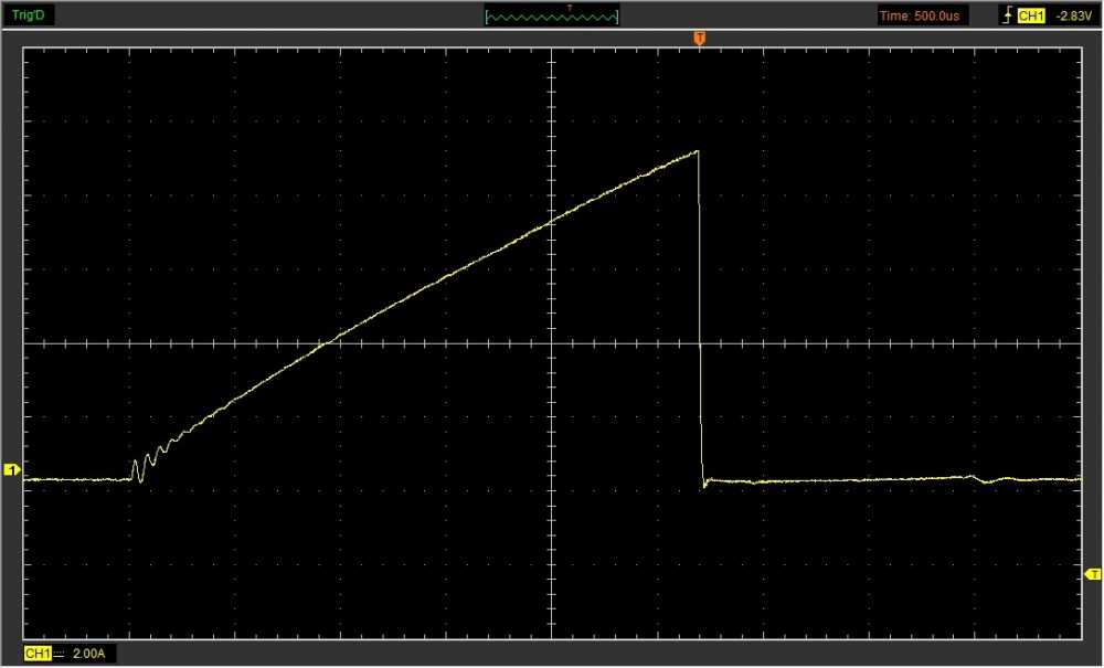

9 years 10 months ago - 9 years 10 months ago #2421 by scopeman
Primary ignition current below :)

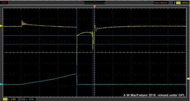

9 years 10 months ago - 9 years 10 months ago #2422 by scopeman
Last edit: 9 years 10 months ago by scopeman. Reason: add file
