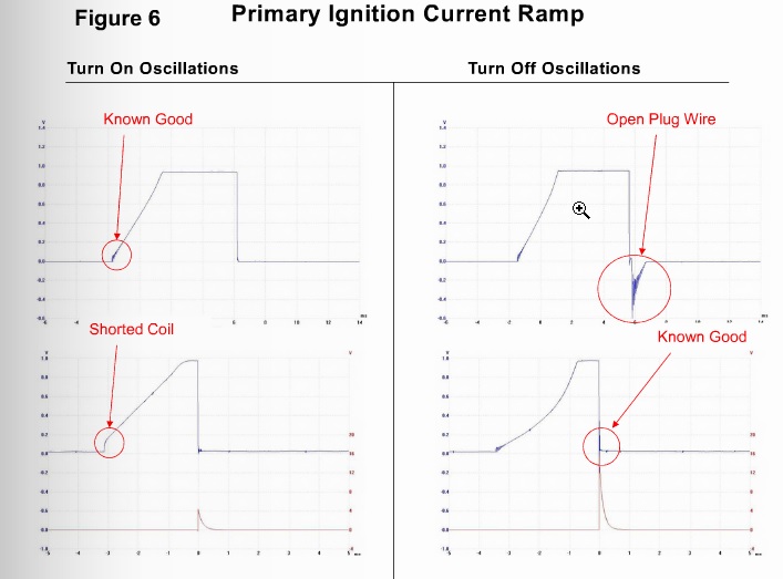

Forgive me if this has been discussed before, I am about halfway through the Engine Performance Diagnostics (book and premium channel) and I am really curious why the primary ignition coil current ramp just drops like a rock on the falling edge and stays there. There's no, or none that I have noticed in the videos, oscillation or bounce, no dip below zero, etc. Are they using snubber diodes or something? It just seems to me with all that back EMF there ought to be some decay and oscillation.

Good question! If I had to guess, I believe there are no oscillations at the end of the ramp because the ramp represents amperage, current flow.
So where on a voltage waveform we would see oscillations and spikes associated with the effects of the magnetic field, on a current waveform, when we turn off the coil current stops. That's it. There is no "left over" amperage once we stop charging the coil. The "work" has been done.

Very good question I had to think about this one, the way I looked on it was to think of old fashioned "make & break" contact breaker ignition.
The way I look at is if the circuit is open there can be no current flow in a circuit.
The same goes for the secondary if the spark is not actually jumping the gap there is no current flowing.
Might be an over simplification but it works for me.
