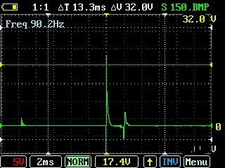

secondary spark concerns

Do you have a misfire on this cylinder! Looks to me (I may be wrong) from my experience I’d say you may have a spark leaking to ground before spark plug

It is not xlsetting a misfire code, but it does seem to have some misfire to it.
I will get a new distributor cap and tune it up.

A lot of energy left after the spark look at the spark plug gap and issue in the plug lead and HT side of the coil

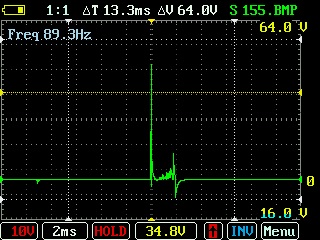

What is the normal KV output of a distributor type coil? I have to go to my biggest KV scale to get it to fit on the screen.
That was on the # 1 cylinder, last night I did replace the spark plug with a new one. The old one had a .042 gap. Factory spec is .039" to .043". I checked the plug wire to make sure it seated good on the plug and cap. The cap end seemed a little loose. I inserted the wire more and rechecked the spark waveform. i will try and post it.
