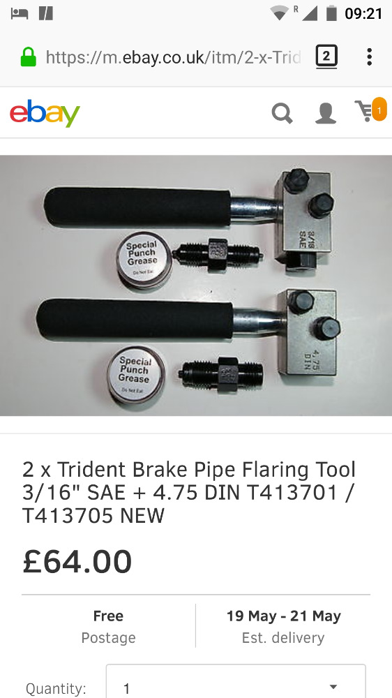

8 years 5 months ago - 8 years 5 months ago #20785
Replied by Andy.MacFadyen on topic Hydraulic Double Flaring Tool Kit
Both of the above work well I had the vice mounted cam action type for years but now use this type it is simple and easy to use on car in tight access areas. it is available under different brand names and either for single pipe size and flare type or as a full set
