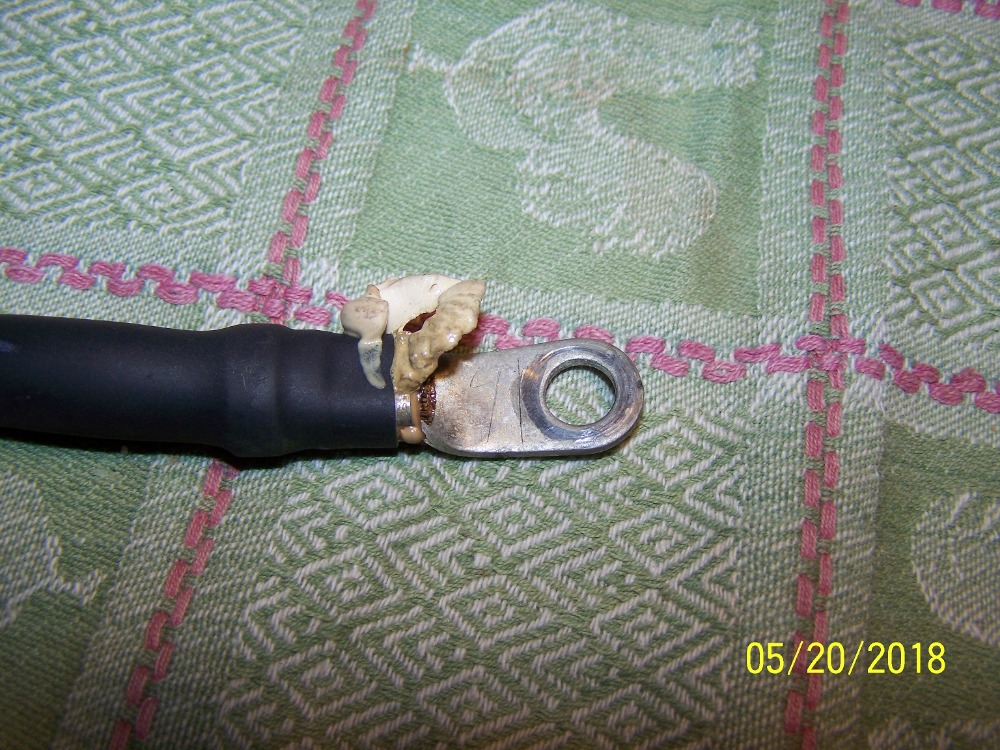

I had a 2011 Chevy Cruze with a problem of loosing all electrical power and found a issue with the the wire that goes from a 250 amp fuse to the fuse box.
the local dealer had replaced the fuse/ relay box under the hood and the wire was not tight enough to make a good connection the vehicle would shut off and not have any electrical power.
I decided to grab my thermal imager and shoot some wires and found this wire with the imager

Hmm--- good tool good work

Nice catch!
I've run into several bad cables on GM trucks, but haven't seen that one yet.
