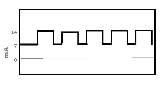

On these active hall effect sensors the signal is actually a change in the current flowing through the sensor. The ABS module supplies near 12v power to the sensor on one wire and it returns to the ABS module on the other wire. The ABS module monitors the current on the return wire.
Doing resistance checks or looking for a voltage from a disconnected sensor although unlikely to damage the sensor just won't give you any useful result. Also the ABS module shuts down the power supply to the sensor if it detects an electrical issue after power on self-test.
The hall effect digital on/off/on square wave BUT because there only two wires the sensor is powered and grounded through the same wires the signal current is superimposed on the 7ma or so current used to power sensor.
With an osciloscope set to measure AC voltage you should be able to see a similar pattern back probing the sensor.
This type of sensor is really sensitive to the clearance air-gap between the toothed wheel and the sensor as it will cause dropouts in the signal.

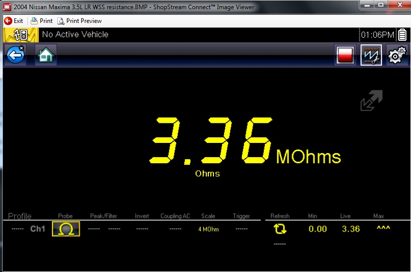

You can totally do resistance measurements, but you get stuff like this:
The manual says not to them because some techs will see that number and (incorrectly) call a bad sensor.

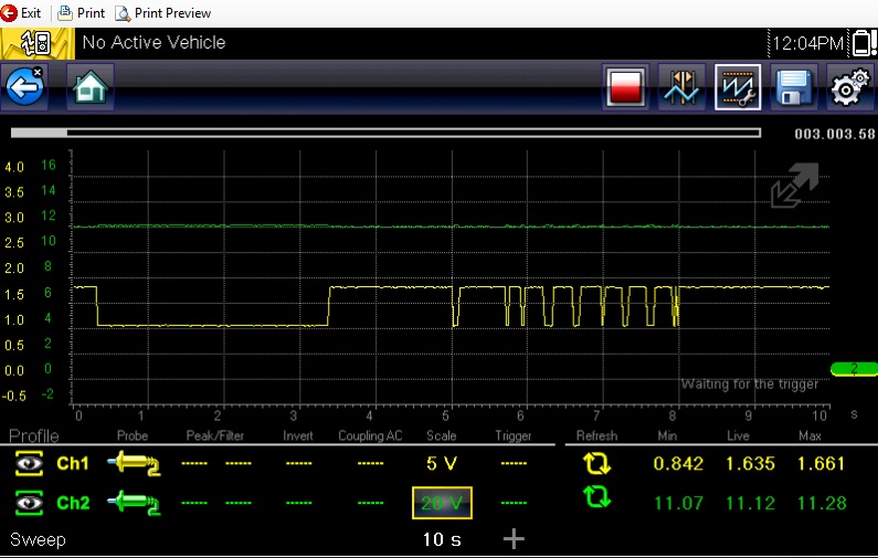

Because most G35's I've seen integrate both rear sensors into one harness (as you saw), scope testing will be a bit easier. If it's truly a RR WSS problem, you'll have the LR sensor signal at the same connector to compare to. :lol:
For reference, I dug up some known good waveforms from other Nissan digital sensors. The exact voltage values will vary depending on if the engine is running or not, but you're looking for around 800mV difference from high to low on the sensor output.
