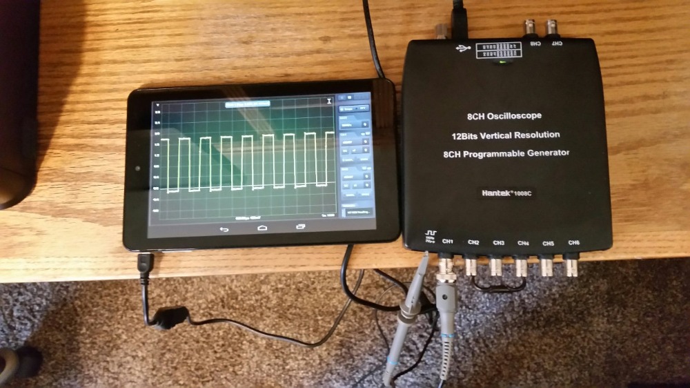

I was playing around with hscope using my Hantek 1008C. I tried it with both my Samsung S5 phone and Dell android tablet. Only lets you use 2 channels in the full version. I am able to power the scope with both the phone and tablet without additional power. I bought a Micro-USB-2-0-A-Female-to-B-Male-Converter-OTG-Adapter-Cable to connect the phone/tablet port to the scope cable. So far I like the portability of this setup. Anyone else playing with this software?

Since the demo software was free I thought it was worth spending 3 bucks on the adapter cable to give it a shot. I guess I got lucky on the compatibility with my devices. My old Dell venue 8 tablet running android 4.42 works. I ran a root checker on my phone and tablet. Tablet shows it's rooted (bought it new at Office Depot). Phone shows not rooted.

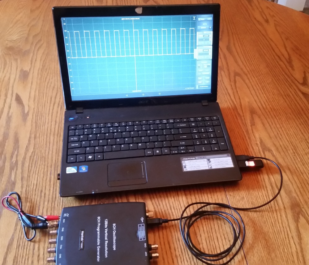

Update, recently I got android working on my laptop with the android X86 software package. Works great with Hscope.

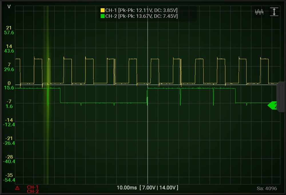

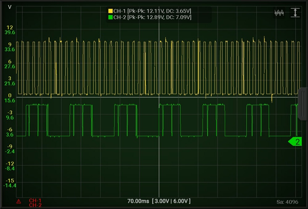

Here are some shots of my 1996 5.7 Vortec cam and crank sensors.
I'm trying to figure out if I screwed up my scope (hantek 6022be) or if this is real. I've been having issues with the truck randomly stalling.
Anyhow, I know this isn't the forum for engine issues but here are the pics using the Hantek and Hscope on a Fire HD tablet (8").
What do y'all think? Obviously there's glitching going on somewhere lol!
