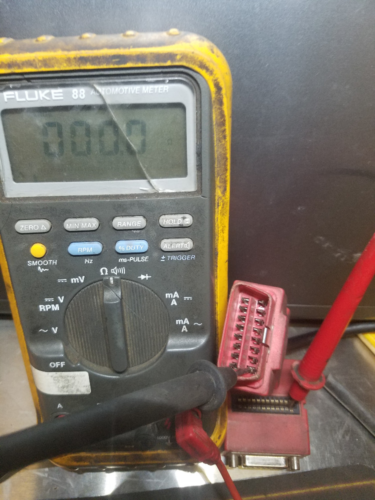

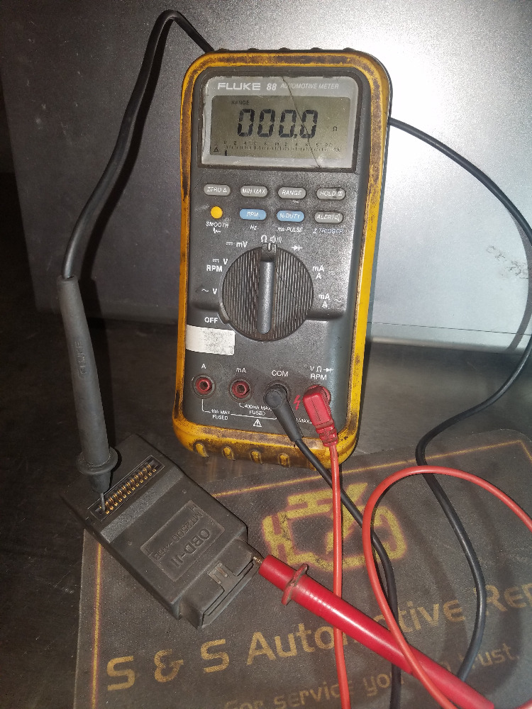

So I did a continuity test on cable and all 15 wires show ok with no in between shorts.
I checked the block on the end where personality keys go. For lack of a better way to explain this there are 12 slots for the key to make contact and a cable and an obd2 side. All twelve slots had a corresponding continuity spot in the cable. slot "12" closest to cut out for the key on obd side had no continuity to anything.
Anyone got one they can check?
or a schematic? Thanks Shawn

Well I have the small grey box that makes you put the keys right at the dlc. If that is interchangeable with you cable then thats my problem as I show the pin you have indicated as "dead/ no continuity " also. Thank you.

I haven't used this adapter in years. If you message me your address, I will donate it to you.
