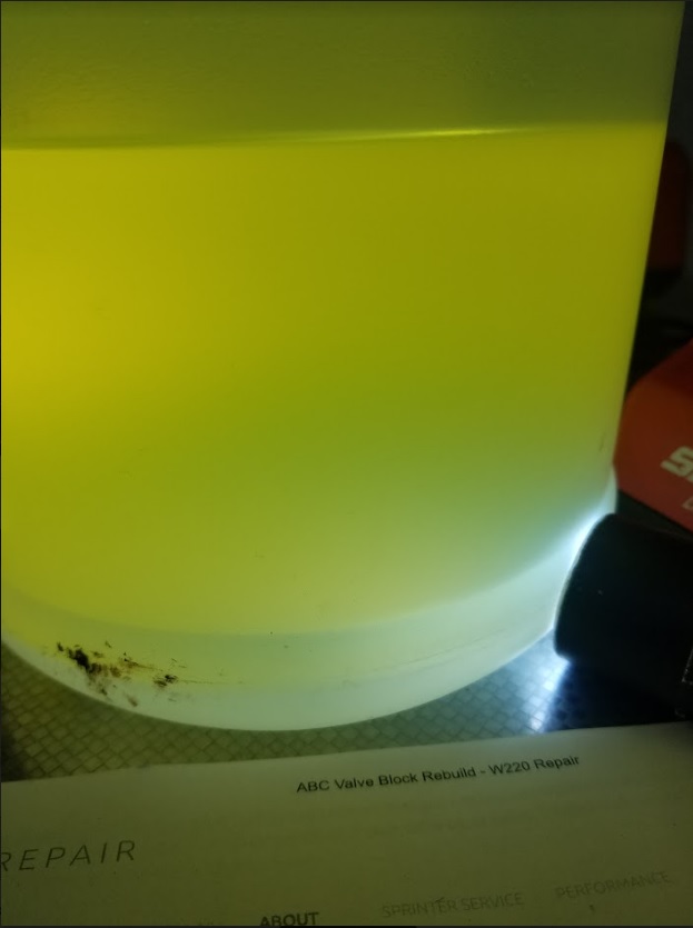

But you probably don't, so you'll need another method to test for ethanol content. The basic idea is this: Take a fuel sample, put a known quantity in a clear container, and add a known quantity of water to the fuel. Skake it up and watch where the separation happens. The water will absorb the ethanol in the fuel, and thus sink to the bottom along with the water. For this example, I added nine parts gas and one part water to a gallon jug. This is a known good sample from my car:
The separation line is way down near the bottom, indicating a 15%-ish ethanol content. Right where it should be, if the pump is telling the truth. Now, the E85:

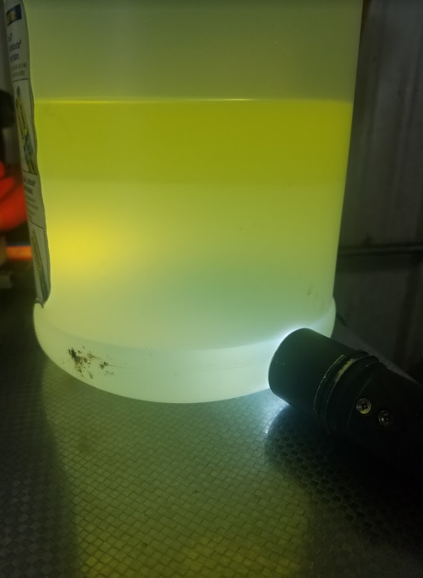

The separation line is much closer to the top. I didn't get scientific trying to figure out the exact percentage - this is obviously way too much ethanol for a non-Flex car.
Measuring out exactly nine parts fuel and one part water wasn't too critical in this example. But, I can see how it would be if you were dealing with half a tank of E10 that got topped off with E85. I'd suggest being as exact as you reasonably can be.

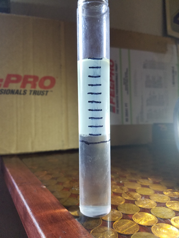

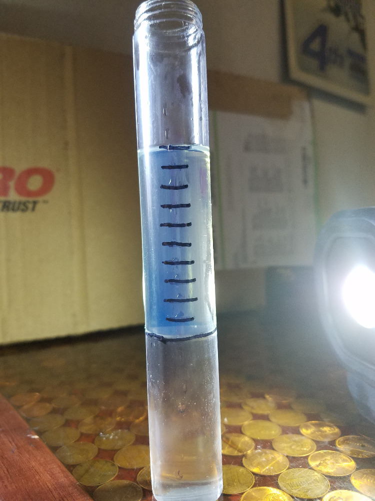

I take a, very, similar approach. I don't worry about knowing how much water I start with. I fill a clear container about 25% full with water. (The amount of water is only important in that there is enough to absorb all of the alcohol.) Mark the water level with a Sharpie. Then, Mark out 10 equal segments above the water level. Slowly fill the container the rest of the way to the top of the last mark.
Then Shake.
This gas is 10% ethanol.
Then Shake.
