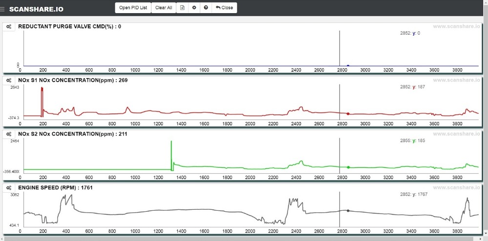

As far as I know all testing is done via scan tool. With no DEF doser operation both inlet and outlet should read close to each other. When the injector is activated outlet nox should drop at least 70%. Normally under steady cruise the nox sensor on a duramax or ISB cummins is around 200-300 ppm.
Here is cruising on a 2011 duramax.
