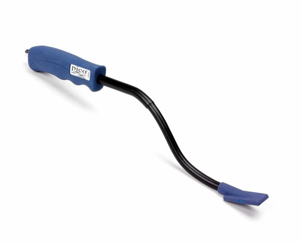

9 years 10 months ago - 9 years 10 months ago #3116 by Dylan
Replied by Dylan on topic AESWAVE COP Secondary Paddle Lead
Tyler wrote:
I've been curious to know if the Pico or Wyze probe are more versatile...
So am I :) Really want the Pico flexible secondary ignition probe.

9 years 10 months ago #3129 by SLCDIAG
Replied by SLCDIAG on topic AESWAVE COP Secondary Paddle Lead
I was considering that one but it looks way more bulky than the AES one. I work on a lot of
Fords so that was what convinced me to get the smaller profile AES Wave COP probe. I think i'll still get the Pico anyway though. LOL

9 years 10 months ago #3237 by FlyinHawaiian
Replied by FlyinHawaiian on topic AESWAVE COP Secondary Paddle Lead
Thank you all for sharing your .02, I really appreciate it.
Looks like (as in most cases), one tool will not do it all. I guess all that means is that the Christmas wish list is going to have one more toy added to it :P
Helloooo Pico Probe ;)
9 years 10 months ago #3255 by Tyler
Replied by Tyler on topic AESWAVE COP Secondary Paddle Lead
Let us know how the Pico Probe works out! Genuinely curious to hear if it works on other stuff that the Paddle Probe doesn't.
