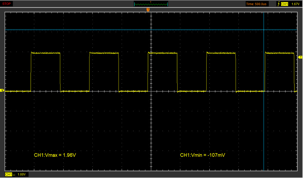

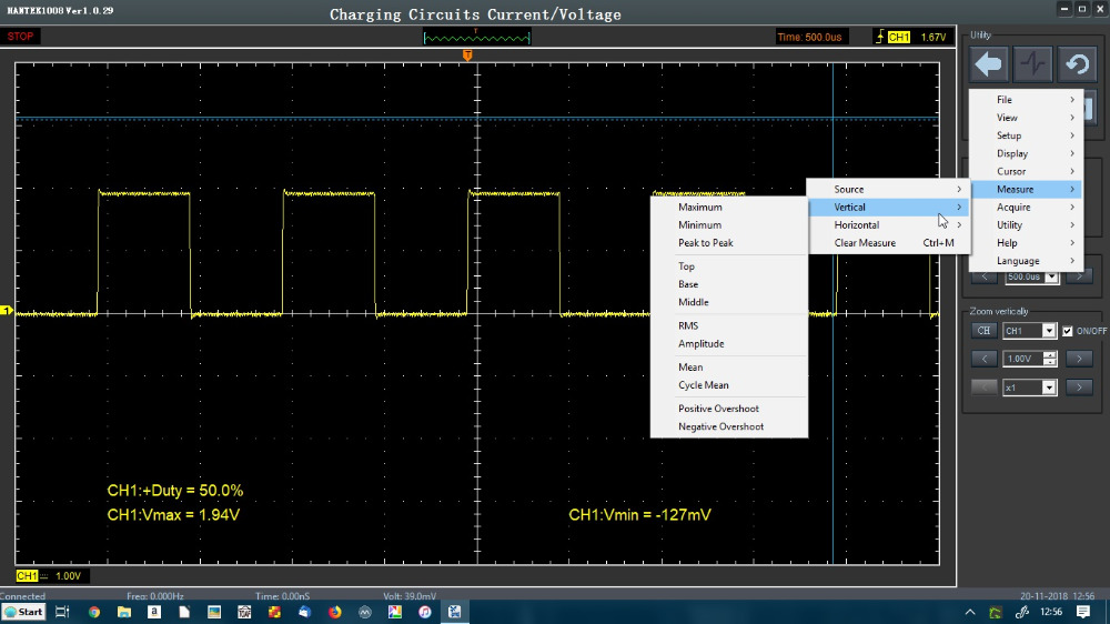

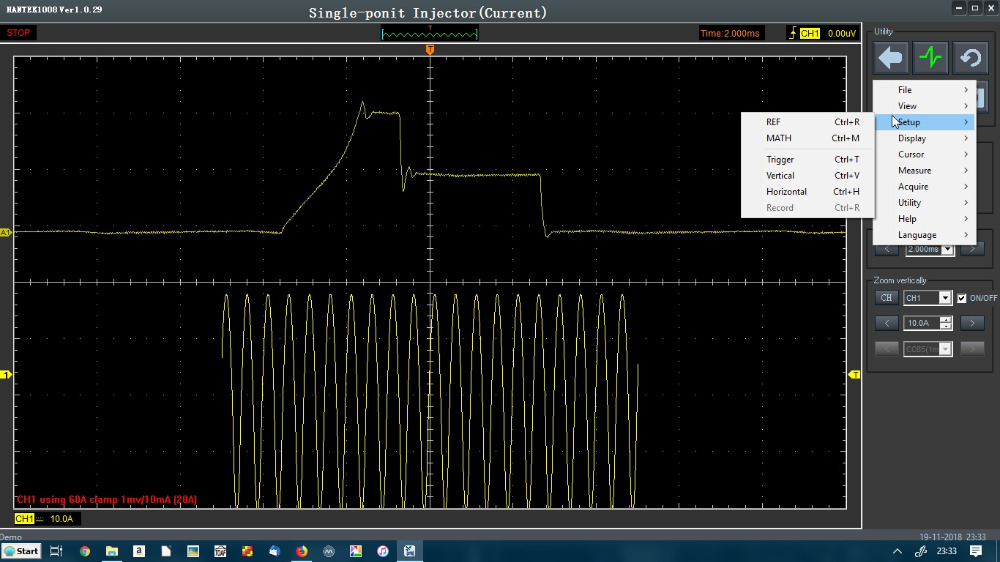

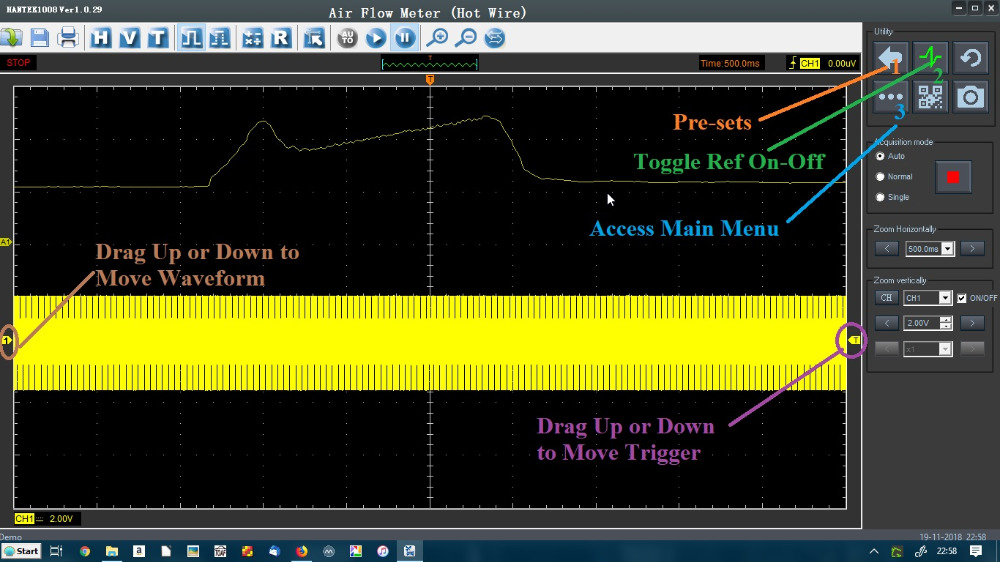

The controls that on the old version were formerly on a ribbon menu along the top of the display are now accessed via the button marked 3 in the screen cap below. Once you access this menu features including Math and Measure ments can be toggled on or off.
Select "Measure" then add the type of measurement you want to show on screen or use the cursors

Thank you very much Andy, I will try this at work tomorrow! So much drama to simply show voltages - I think this program is the "Windows Vista" version of scope software

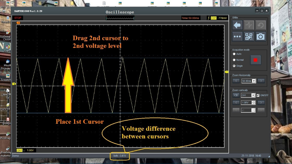

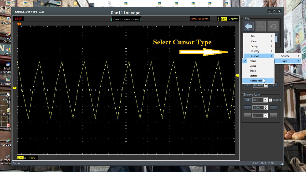

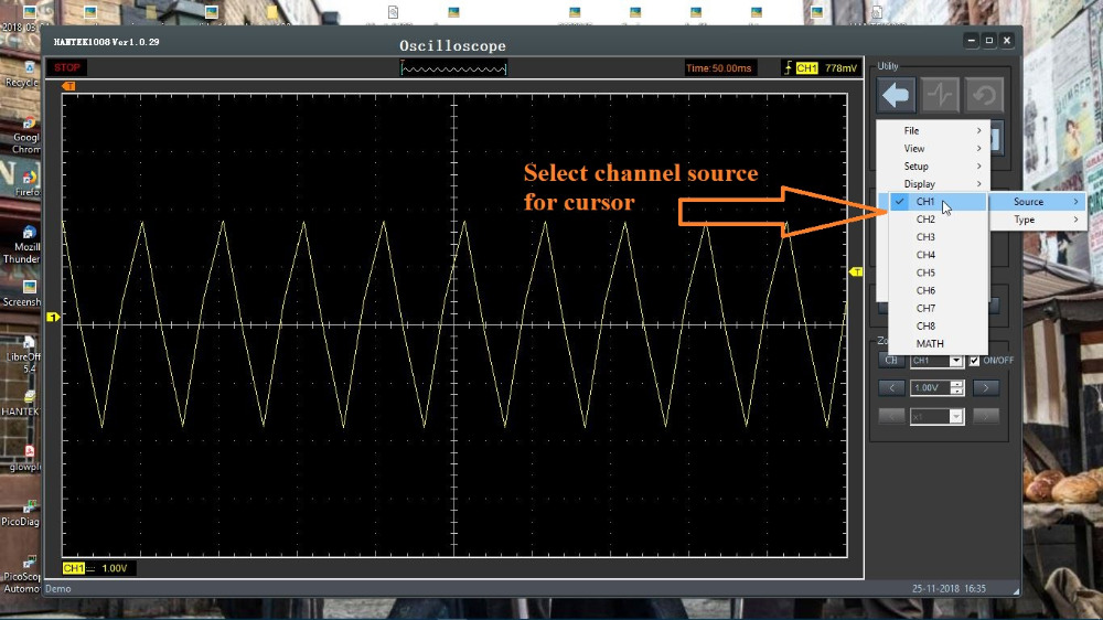

Using cursors is really useful the Hantek ones are not the easiest to use but they still work nicely. Hantek have 3 types of cursor Voltage, Time and cross hair best to stick to Voltage and Time as the cross hair option can be a bit frustrating until you get used to the way they are set.
