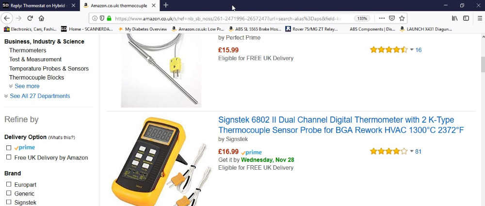

I would go old school measure the temperature at raddiator top hose inlet with the by-pass (heater) hose temperature close to the cylinder head as the engine warms up from cold. You should be able to see a huge difference between the two until thermostat opening temperature is reached. I use a 2 channel K-Type thermocouple for this as they react faster than other thermometers. 2 channel thermocouple meters are very cheap on eBay and Amazon

Replied by Andy.MacFadyen on topic Thermostat on Hybrid
The following user(s) said Thank You: Noah, Tutti57
