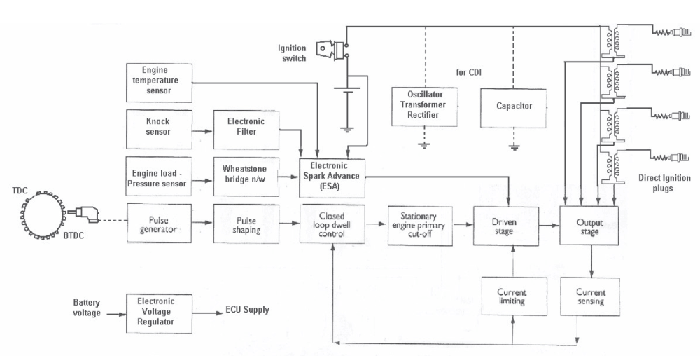

Okay before I start with the circuit stuff, here are some info regarding the basics of circuit protection . This is all based on the Arduino which make it easy to understand and to play with because its dirt cheap, this should give you guys an idea of how it works, this is all simple and remember there are many configurations, this is just to give you some insight. Also remember the IC's they use in ECU's do A LOT MORE! The first thing is safety & reliability. So the internal protection functions of IC's used in ECU's are pretty legit.\
To add for those that want to play with circuits, here is a nice Circuit Simulator to play with. www.falstad.com/circuit/circuitjs.html Keep in mind that Simulators aren't anything like real life.
The following section pretty much handles all the RPM related circuits. In this ME7.1/5/7 system its handled in the CJ910. The same chip takes care of the 5V supply. Everything is pretty much self explained.

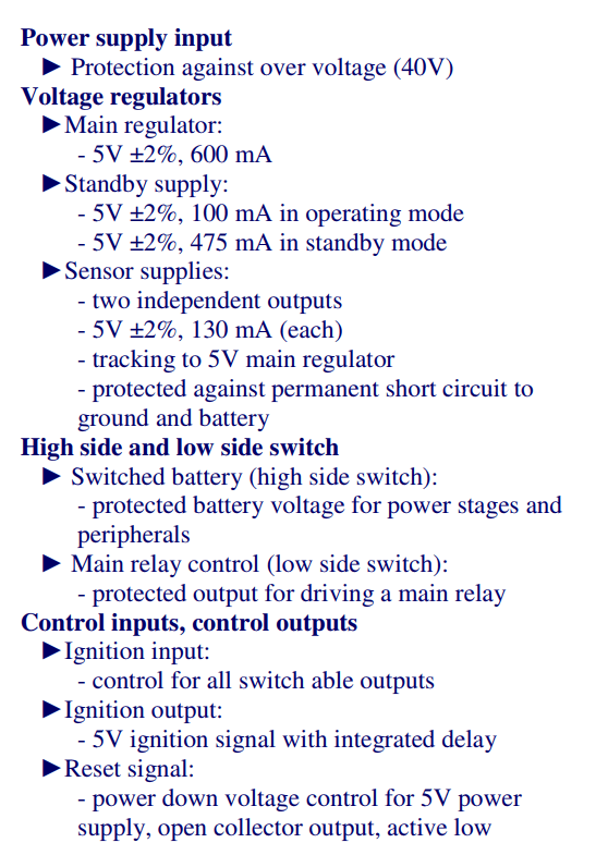

Here a snip from the CJ911 see the Sensor supply info's. Permanent Short to Ground Protection, That's just the chip itself. We can go into detail later about the different states/flags that chips set when they find something is bad/good.

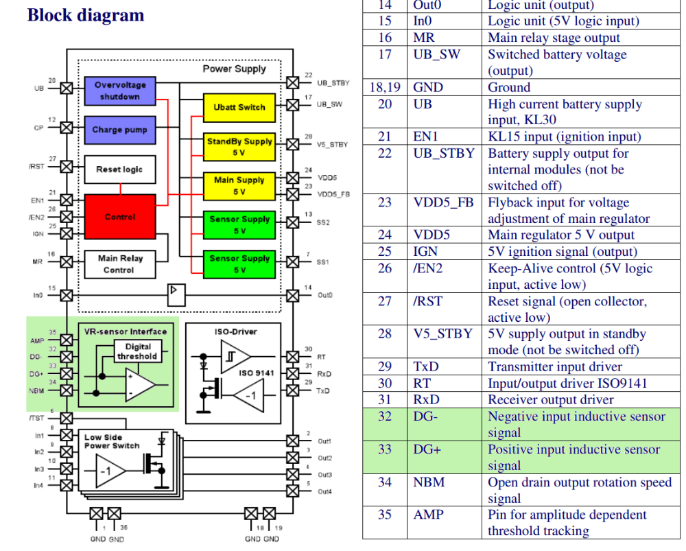

Here is a snip about the CJ910 the CJ911 is pretty much the exact same thing.

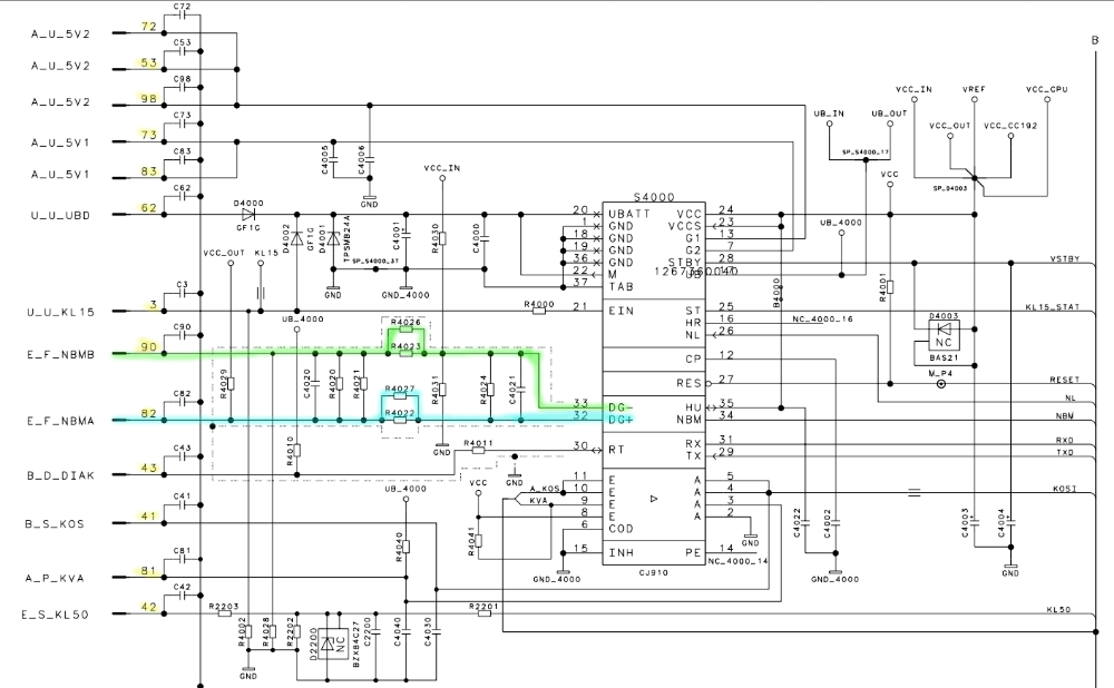

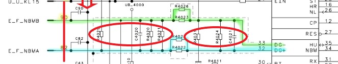

Here is a snip from a Schematic regarding the System Basis IC. CJ910/911
And here is a snip from the Datasheet regarding the CJ910/11.

Nice.. Thank You, Can you expound on the High side and low side switch? Is this 12vdc+ and 5vdc+ or ground control of the 2 voltage levels?
I'm probably not asking this correctly so please be patient. :-)

Uhm I think I get what you are asking... How the High Side and Low Side switches work and or what they are for?
Either way I'll give it a shot. The way I understand it...

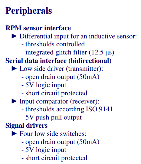

Looking at the snip/image from the CJ911 datasheet: (Also I added the peripherals snip...)
1. Its protected. self explained
High side:
1. It gives power to the power stages and peripherals. Basically handles the Power(supply) for the ECU(its onboard chips) and other power outputs to the peripherals listed in the added image. (which i forgot about in the first post sorry...)
So yes that would be Battery Voltage and your 5V. In some cases I have seen them taking it down to 3.3V as well for internal components(chips).
High side is usually for switching your power rails on/off.
Low side:
1. Main relay Control. self explained ground switch for relay control see: Ground side vs Power side (High/Low) switching
Take that into mind; considering a "No Main Relay control" or anything else this chip handles, when having done the rest of the checks... Like you are sure the ECU is at fault. It can then be something as simple as that part of the chip... OR 1 broken/blown/shorted/over-heating complete chip either way if you had to repair it you would replace the whole chip(1piece) and if needed any supporting components esp caps.
The Block diagram shows the different sections inside the chip(well what's released to public).

The schematic from the system basics of the CJ1910 specifically got my attention. I've (badly) marked it up in Paint for clarification.
First, is it correct to say that everything left of the red line is outside the physical module? And everthing to the right is inside?
Second, as I understand it, this circuit is a variable reluctance sensor reporting to the CJ1910 so it can power some kind of main relay. Basically, a crank sensor input so the fuel pump gets turned on? If that's so, what's with all the resistors and connectors (circled) between the positive and negative? :huh: I understand you're not the engineer, so any speculation you have would be appreciated.
Third, what's the purpose of C90, C82, and its circuit (arrow)? It would appear that all pins are connected to this common 'bus'. Or, am I reading the diagram incorrectly? :silly:

First, is it correct to say that everything left of the red line is outside the physical module? And everything to the right is inside?
1. Yes.
2.
2.1 Yes as far as I understand it. Its the circuit for the RPM sensor; Being Inductive Type.
2.2 Well looking from a high point yes... But its a lot more complex than that or not so much complex but rather important for a good RPM signal. From this ECU_Design_pdf see the following Flow Chart & Block Diagram.
The first one kinda goes in hand with what you suggested.
The second shows how import that input is.
2.3 Yeah I'm no EE... I would think various support. Protection, Filter, Stabilizing, Correction.. I dono. I'm sure it has to do with the good waveform's (bottom page) you get when you scope them(depending on the scope & system I guess) also in this case its AC. I'll dig and see what I can find about this...
3.
- Same as above I guess. Protection, Stabilizing, Filtering, Response...
- Arrow tip is GND MB.
This was something that I thought of while going over the diagrams and datasheets you posted. Obviously, the parts manufacturer wants to sell their product, but doesn't want to divulge (too much) how exactly they make the magic happen. Have you run into situations where you were left wanting for information because it wasn't provided by the manufacturer?
Second, I'm still digging deeper into this CJ1910 chip. Do you find that this type of 'job delegation' is common across different brands of ECU's? As in, is there usually one chip (like the CJ1910) that handles 5V/crank sensor input/main relay operation, or do different OEM's break up the jobs differently? Are there other common layouts that you've seen?

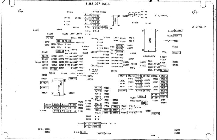

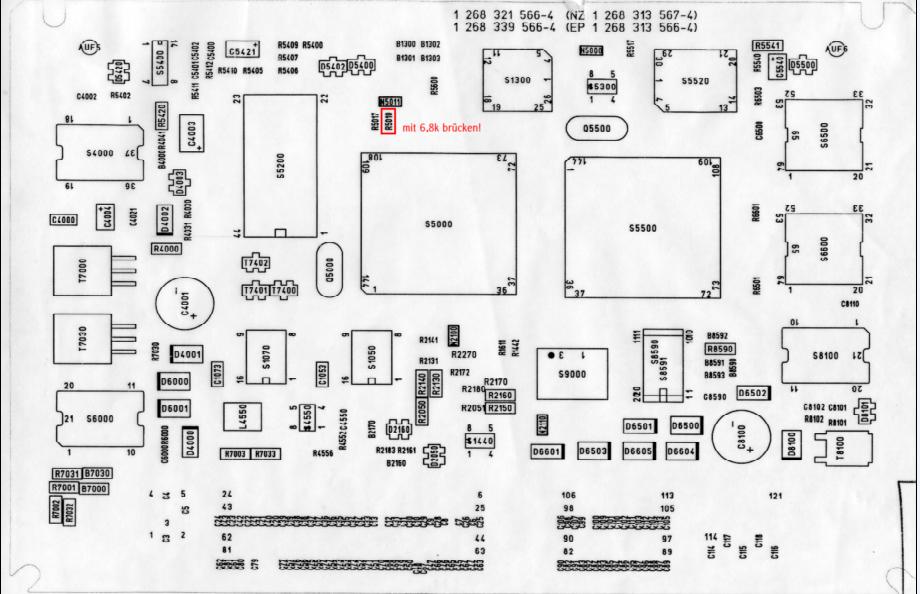

I' ll attach some material on the Bosch ME 7.1x ecu, for the interested ones. I do have more, for example on the ME 7.5 type if you want to.
Indeed. Esp with automotive electronic IC's... But I have to say having spent so much time in repairing more common equipment like laptops/desktops/automated systems(feeders, conveyor belt controllers...) and all the rest of the stuff... I got to understand the concept of how they usually put these things together. Like the CJ910 or CJ911 pretty much reminds me of the BQ24767 chips that handle charging along with the EC that controls the States(starting the rest of the power rails), the TPS51125 (and the rest) that handle the 5V & 3.3V. SPI/I2C and all the other busses. All the things mentioned are just some random selected ones that fit the above discussed IC(CJ910/11) there are allllot more things not mentioned here... There are so much! but having a general understanding of how it all works helps with not knowing the "insides" (datasheet stuff) of the particular IC's because you can kinda fill in the blanks with the other info. At the end of the day its all pretty much the same sh*t.
I guess you meant CJ910 | CJ911 they are both the same, just different models.
They seem to do the same... Like with pretty much everything else they always do the same thing, some may have some tiny different tweaks here and there but the fundamental thing stays exactly the same. Some chips on Laptop MB's, I found are easily interchangeable like you can swap a different make with another make in some cases. The overall circuit setup/layout is very similar as well ecus -> laptops/desktops/controllers; different power rails, signals... The external / extra support components like external Transistors/Mosfets and Passive parts are sometimes the exact same this is between different ecu makes as well. I found the main difference also pretty obvious is the MCU(Microcontroller) on ECU's, esp between different makes. Along with its supporting Memory well not so much the memory chip but the ROM internal/external(BIM/Image/Firmware/BIOS all the same basically like computers on chip level).

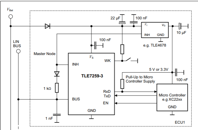

Looking at the Infineon Products you'll see how many things they have that does the same as the bosch ones. And the bosch CJ910/CJ911 we have been discussing is actually very old... Infineon has this TLE8080 under Engine Management IC's that's pretty much the same thing. (Have reached the limit on links... so find it from the Product List)
But some have more some have less... You'll see that the Infineon System Basis IC's ones offer some similar options but lacking some so they have Management IC's and Different Power solutions so you could break the "jobs" up if needed to some extend. You always have to think about reliability & safety. If this fails, that happens. Like the crank and cam sensors... Take a look at the video from the link above about one of the System Basis IC's Evaluation Board, will give you some insight on how things can be controlled with software.
So finally it's really down to the micro-controllers. They can run differently and have different programs(BIN, Flash, Firmware...) Programming them enables the use of any common "worker" chip (inputs/outputs) to do things you want it to do. putting it very basic...
Also it depends on the functions the "worker" chip offers but what I'm saying is, they made a bunch of chips that do the basic things and the "Micro controllers" could use those chips in different ways. Hope that makes sense.

I feel like there's tons of great information in those data sheets. For instance, I picked out one of their LIN tranceivers - a TLE7259 . I'd always wondered why a LIN network shows battery voltage in its recessive state. All the automotive training I've seen tells you it should be that way, but never why. :silly: But the data sheet spelled it out!
At the master node, the LIN bus is wired directly into B+ across a 1K ohm resistor and diode. Does this matter to my diagnosis? Probably not, but it's still cool. B)

Tyler wrote: If that's so, what's with all the resistors and connectors (circled) between the positive and negative? :huh: I understand you're not the engineer, so any speculation you have would be appreciated.
So as it turns out, yes, I was reading the diagram incorrectly. :blush: Those aren't connectors, but capacitors. Duh. This makes way more sense, especially as I spend more time reading product diagrams.
The engineers love to throw a bunch of microfarad capacitors in between circuits, because... electrons? :silly:

Tyler: Yeah they sure love to "cap" everything. (stable, filter ,safety....)
Indeed. Good food for thought.
