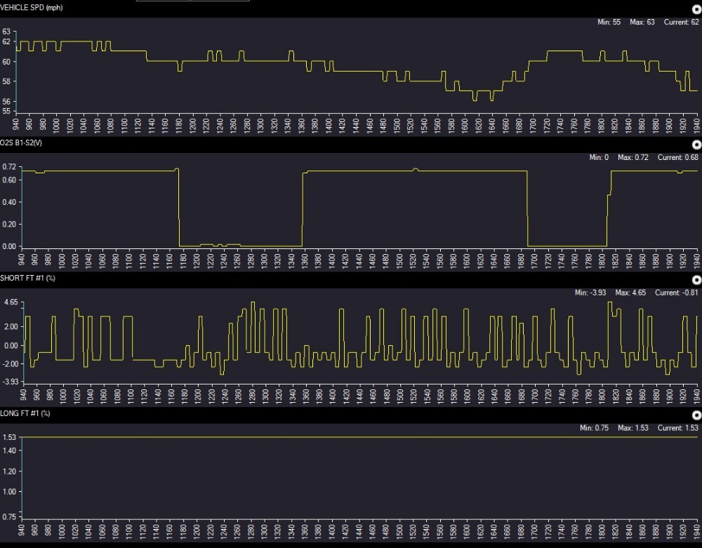

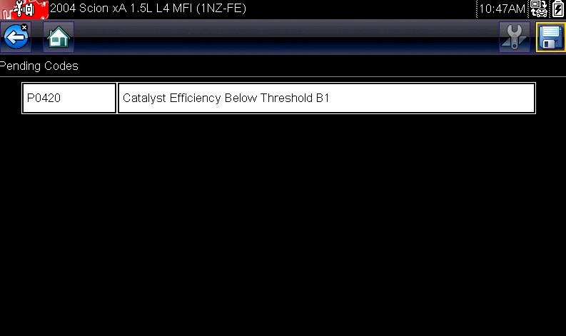

But hey, that's what experiments are for! So I rig up the good ol' Scion xA guinea pig with a backprobe in the downstream O2 signal wire, scanner carefully watching fuel trims, and a test light at the ready. After getting everything warmed up with a good long test drive, I pull the downstream O2 signal low with the test light and watch the data. The arrows denote when the test light is connected:
Yeah, that didn't change the trims at all. :unsure: No codes were set while testing, so I don't think it went into any kind of default strategy. Even if the amount of control is limited to a few percentage points, I'd think we'd have seen it here.

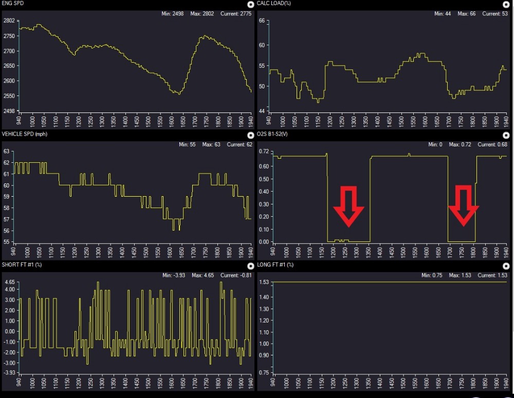

Viewed another way:
Noooooope, no change. :( Maybe the Scion is too cheap a car to include downstream control? Or maybe it doesn't like the 0V reading. Might be a job for a variable resistor.
Side note, while I was there, I decided to see if I could create a false P0420 code by pulsing the downstream O2 low while driving. Turns out, yes! :lol:

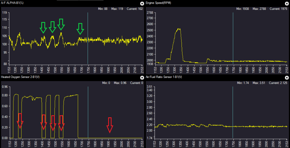

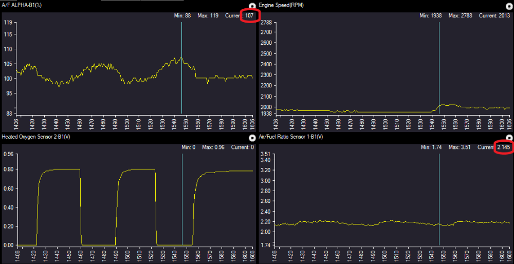

Finally got around to doing some more experiments. The new guinea pig is a 2013 Nissan Sentra. Upstream wideband, downstream O2. Service info lists P2096/2097 as possible fault codes, so we know there's some kind of downstream control at work.
Just like last time, I got the car warmed up and cruising, then started applying the test light to the B1S2 signal circuit:

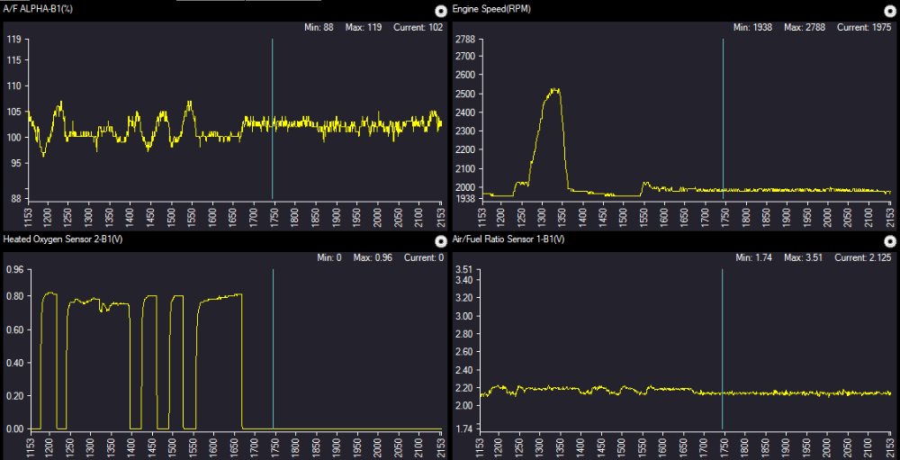

For clarity, I've marked up the parts when I applied the short:
There's a pretty direct, immediate correlation between pulling the downstream sensor low, and a rise in the Alpha (short term trim). About 5%, depending on when you measure it.

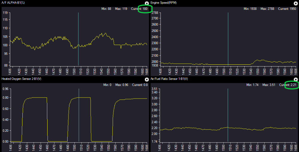

There's also a corresponding change in the upstream A/F sensor. Except, it's opposite of the Alpha. :blink: Right here, everything is normal:
The Alpha is textbook, and the 2.2V from the upstream A/F indicates a stoich mixture. Now the short is applied:
The upstream A/F is saying rich, but the Alpha is adding fuel. :silly: This is exactly the kind of opposing reaction we saw in SD's P2A00 video. Downstream fuel control at work.

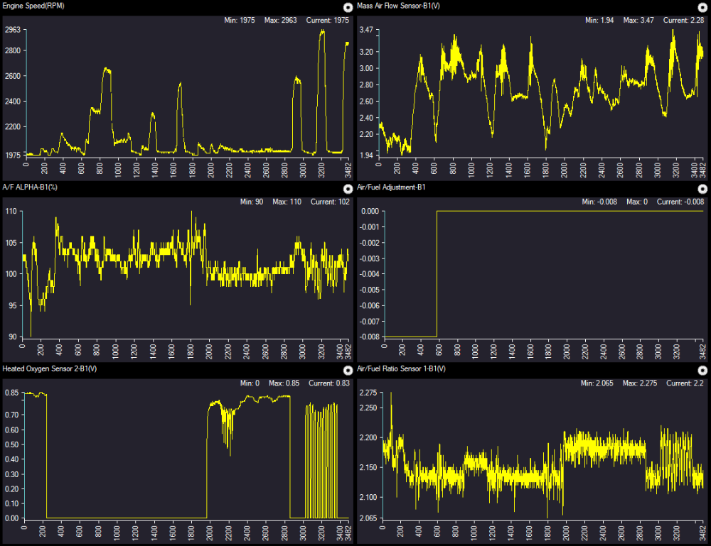

For giggles, I also left the short applied during a highway cruise just to see what'd happen over time. I know from service information that the Air/Fuel Adjustment (or A/F ADJ, depending on your scanner) is related to the downstream control system, yet that PID didn't change much with the short applied. :( The short was applied for about five minutes in this capture:
No codes were set at any time during testing. Maybe I just didn't leave it applied long enough?
Sure hope all that junk made sense! :cheer: Feel free to poke holes in my testing as needed.
