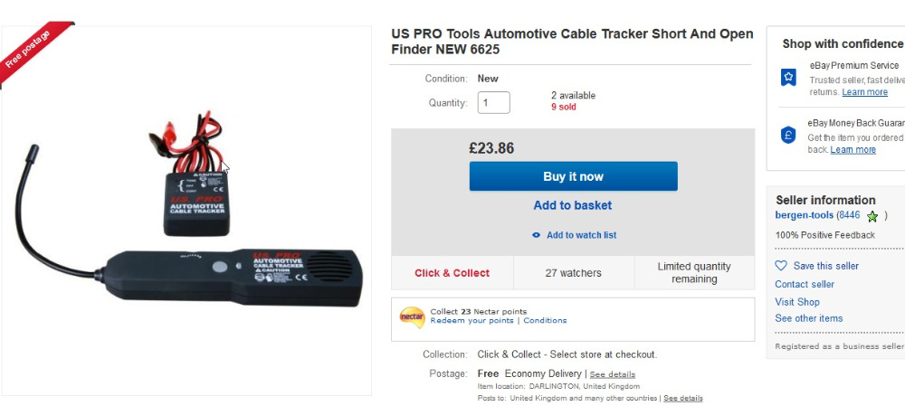

Hi
I was wondering if anyone was using any type of tone generating wire tracers to find the location of breaks in an open wire in a wiring harness and if so which one seemed to work best. Thank You

I have one of these is sold under different brand names I have only used it once and the instructins aren't that clear I am not 100% sure I have used it properly as the result was pretty mixed as I lost the signal about 5 feet in a very thick wiring harness

I have the power probe one and it's kind of dicey.
The signal can be leaked into adjacent wires and get you chasing your tail.

Thanks for the feedback everybody. I have the ECT3000 and it works good on small harnesses but as I mostly work on heavy trucks as soon as I try to use it on the larger harnesses inside frame rails it really tells me nothing. Probably a good tool, just won't work in those situations.
