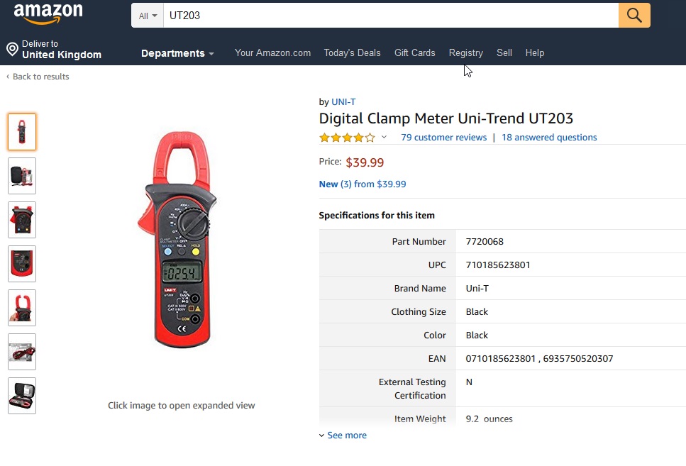

For this reason most techs use a DC current clamp (either a clamp meter or a separate clamp attached to multi-meter or oscilloscope ) or one of those old school clip meters as these are more reliable and non-invasive to the circuit.
As a DC clamp meter I use a Uni-T UT203 which is low cost and a decent general purpose multi-meter.

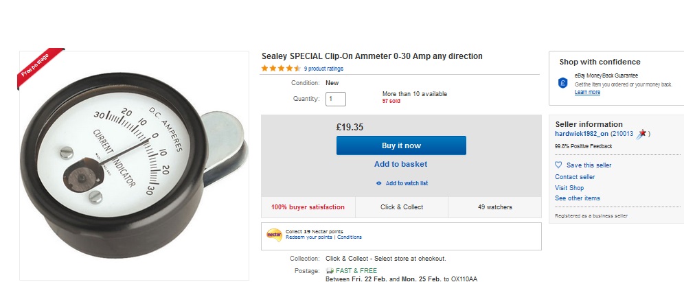

Clip on Ammeter less accurate but simple.
