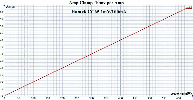

can someone help me figure out the amp clamp conversion 10mv/1amp what is the math?
