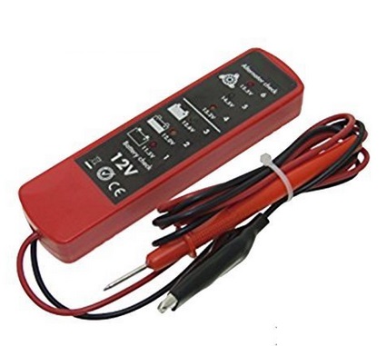

A few years ago I bought a fancy LED test light that tells you the polarity of what you are connected to red or green. -- but I haven't used it once.
Apart from a tungsten test light what I do use quite often for 12v power and also 5v reference is one of these which I picked up in an ALDI supermarket for about £4
