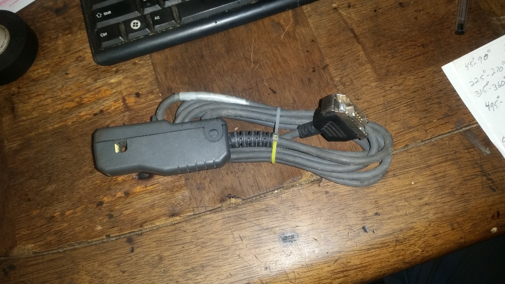

7 years 6 months ago - 7 years 6 months ago #29136 by Chad
overdrive138 wrote: im still looking for an external inductive rpm trigger probe, aes has them but its on backorder till jun
I have an extra. Make an offer. I would be happy to ship it out to you.

7 years 6 months ago #29144 by Chad
For Secondary Parade, you don't NEED to see the trigger. The first Ignition event is the trigger. The "trigger" just determines which Ignition event will be displayed first, in the parade, or raster. Then, Firing order is applied. As for "normal" triggering, beyond Ignition Parade, raster, etc., I can't say I have ever had a problem using it. I know I HAVE used it but, admittedly, not often (or recently), other than Ignition. I wonder if software version could be a factor, or a setting configuration, maybe.
As I said, I have an extra (more than 1, actually). I haven't used it in years, and probably won't. If you want it, I'll send it to you for $25, postage included.

7 years 2 months ago #32592 by tim.smith1
@chad you still have that pickup i dont have one and for 25 dollars it may be worth it lol
