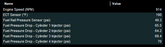

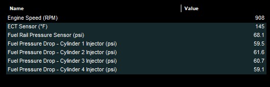

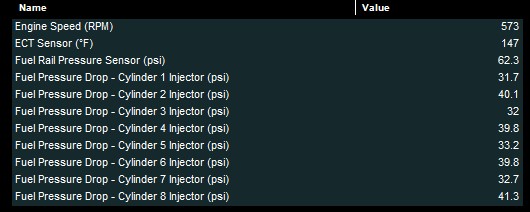

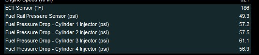

Going back over my data, hoping I missed something.
Problem vehicle before injector replacement:
Problem vehicle after injectors:
Known good vehicle:
7 years 5 months ago #29667 by Chad
Replied by Chad on topic P219A diagnostic techniques
I don't see it. The biggest spread is after the repair. :blink:
7 years 5 months ago #29679 by PDM
Replied by PDM on topic P219A diagnostic techniques
In the "known good" and "after", the Pressure Drop values are all numerically higher than Rail Pressure. In the "before", the Pressure Drop values are all numerically lower than Rail Pressure. If this is of any significance, also note that the numerical difference between Pressure Drop and Rail Pressure on the "after" (new injectors) is greater than on "known good" (used injectors)

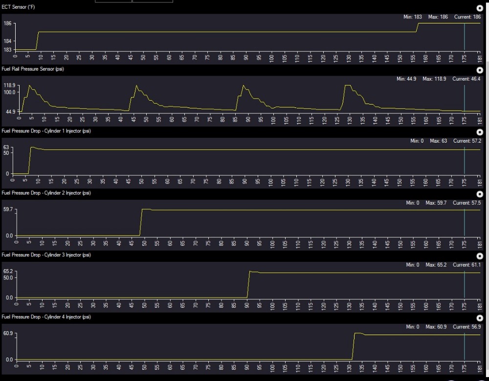

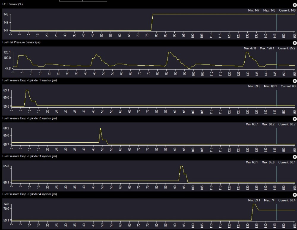

Sorry, the pictures that I posted don't represent the test very well. :blush: Here's the graphed data of the PIDs provided while the test is running. The PIDs you can look at while the test is running are fixed and cannot be changed (on the Snap-On, anyway).
www.scanshare.io/share/JsRrT38rsEuE9GUX1aaogw
Without having a scope on the injectors and the high pressure fuel pump solenoid, I can't say EXACTLY what the PCM is doing during this test.
7 years 5 months ago #29714 by PDM
Do you have a shot like that for "before"? You could probably see a sluggish injector with that

  • Tyler's Avatar Topic Author
7 years 5 months ago #29728 by Tyler
Replied by Tyler on topic P219A diagnostic techniques
Found it. This was taken before any repairs were performed.
Something I've noted about the way the Snappy runs this test - it keeps a history of the results of the last test, if you run the test multiple times per key cycle. You can see this in the graphs, especially injector #4. The previous test showed 59.4 PSI, but the latest test shows 68.4 PSI. The two tests were run seconds apart, so it's not like fuel temperature or engine conditions changed a lot in between. :dry:
I'm really tempted to pay for a GM subscription so I can compare the Snap-On to the GDS2, and maybe the Launch and Autel if I have time. Maybe this is a decent test? It just doesn't get implemented well by Snap-On.

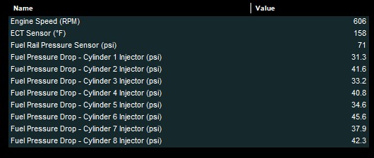

'15 Silverado 5.3L has a recurring P050D Cold Start Rough Idle. Has a mostly dead misfire on #3 for about 30 seconds. Smooth otherwise. Here's a before of the Automated waste-of-your-time Injector Test.
After pulling the intake once to clean intake valves and a lot of testing, I get the go ahead to replace #1 and #3 injectors. Here's the automated test afterwards:
What a useless test. :silly:

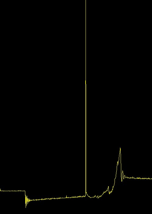

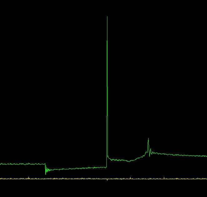

Side note, I'm very happy with the test I came up with to pin this one down. :cheer: Put the Pico TA204 secondary probe on the #3 plug wire, and put the AESWave Paddle Probe on the #2 plug wire (which never missed). During a cold start, engine missing away, I saw this on #2:
Textbook waveform. #3 showed this:
Lookin' lean. B) Secondary ignition FTW.
