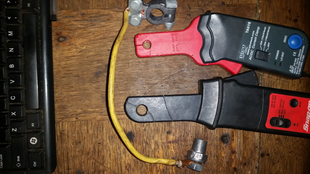

I have that same tool. (GypsyR has the box. :lol:) It is a good Current clamp. My only complaint about it is that the "clamp" part has a smaller diameter hole than the Snap On one does. For most things this doesn't matter, and some things, it's a plus. But doing relative compression on battery cable, might be a problem (not a big deal, But, I'll give Snap On a +1 for their larger hole.) Other than that, it should serve you well.

It's, really, not a big deal, though. For Relative compression, a voltage waveform will work just as well. You just need to remember that it will be UPSIDE DOWN, unless you INVERT it.
But for doing CURRENT DRAW testing, I made this yellow cable to combat that problem, if I need to.

That wire you made is a good idea!
