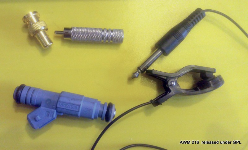

Ones of my ideas with the clip on acoustic guitar microphone was to clip it round the injector and look at the sound signature but it just didn't work , no signal nothing from the mike. I am now thinking if I added a 5$ pre-amp it might work.
EDIT
I found the guitar mikes this morning and tried again, something must have be wrong with the connection the last time as this time with the mike clipped to the injector body I got lots of signal but making sense of it is a different matter.
There is a visible difference with the injector disconnected but to be useful it would need synched to the ignition or an injector as there is a lot of echoes the other injectors.
Until I try synching it, adding a filter and getting that to work I can't see any advantage over using a stephoscope.
The idea of using a knock sensor might work better as it is designed to work on a narrower band of frequencies.

Guitar Microphone

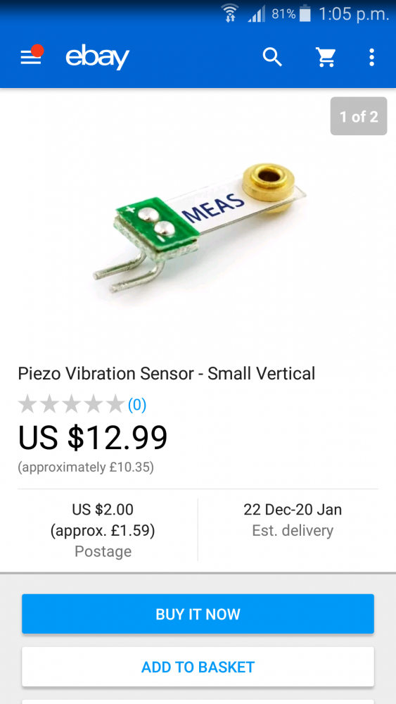

No eBay APP ID and/or Cert ID defined in Kunena configurationHi I have made quite a successful noise/vibration sensor if clipped on the engine it will actually pick up the each power stroke. I know this because if you use the pico to monitor it and use the cursor RPM function it matches the rev counter perfectly. Here is the link, Look at this on eBay

It won't let me post the ebay link?

For best results attach it to a crocodile clip permanently then clip it to a long screwdriver and move the tip of the screwdriver around to the areas where you think the problem is e.g alternator, power steering pump etc
9 years 10 months ago #4114 by Noah
Replied by Noah on topic Chassis ear/ NVH
Wow, cool stuff Richey, thank you.
With it attached to a screw driver, is it good to id a noisy pulley, or is it to sensitive for something like that?

I have only used it to identify a noisy pulley once and it seemed to work fine the only problem is the customer didn't have the money to pay for the job.So I never did the before and after process to see the end results but you will definitely be surprised on how accurate the little sensor is. This video is where I got the idea from
