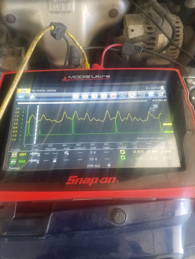

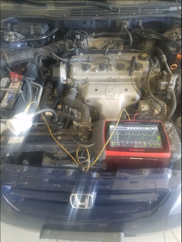

Had the chance to expand on this test Ro-longo first posted about. 2000-something Accord came in with an obviously blown head gasket. While I'm waiting, I connect the homebrew pressure pulse tester to the radiator and an ignition sync. Please excuse the poor photography. :blush:
If I'm looking at it right, three cylinders (#1, 2 and 3) are blown. :lol:
