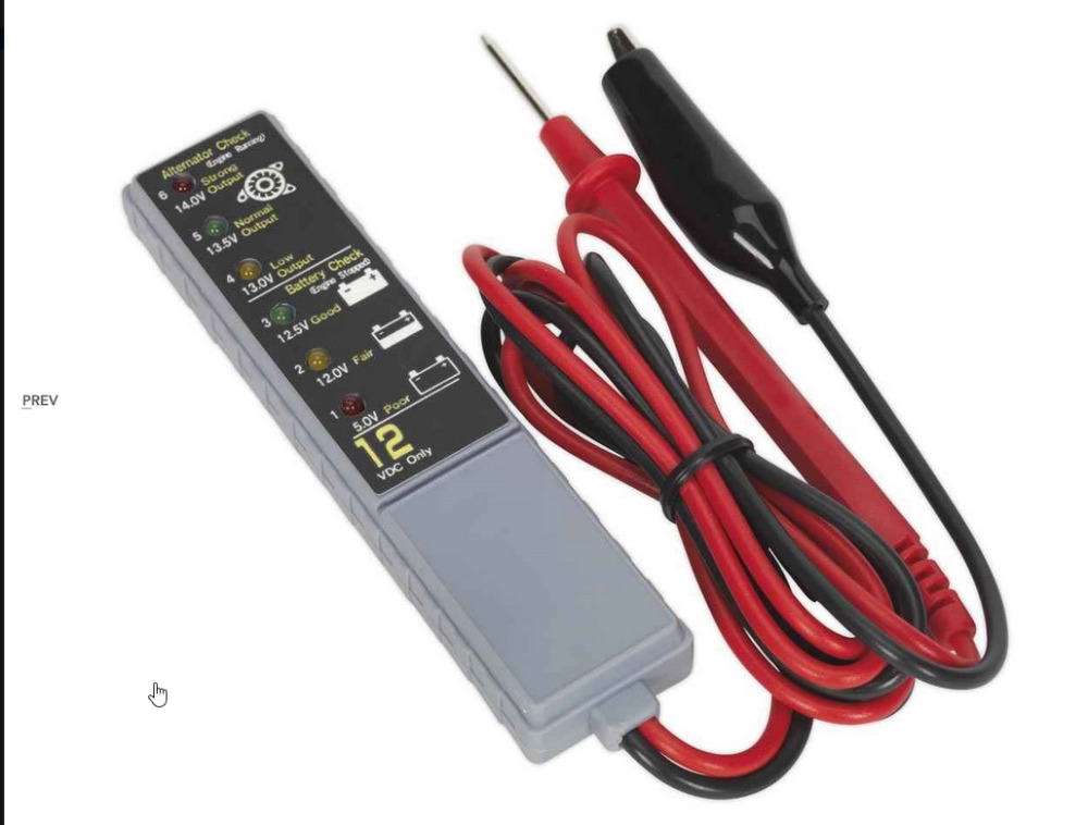

I have one of those LED test lights that tell you the polarity of what you are probing
I have never found a use for it.
When I want to use an LED test light I use one of those little LED votage probes sold as battery and altrnator testers. It cost about £4 / 5$ from my local Lidl Dicount Store
