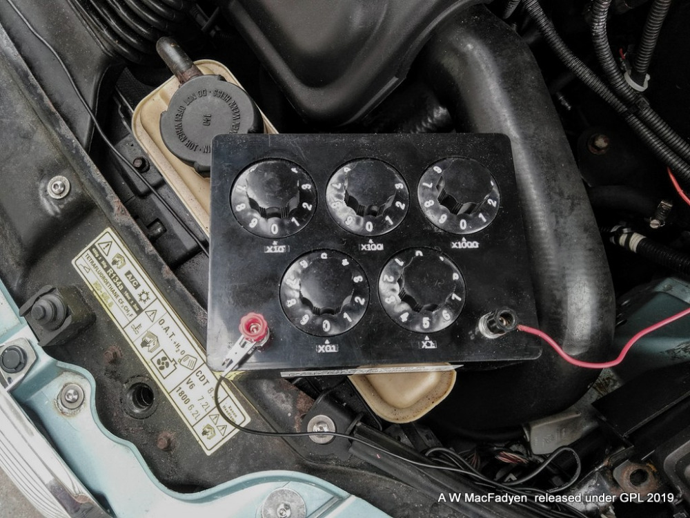

7 years 4 months ago - 7 years 4 months ago #30642
Replied by Andy.MacFadyen on topic Pcm memory saver
This really called for a test and it was quite easy to do on my own car as it has a battery master switch fitted. using my decade box out I tried various ressistance settings between 1 and 20 ohms across the master switch. During the test I opened and close the car door to allow for draw by the dome light and security system. I didn't check the ECU memory but if the radio kept its presets and the analogue clock still ran it scored a Pass.
It looks like a ressistance of 5 to 10 ohms connected in series between +B on the slave power pack and pin 16 of the OBD2 connector would limit the current but still keep the module memories alive and run the clock. As 6 ohm resistors are fairy easy to find on ebay 6 ohm would be my choice,
