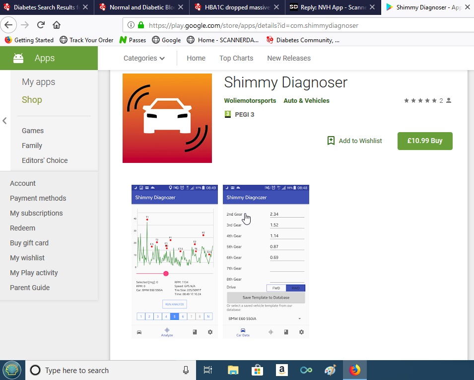

I was looking back over the the Bosch iNVH app to see if it had been improved when I found this

Andy.MacFadyen wrote: I was looking back over the the Bosch iNVH app to see if it had been improved when I found this
I'll have to check that one out and post a comparison. My guess is the price difference would be, mainly, justified by the EXTRAS that the NVH app has.
i.e. it has a data base of gear ratios that you can look up based on manufacturer RPO codes, and much more. I'm curious how much the "Shimmy Diagnoser" gives you.
I'll check it out and post back.

Chad wrote: I'm curious how much the "Shimmy Diagnoser" gives you.
I just installed the Shimmy Diagnoser. After opening the app, the first step is to enter gear ratios.....I don't know the gear ratios. :( You will NEED an outside information source, and have to look up, and enter, the gear ratios.
With the NVH App, you can select Year, Make, and Model and the gear ratios will be entered for you, on newer cars (15 years +/-, with more models to come).
For vehicles that are older, the app has a data base of RPO (Regular Production Option) codes and gear ratios.....the information is there and given to you, but you have to manually enter it into the app.
I'll post back, later, on a performance comparison.
