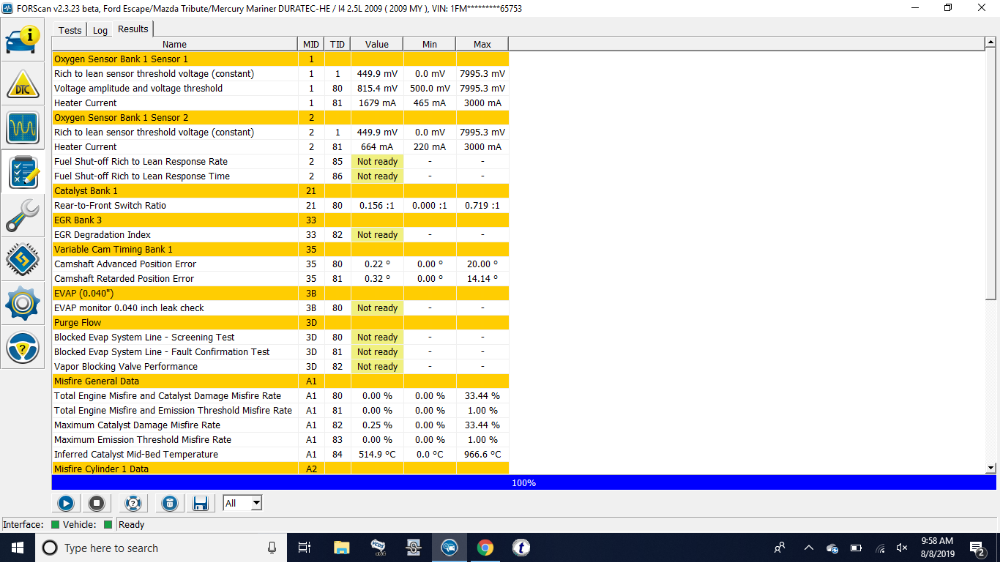

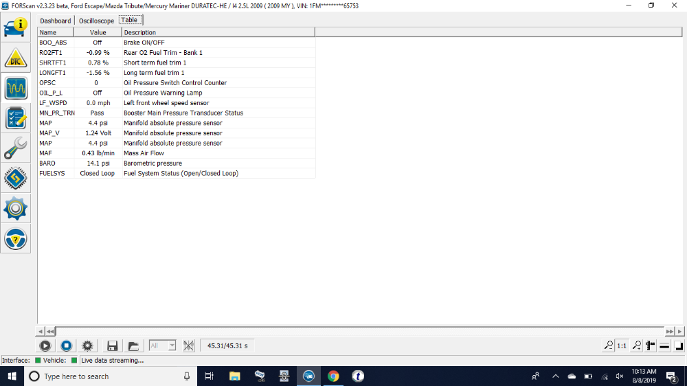

FORScan. Talk about value! :cheer: No other scanner I'm aware of provides this level of functionality for such a ridiculously low price.
forscan.org/home.html
What do you need? A Ford/Lincoln/Mercury/Mazda, a laptop, and an ELM327 adapter. I got mine from Amazon for $20 . There are better and more capable adapters out there, but something this cheap/simple will get you started. Hardware requirements are low, so just about any Windows laptop will do.
It'll pull codes, sure. But FORScan really shines in the more advanced features. Like scan data - not only does it provide live data, it'll allow you to observe data from multiple modules simultaneously. Provided they're on the same network, anyway. The example below is watching data from the ABS, IPC, PCM and Global OBD all at the same time. :woohoo: No other aftermarket scanner I've used allows this.
The PID search function is even better. Say you wanna look at fuel trims? Just type in 'trim' and you get the short list of relevant PIDs:
Mode $06 data is fast an accurate. The MID's and TID's are translated into English and arranged in a comprehensible way. Snap-On users will appreciate this. :lol:
Now here's the really cool part - module resets and programming. It won't do updated calibration, but it can do as-built configurations on many modules. Here's an example of looking at some ABS as-built data:
It'll also do KOEO/KOER Self Tests, as well as ABS bleeding and KAM resets. Just about everything you'll need to fix your Ford/Lincoln/Mercury/Mazda.
The truly upsetting part is all the stuff it'll do, but my Snap-On at 17.4 won't. Like spark duration PIDs, and Power Steering Control Module resets. I've checked - they're not there on the Snappy. Why did I pay for those updates? :angry:
So what does it cost? Besides the laptop and the ELM327 adapter, a FORScan Extended License (which gets you all the cool features) costs... $10/year. Less if you buy multiple years. Plus, they offer a two month free trial to get you started.

6 years 8 months ago - 6 years 8 months ago #33475 by Tyler
Replied by Tyler on topic Scantool Reviews
The local Mac Tools guy let me demo his new MDT10, which is a redressed version of the Bosch ADS 625:
www.mactools.com/en-us/Diagnostics-and-T...200/MDT-10-Scan-Tool
I've been very excited to get a hold of one of these since they came out. Thoughts so far:
Pros:
- It fills in the gaps of the Snappy coverage, just like I wanted it to. On my '08 Ford Escape, the Bosch offers a BIG list of bidirectional functions that are nowhere to be found on the Modis. Generator voltage command, EVAP purge/seal, commanded air/fuel ratio, SAS relearn. More data PIDs are there, too, like rear fuel trim and spark duration.
- Enhanced OBD/Global OBD functionality is fantastic. Every Mode $06 MID and TID I've looked at is (pretty) accurately decoded.
- Battery life is surprisingly good. I've kept it running for several hours at a time with no need to recharge. Of course, it's brand new, so who knows how that'll play out over the life of the tool.
- The Automated System Test is a nice function for record keeping purposes. Hit one button, and the tool automatically scans all modules for codes, grabs the VIN, current PCM calibration, checks emissions monitors and all Mode $05/$06 data. All saved data is listed by date and vehicle in an easy to use menu.

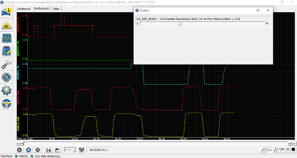

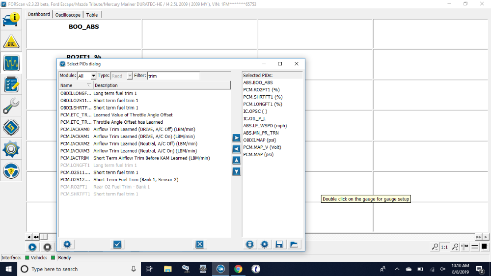

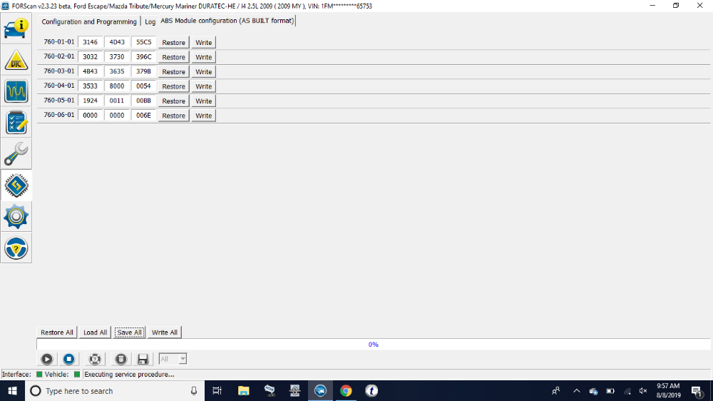

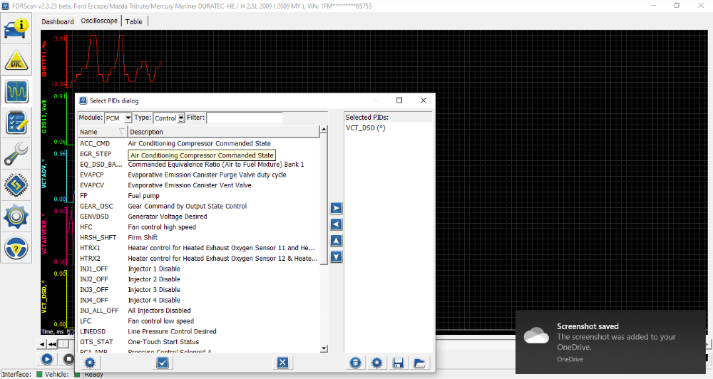

6 years 8 months ago - 6 years 8 months ago #33688 by Tyler

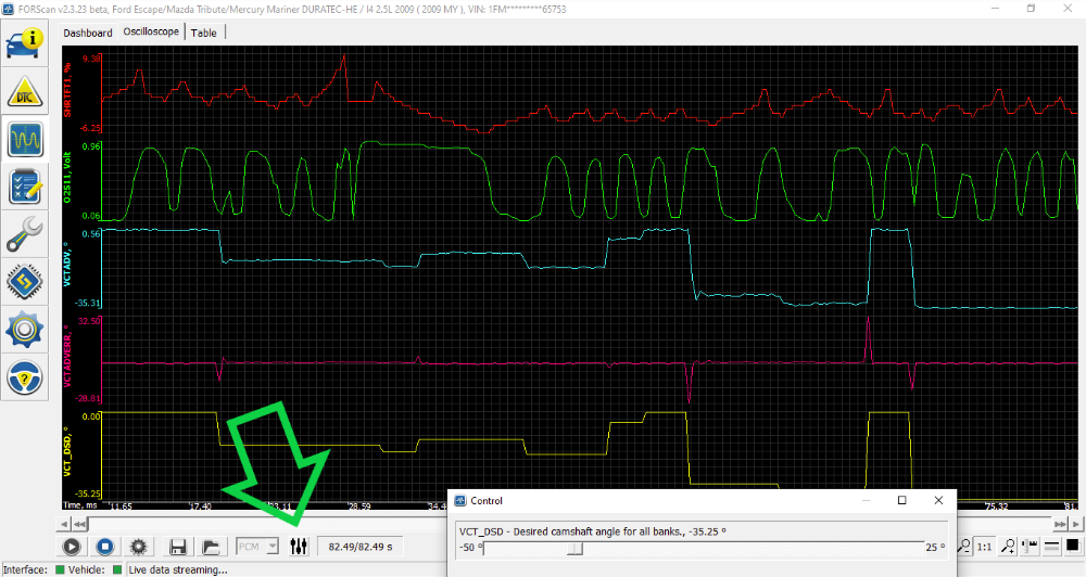

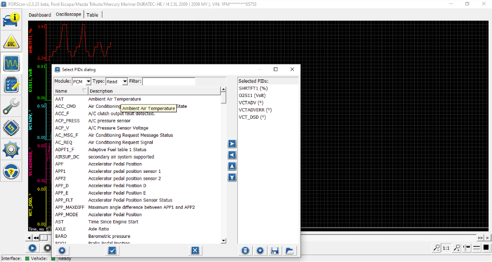

Finally got the bidirectional control to work. :lol: Donut, you were right on with the 'Control' button. I never would have gotten there without your suggestion.
For everyone else, the button we're talking about is this one:
But before you click it, you have to first load up the data PID's you want to watch, AND which controls you want to use. I went with the VCT system as an example because the commands will reflect in the data nicely.
Choosing the data to watch:
Then picking out the output control:
Then hit Play at the lower left, then Control, and you get the menu to run the outputs. :cheer: The first picture shows the VCT control working perfectly.
There's other fun stuff, too, like the Commanded Equivalnce Ratio function. This gives you direct control of the air/fuel ratio, much like the Toyota and Nissan functional tests. I have a Modis Ultra at 19.4 - this test is nowhere on it.
Only had a couple minutes but while I was able to find the menu, couldn't get any outputs to actually work. The Forscan forums say the module needs to be put into a diagnostic mode in order to use output commands, which is news to me and am unsure if the Forscan software does that automatically when an output command is sent.
From my experience, I think this has more to do with the test you're choosing and when you try to run it? For giggles I tried the All Injectors Disabled test for relative compression purposes. It works, but only if you start the test KOEO. :silly: If you try it with the engine running, nothing happens.
There's other limitations that I found while playing around. With the VCT command, if I had the slider at -13 degrees (which is possible for this engine) and moved it to +25 degrees (which is impossible on this engine), the test quit and just went back to open loop.
