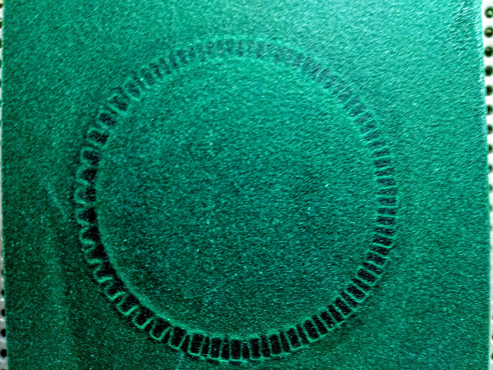

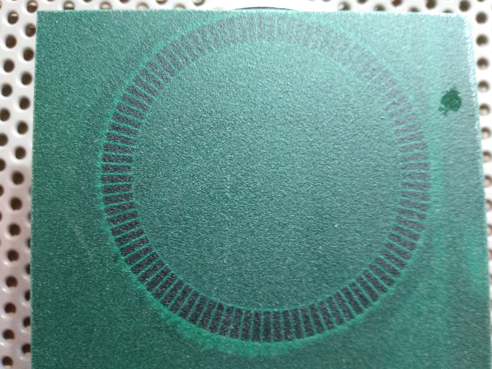

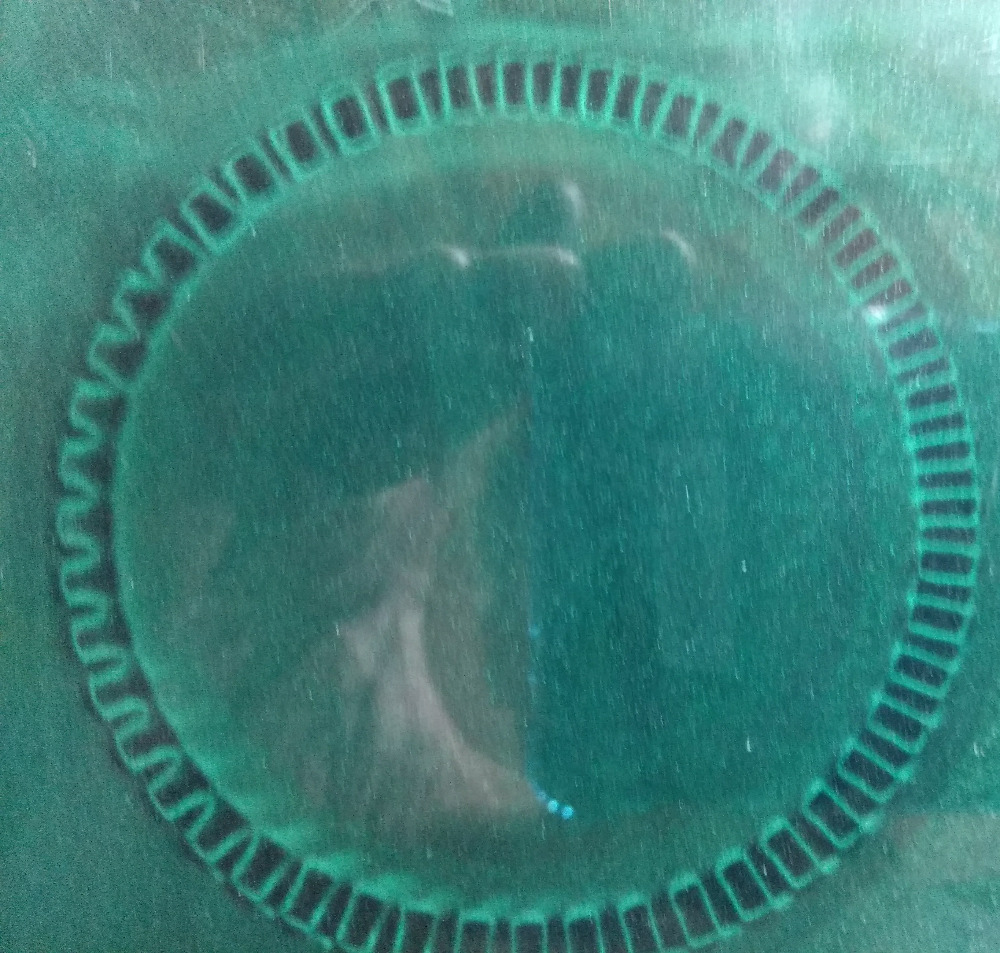

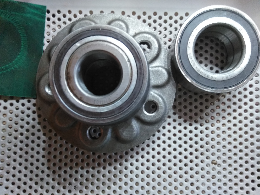

Another tool in the ABS armoury was created by Andy.MacFadyen
Magnetic field viewing film allows the tech to see magnetic field when held aganst an active wheel bearing to spot missing magnetic poles
