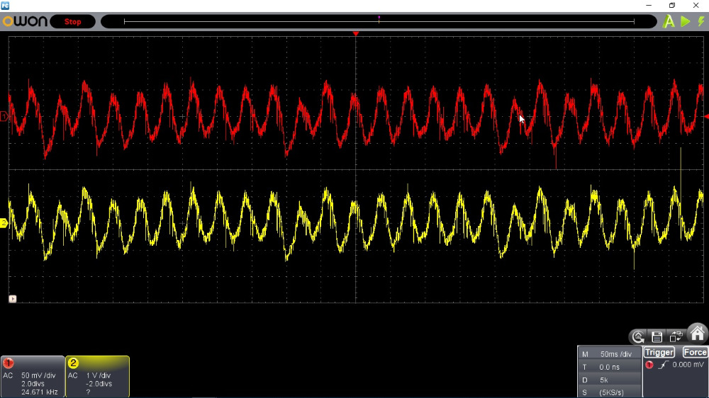

Some times a result can be a surprise --- the simplest test was alternator ripple I used the cheap and cheerful Owon VDS1022I
I offer no explanation but they are identical --- might be different with a fast 12 bit Pico
Channel 1 Red with x20 Attenuator
Channel 2 Yellow plain jane 1:1 test lead

This forum never ceases to amaze me. Thank you guys for the information and support. I never heard of owon before. I bought a u-scope to start out with and I've been looking at the hantek, but this owon looks like it might be a good starter scope as well. I noticed the max voltage on the owon is 400 volts. How exactly does the ratio work for an attenuator? A 20:1 will protect your device at 20 times the amount of rated voltage? So max input voltage is 400...with a 20:1 attenuator you're protected up to 8,000 volts (400×20)?
