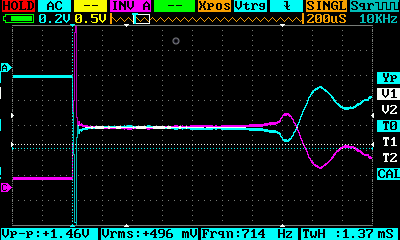

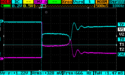

I'm just getting started with teaching myself about ignition waveforms as a DIYer. I have a DS213 minidso scope and a Hantek HT25 secondary ignition sensor. This sensor is said to have a 10000:1 attentuation where the AESwave sensor is 1000:1. A review for the HT25 on Amazon suggested changing the capacitor in the sensor to adjust it to 1000:1 or 5000:1. I bought the HT25 because it was 1/3 the price and figured I'd give it a shot.
I was testing it on a lawn tractor this afternoon and was able to detect a waveform with the motor running. I'm assuming a lawn tractor makes the spark in the same or similar way a vehicle does? (If this is not a correct assumption, I will test it on a vehicle next.)
The waveform that was seen doesn't really look like what I've read it should look like. I realize the signal will be inverted on the scope. This scope has an Invert function for Channel 3 where it can be setup to display CH3 as the inverted waveform of either CH1 or CH2 (the analog channels.) However, using CH3 complicates setup so I didn't use it for this test.

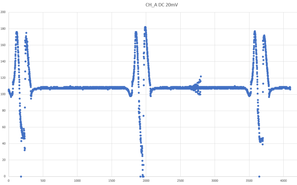

Here's a waveform made by the exported CSV data from the DS213 scope. The first two peaks on the left are at 171 according to the CSV file. The minimum is around 50. The channel A was set to DC 20mV according to the datafile with a timebase of 500uS. I'm pretty sure the 20mV is mV/Div. (Learning the new scope too. I've used bench scopes in school and at work; I'm getting used to how this scope handles things.)
As an example of how this scope uses CH3 to invert the signal, I saved a BMP image. This was a capture during the testing on the lawn tractor, though it doesn't look like what I've read the waveforms should look like. Note, it's set for 50mV/Div with a 1mS timebase.
From reading about this online and through the Premium course, the time period that the spark is jumping the gap (for a car anyway) is 2-3mS, so I figured a 1mS timebase might be appropriate. Maybe it should have been set for longer? The 50mV/Div seemed to show the whole waveform, but I didn't see any really large peaks like I'd expect.
Could the 10000:1 attenuation be the problem here using it with the DS213? The DS213 is the upgraded version of the DS203. Similar to the uScope but two channel and 2 digital inputs. I really wanted a 2 input scope so I could learn how to correlate signals. There is a known bug I read about after purchasing that they're working on fixing but it's not fixed in the F/W yet. Something to do with triggering... minidso.com/forum.php?mod=viewthread&tid=3748&extra=page%3D1 and minidso.com/forum.php?mod=viewthread&tid=3339&extra=page%3D1
Maybe this bug isn't the issue. Maybe it's the sensor? Or a lawn tractor engine works differently than a car engine with the coils? This is a nifty scope for the price and it's pocket-portable. I'd like to try out a Picoscope and be able to scroll through the waveform capture and use the automotive preset features in their software, but the scope's a bit pricey for me experimenting at home, and I'd have to buy a laptop. (I'm still a desktop-holdout user!)

Your lawn tractor will have a flywheel magneto ignition system the secondary voltage pattern will look very different from a conventional coil and battery system.
The general shape of the oscilloscope trace is similar to what I have seen from Briggs & Stratton lawnmower engines.
However you are pushing your oscilloscope beyond the limits of what it is best suited to do , you can see it is missing rapid changes in voltage.
I would leave the internals of the HT-25 be a car or even a lawnmore ignition can generate 50kv --- devided by 10,000 that gives 5v which is ideal for any oscillscope to show on a 10v screen

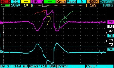

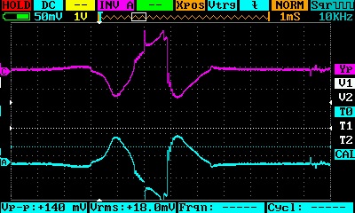

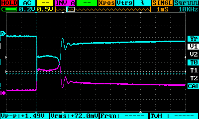

Thanks! I was under the (wrong) assumption that the waveform for the spark in a lawn mower would be the same as that in a vehicle. Good to know it looks similar to what you've seen. This is a Kawasaki 2-cyl engine. I'll have to look into how these magneto ignition systems work.
What do you mean by it's pushing the scope beyond its limits? Where is the rapidly changing voltage that it's missing? Do you mean the small blip near the 2750 time mark in the Excel plot, or is there something I should look for in the scope's image? The waveform was bouncing around a lot when I took that image file. I tried adjusting the trigger to smooth it out a bit and it steadied the trace some but every now and then it would change a lot from what it was.
In the edited image above:
Are these the reasons why the scope is being pushed to its limit? e.g. It's not capturing everything? The scope generates a MHz square wave that it seems to be able to pick up. Maybe I'll bring it to work and test it with a function generator that is known to be accurate.
I thought this DS213 was supposedly faster than the version the uScope uses (DS201). I was assuming that if the uScope can see it, this one could; just that this scope wouldn't have the built-in presets and conversions. Maybe I made the wrong choice in choosing the DS213 mini dso... I really wanted two channels.
If the lawn mower (or car) can generate a 50kV signal, maybe I was looking at the wrong part of the waveform since I had it set to 20 or 50 mV/Div. I seem to only be seeing a ~150mV change in the signal. I initially thought I should have it set to 1V/Div based on the 10000:1 ratio and that the actual voltage could be 30-50kV, but I didn't see anything on the scope when it was set to 1V/Div. Maybe I had something else not quite set right. I'll try it again when I get a chance this week.
I'll try the scope on my car to see if that makes a difference. I've found waveform examples for cars but not mowers, so maybe I'm looking for the wrong thing with the mower. The mower was just easier to start and play with at the time. I'll try my car to see if I can see what I've been reading about.

The low end chinese scope manufacturers always greatly over claim the performance of the scopes they make devide it by at least 4 and then devide it by the number of channels. If you look at the CSV data plot you will see huge gaps where the scope just can't keep up with rapid changes in voltage.
Flywheel magnetos are very different from the classic automotive kettering coil and battery system.

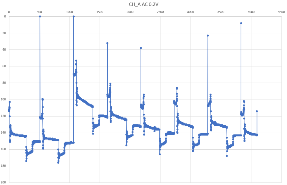

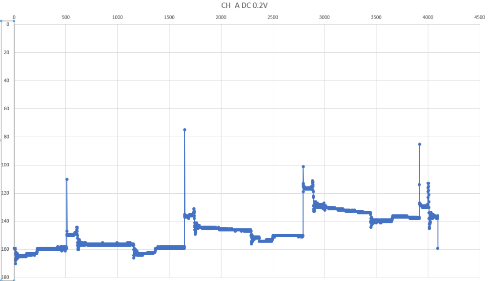

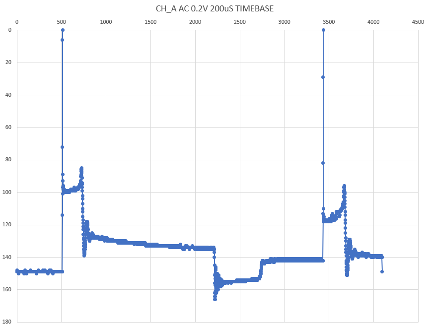

I had time to take a look at a vehicle Friday evening. 8-cyl 5.8L Windsor. The waveforms look like what I've been reading about when measured on the spark cable from the coil to the distributor, though the voltage spikes at the firing line aren't as high as I would have thought. (Maybe this scope just isn't picking up the highest value like mentioned previously?) Also, I tried measuring waveforms on the plug wires that go between the distributor and each spark plug, but the waveforms didn't look like the ones below. I forgot to take a capture of those, but the waveforms were all over the place. I was only able to get a recognizable waveform by measuring the wire between the coil and the distributor...
The voltage signal only changes by .7V on the 0.2V/Div scale in one image at 1mS timebase.
I believe this is the associated waveform data.
I captured another at 500uS timebase, 0.2V/Div
Here's the waveform data with the same timebase and volt Div settings:
This one was a fast timebase of 200uS. Looks like the spark time lasts for about 1.4mS (7 Divs @ 200uS/Div). 1.5mS seems reasonable? Again, I tried increasing the Volt/Div, but the scope wasn't detecting a large voltage spike, so the triggering didn't work very well when set at say 1V/Div.
This 200uS timebase didn't show well on the screen, but the data plot seems to show one spark event pretty well. There's 4096 data points in each waveform datafile that was plotted in Excel. I've been reading more about bench scopes and many say they have 12-24 Mpts Memory depth. This 4096 looks like this is the "memory depth". One website says the DS213 has a 4k memory depth. With more memory depth, like 24 Million points offered in bench scopes, I gather I could measure at 200uS timebase and capture more spark events in the buffer.
