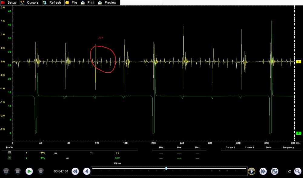

9 years 10 months ago - 9 years 10 months ago #4445 by Tyler
I originally heard this concept from a co-worker who attended a local scope testing class and heard it from the instructor there. Not my idea, no credit to me ;) I just decided it was a great concept, and decided to run with it. This, and several other great ideas came up in a recent thread about the Pico NVH kit , is definitely worth checking out if you’re into off-label use of tools and equipment. Yes, Snap-On man, a screwdriver IS a chisel :P
Anyway, the concept kinda makes sense. We can definitely hear injectors working with a screwdriver and our ears, why wouldn’t a knock sensor work? Coupled with a lab scope, we might be able to distinguish individual injector firings... Right? Let's find out.

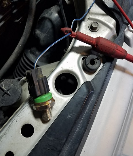

Kudos to Noah for hooking me up with a variety of knock sensors for this experiment. He sent the sensors AND the pigtails? What a boss! B) Out of the selection he sent, I ended up using this (Honda?) sensor:
It seemed to provide the cleanest signal, and its male threaded end made for easier testing. I did try some Nissan and Ford sensors, but neither seemed to produce similar results. YMMV. In all captures, the sensor is being held to the middle of the fuel rail, as touching it to the ends didn’t seem to make any difference to the waveform. FYI, the test subject is an ‘04 Scion xA.
"Hey, Tyler, don't you have to ground the knock sensor?" That's what I thought, but apparently not :dry: I experimented with grounding the sensor, but saw no difference. *shrugs* Onto the waveforms!

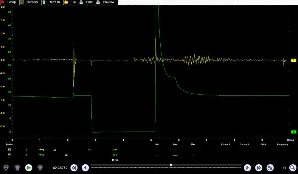

The scope settings took some tweaking to get a usable picture, but this is what I ended up with. Yellow is the knock sensor, green is the #1 injector trace. Note that the vertical spikes are NOT the injector events, but actually ignition feedback. It's confusing because this engine has a COP ignition system AND fires the injectors not long after TDC compression. Unfortunately, I couldn’t find a way to get those spikes out of the picture without losing the injector events :( I marked the capture for clarity.

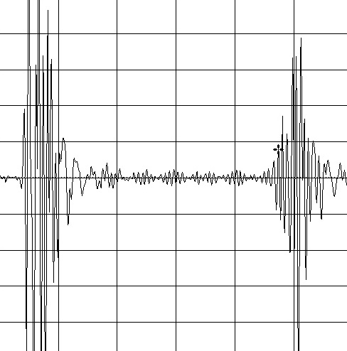

A zoomed in view on one injector event showed some cool detail:
It looks like the majority of the vibration generated by the injector comes from the injector pintle slamming home after the voltage pintle hump. I figure this is what you’re actually ‘hearing’ when you listen to an injector with a screwdriver.

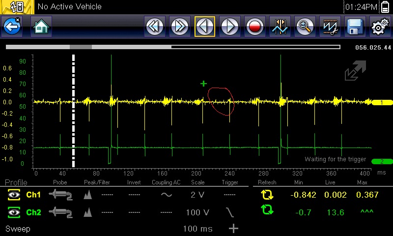

So, can we see an inoperative injector with this setup? Let’s find out! I unplugged one injector:
It’s not much, but you can see a missing vibration three events away from the #1 injector firing. Since the firing order is 1-3-4-2, we can deduce that the #4 injector isn’t working. It works! :woohoo:
But what are the variables? I have to assume rail design is a factor, especially on V6 and V8 engines. Would this work well on a 5.3L with a solid pipe joining both rails? Or, would I need to do two separate captures? Vortec spider systems? More experimentation is needed.
Of course, this isn’t a pinpoint test either. It’ll show an inoperative injector but not why. It won’t show a flow or spray pattern problem. Plus, knowing how to read the waveform is key. Not all engines will look this way, and having a good idea of what it’s supposed to look like is important. The time necessary to get good at this may not pay off for everyone.
Thoughts? Comments? Questions? Hate? Post it up!

9 years 10 months ago #4454 by Noah
Thats pretty cool, I've never seen anyone do that before. I imagine there's all kinds of variables, like you said, with rail construction and injector placement.
A little hard to "read" the waveform, but there is a clear difference between a working and non working injector.
Do you think using a/c coupling would provide more definition?
Glad you're getting use out of them! I believe that one is from a Civic, good eye!

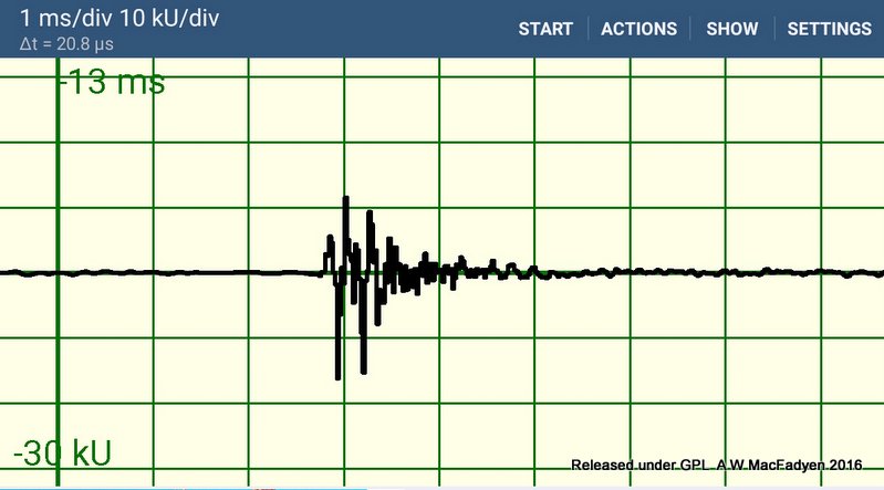

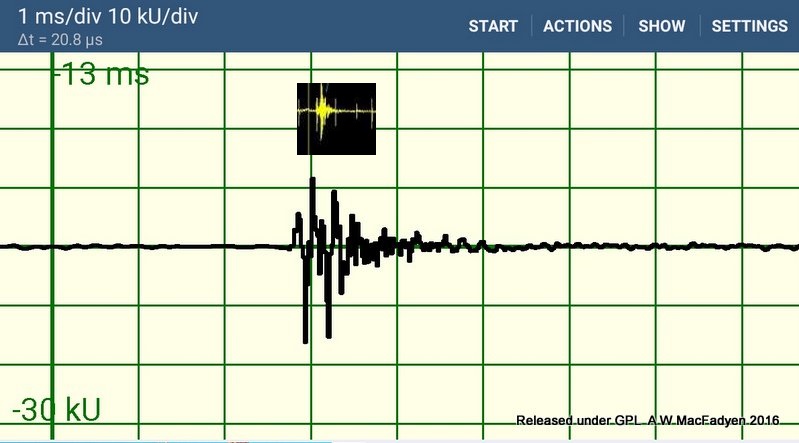

9 years 10 months ago - 9 years 10 months ago #4526 by Andy.MacFadyen
Replied by Andy.MacFadyen on topic Testing fuel injectors with a knock sensor
Some good ideas in this thread, I am still puzzled that my trial clipping a contact microphone to an injector produced nothing. I don't have any knock sensors or microphones to hand so working off car I improvised and used cell phone running an audio app and Bosch pencil injector pulsed by an injector tester.
The waveform is very similar Tylers result with the Honda knock sensor on the fuel rail.

Andy.MacFadyen wrote: Some good ideas in this thread, I am still puzzled that my trial clipping a contact microphone to an injector produced nothing. I don't have any knock sensors or microphones to hand so working off car I improvised and used cell phone running an audio app and Bosch pencil injector pulsed by an injector tester.
Holy crap, Andy :ohmy: That's awesome! What phone app did you use for this? Please tell me it's for Android ;)

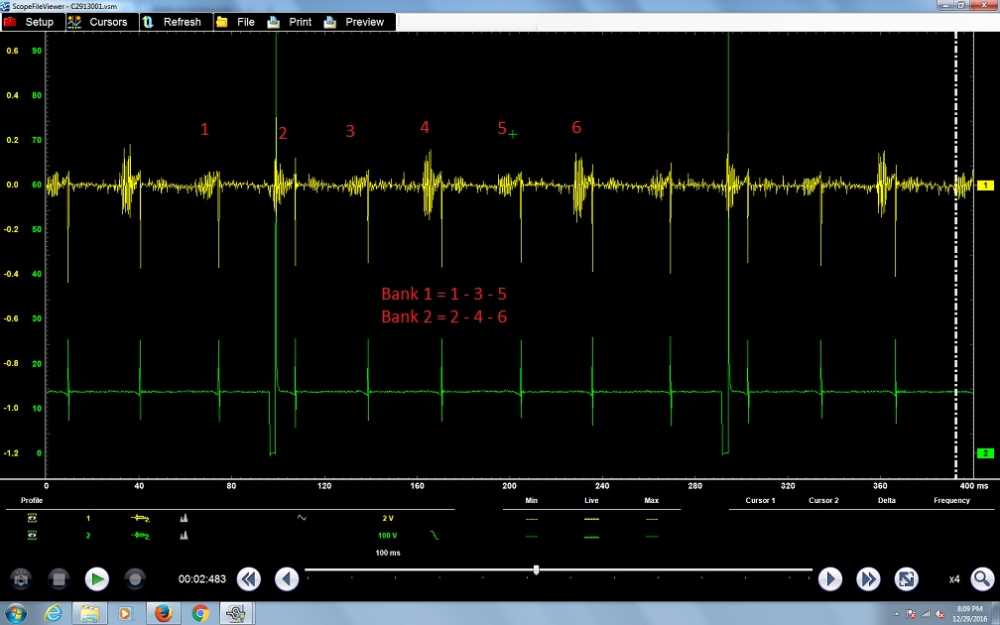

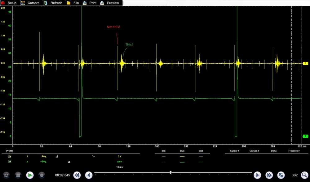

Finally got time to play with a V6 today, pretty happy with how the waveform turned out. B) This is a 3.3L in a Toyota Sienna, triggered off the #2 injector. Firing order 1-2-3-4-5-6.
I also noticed a difference in the amplitude of the injector "events" between banks. I marked up this capture with all injectors firing:
The knock sensor was attached to bank 2 fuel rail, thus the stronger injector vibrations. These rails are joined by a metal fuel pipe, with banjo bolts on both ends, so clearly there's enough rigidity there to carry vibrations from the other rail :)

9 years 10 months ago #4548 by Dylan
Replied by Dylan on topic Testing fuel injectors with a knock sensor
Cool Tyler! So what did you do in the first capture? Nothing on cilinder 6....

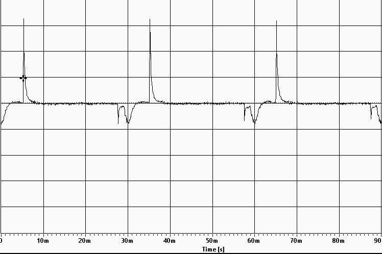

I am now 100% convinced this is a useful technique with some free time on my hands yesterday I set up on the kitchen table with an injection pulse tester and my scope.
The first thing I tried was using the
little moving coil speakers from a set of headphones (from Poundland) as microphones plugged into a the microphone input of USB soundard and looked at with a nice PC Soundcard Oscilloscope program Link to program home page.
The result is a good capture but not what I expected fom Tyler's and my own previous experiments.
In any event it would not be a practical method on a running engine.

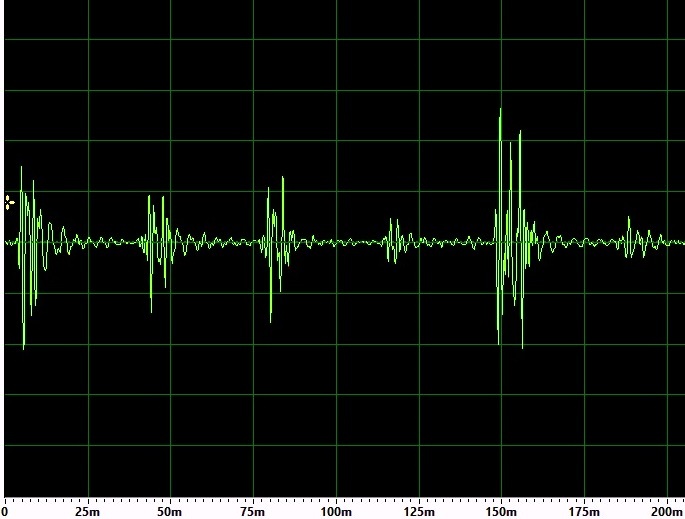

At this point it occurred to me that a sonic reversing sensor might work --- and it did :-) I had a parts of a cheap and nasty aftermarket kit that used 2 wire sensors in the shed so still using the sound card as an oscilloscope I got this on a bench test
9 years 10 months ago #4566 by Andy.MacFadyen
Continued
Next stage test on running engine.
Still using soundcard oscilloscope.
  • Tyler's Avatar Topic Author
9 years 10 months ago #4574 by Tyler
Replied by Tyler on topic Testing fuel injectors with a knock sensor
Dylan wrote: Cool Tyler! So what did you do in the first capture? Nothing on cilinder 6....
Yep, that's the injector I unplugged! B) I'm super glad these waveforms are making sense to others :lol:

Man, that's a clean capture. :ohmy: It looks like you can still see the rail resonating after an individual injector event. Was this a four cylinder engine? What kind of ignition design?
The biggest problem with the knock sensor method is the EM noise. The scope has to be set up to 'see' the injector vibrations, but it also picks up just about anything else at that level of sensitivity. Wondering if a different scope or knock sensor might help with that... Your reversing sensor really seems to produce less noise overall.

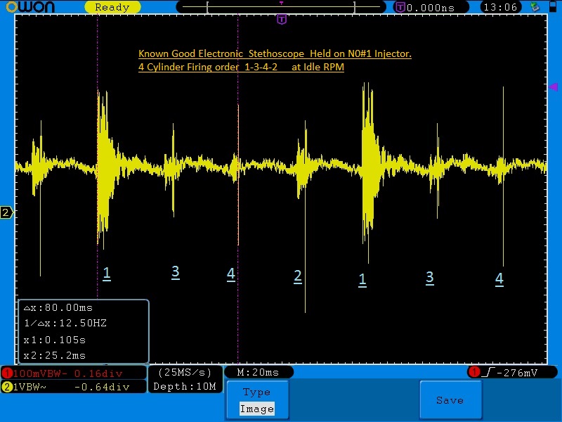

9 years 10 months ago - 9 years 10 months ago #4580 by Andy.MacFadyen
I had problems getting consistant results using the reverse sensor, although I was getting better results with the PC soundcard than the Scope, then it had occurred to me we are trying to reinvent the wheel. Amazon Prime same day free delivery came to the rescue. Total cost less than £20 --- 30$
Gunson Electronic Stethoscope
No time to test it properly but it looks like it is the answer, using a PC speaker cable it plugs straight into the PC microphone input and it gives a good signal voltage for the scope.
