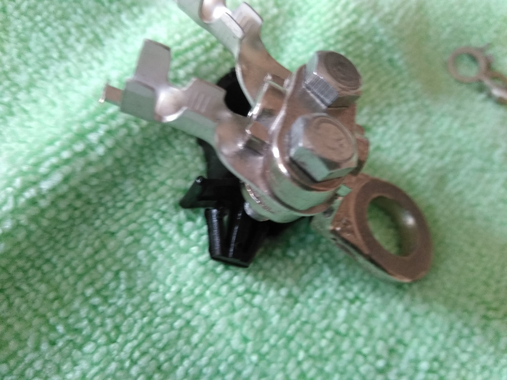

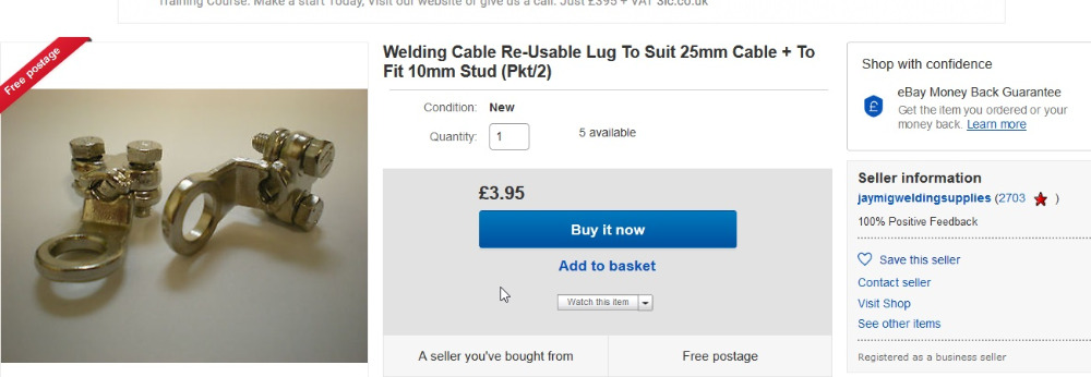

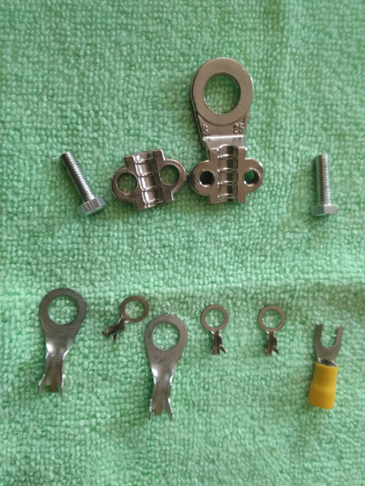

Watching the latest SD YouTube Video on bad ground on a (surprise) a Chrysler I thought I would show minimum hassle way of creating a good ground point to the chassis or engine block for multiple light duty wires using a re-usable cable lug for MIG welding cable.
The welding lug has a 10mm hole that will fit a lot of bolts on the chassis or engine block you can then use the small 5mm bolts on the lug to provide multiple ground points for smaller gauge wires
