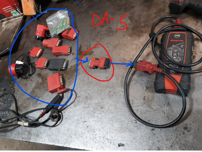

I am planning to buy a versus pro today. It has 19.4 with the software for domestic, Asian and European. It has the Bluetooth and a/c cable, but I bileive that’s all. I see kits with connectors w/keys separately for Asian and European. Are those needed, as I’m new to the newer equipment. Also, I have an old snap on mt2500 with cartridges to 2000 year with all the connectors and keys for domestic and Asian (obd1/2). Are any of these necessary or useable on the versus pro since it has the Bluetooth connector and says coverage goes back to the 1980’s. However I don’t see how it could without any connectors. I am assumiming the Bluetooth connector is for obd2. This is on eBay which is why I am going based on what I see. Thanks for any help. It’s Saturday 11/2 today

To connect to Pre-OBD-II vehicles, you will need the older connector AND adapter DA-5 to connect them to the bluetooth module.

Replied by Chad on topic Re: versus pro w/19.4.
You will not need the "keys" with OBD-II vehicles. The first generation Verus required them, but the Pro version, with the bluetooth adapter does not require them.
