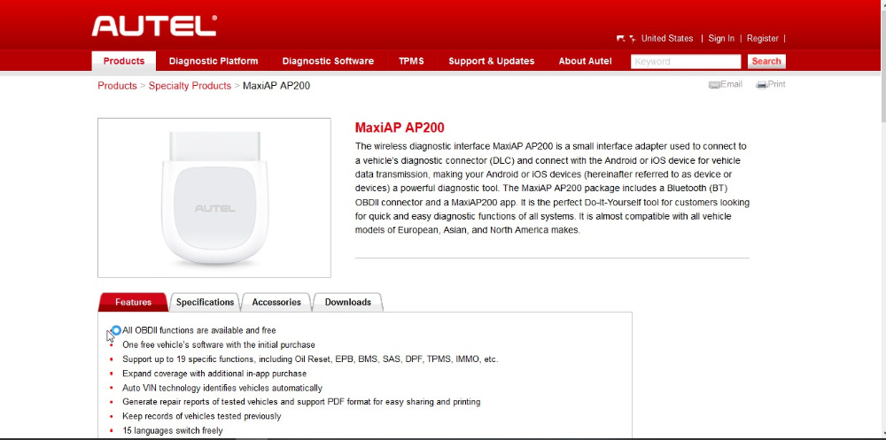

I just ordered an Autel AP200 as a gift for my son-in-law, he only has Nissan anf Toyota as hobby cars so it might work well for him. I will report back once I get some feed back

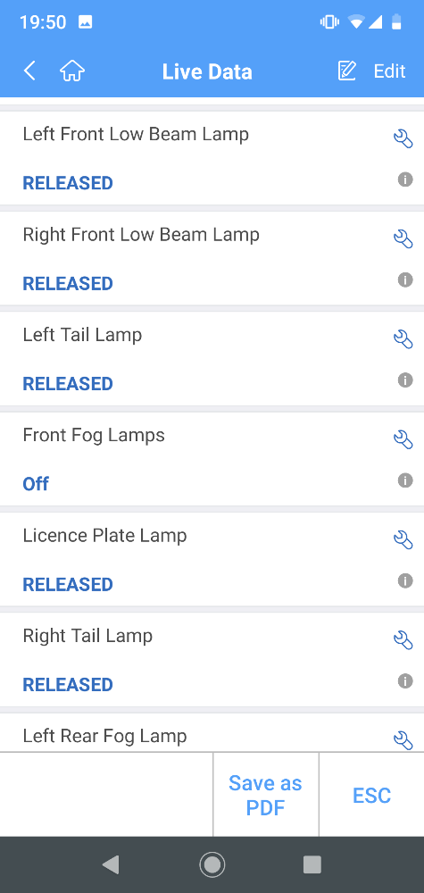

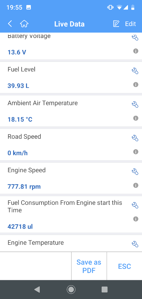

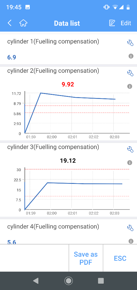

I have now had a loan of this bluetooth dongle tool and using it linked to an Android 9 phone to do a limited evaluation on two vehicles, on live engine data engine it provides almost identical pids to Launch X431 on the Diagun.
It has a good range of special functions EPB, DPF, ABS Bleed, service reset ...... but at least on the vehicles I tried it on lack bi-directional tests I couldn't for example test the cooling fan operation on a Freelander I TD4, this may however be better on more mainstream manufacturers vehicles. I did find it quite slow in in use but that seems to be a general Autel issue
The way the dongle and modular software is sold is the dongle including one manuafacture plus OBD2/EOBD is included in the price arounf £60 in the UK to this can be added additional manufacturers at £15 UK per year. Note only the additional manufacturers need yearly renewal.
If you have a family fleet from only one or two manufacturers to diagnose & maintain this tool could be a very attractive buy.
