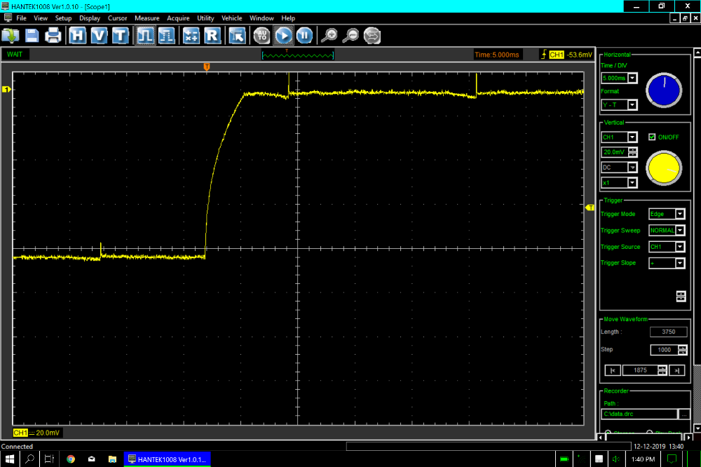

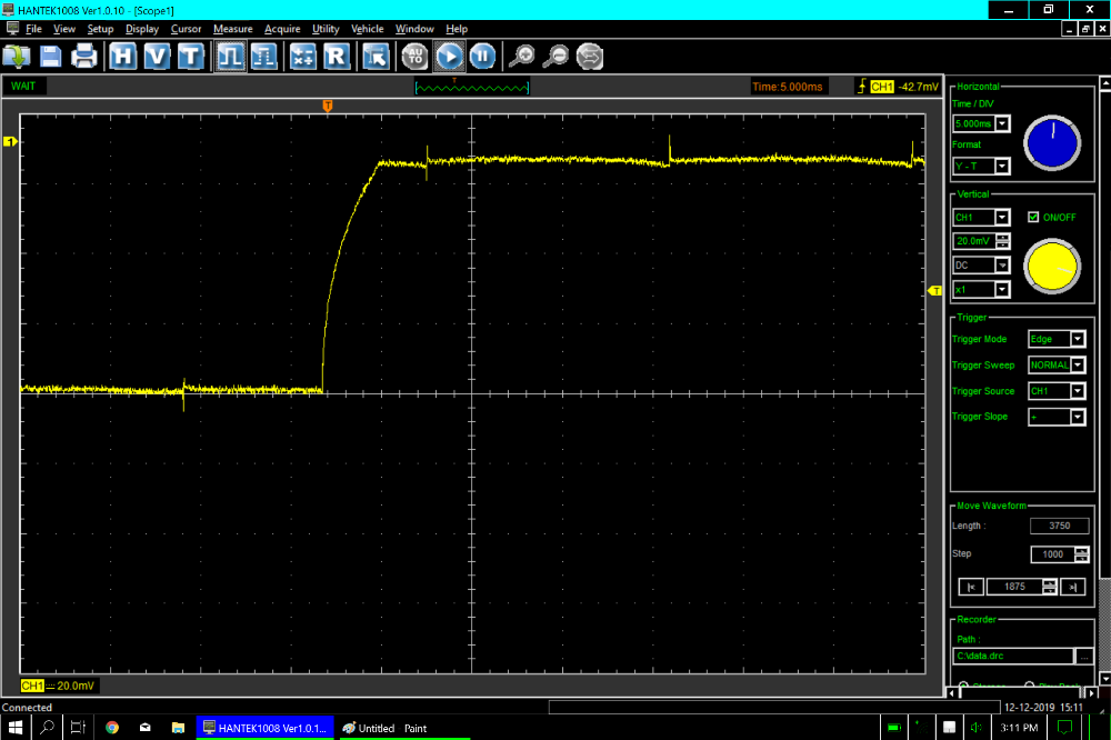

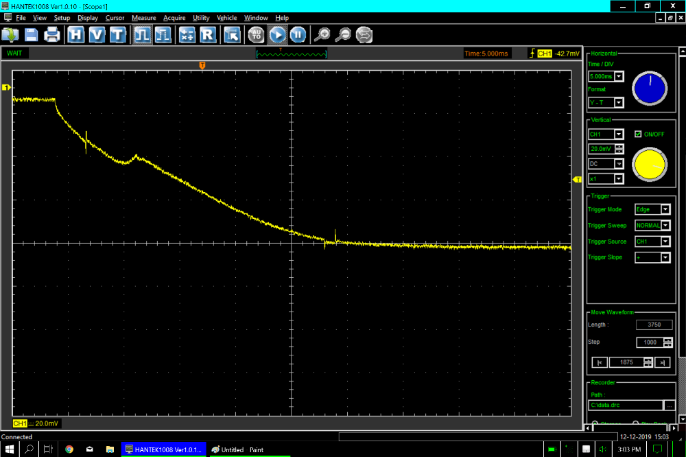

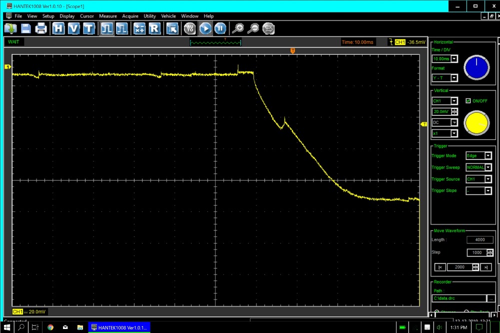

Should all shift solenoids have a pintle hump when turning on and when turning off?
I am checking the shift solenoids on a 2002 crv and I don't see a pintle hump when any of the shift solenoids turn on. But I see a good pintle hump when the shift solenoids turn off.
The vehicle shifts fine except on the 3 - 2 downshift. There is a delay before 2nd gear engages.

Yes. I will get a screen shot today. I should not have said all shift solenoids. I've only checked shift solenoid b and c. Neither one had a pintle hump when turning on. Solenoid C had a hump when turning off. I have not checked B turning off.

Here are some screen shots.
Shift solenoid C turning on:
Shift solenoid C turning off:
Shift solenoid B turning on:
Shift solenoid B turning off:
These are the only shift solenoids I've looked at. I thought there should be a pintle hump when they turn on and when they turn off. But I guess this is not always the case.

Are those all CURRENT waveforms? Pintle closing is, generally, viewed in a VOLTAGE waveform, taken from the control side of the circuit.
Here is a video of ScannerDanner explaining injector waveforms. The principle is exactly the same for solenoids, although it is harder to see the pintle/poppet movement. This video shows how circuit design can affect the waveform.
