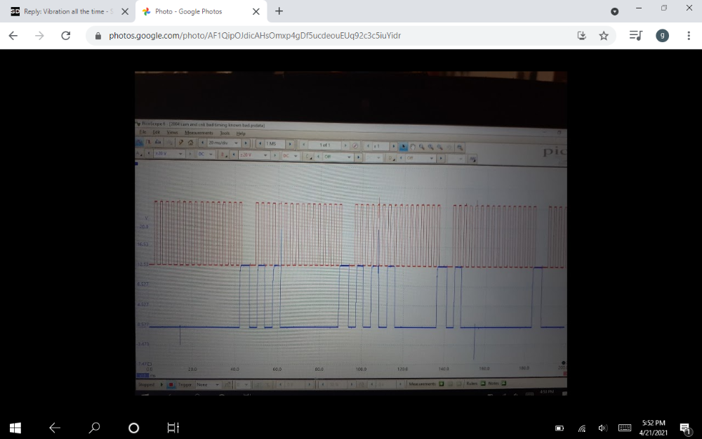

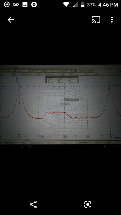

Gazmendhajra wrote: it's like drum's beating under the engine
Are you saying that you can hear lifter/rocker noise?
Valves with too much lash will open late, and close early. Valves that are too tight will open early, and close late.
Last edit: 6 years 10 months ago by Chad.
  • Gazmendhajra
  • Gazmendhajra's Avatar Topic Author
6 years 10 months ago #36019 by Gazmendhajra
Replied by Gazmendhajra on topic Vibration all the time
No it's like missfire lak of fule and it shake's bad , I haven't checked the valve clearance yet but I did check the chain and it had play on it now I don't know if it's the tensioner or what , the vvt is only on the intake side not the exhaust I checked the dowel pin hole and it on the advance side like it's supposed to be I really think the chain needs to be replaced

And when energizing the vvt solenoid car stalls , unplugged still shake's

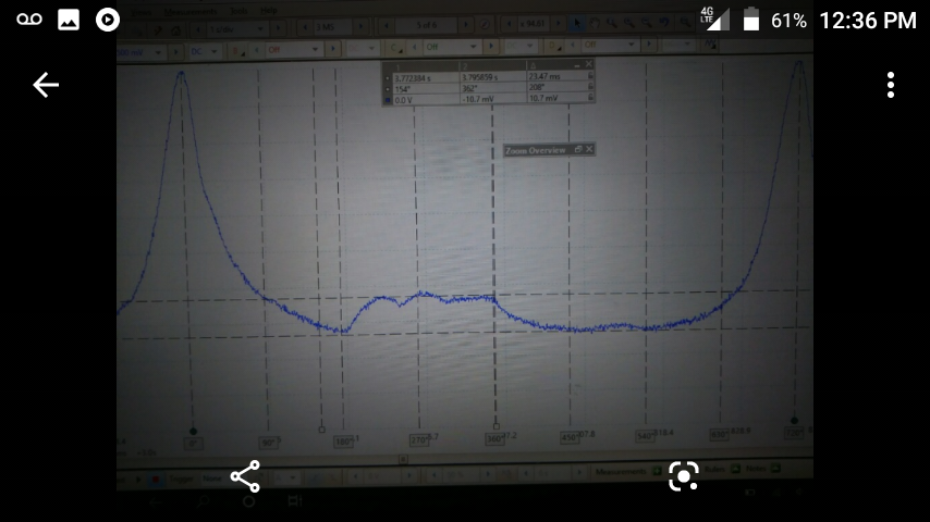

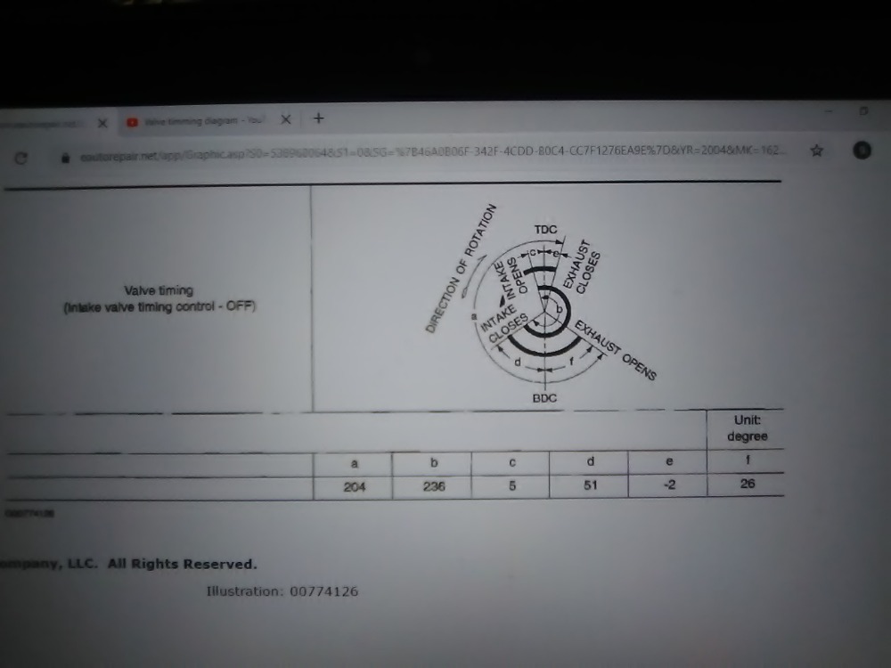

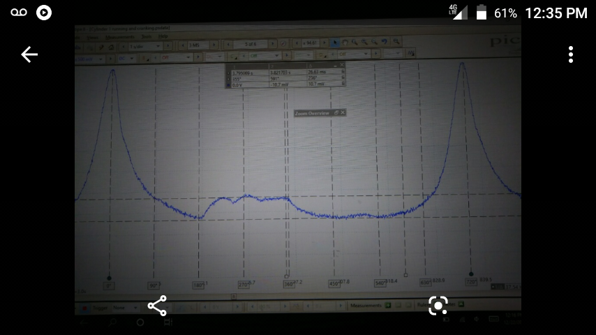

This is the spec and I did the measurements on the exhaust and intake opening and closing and if if u look at the third box of the measurements u see the cam lobe degrees degrees and the over lap is 7degrees the first one is the exhaust waveform
  • Gazmendhajra
6 years 10 months ago #36036 by Gazmendhajra
Sorry the first one with 236 degrees is intake
  • Gazmendhajra
6 years 10 months ago #36038 by Gazmendhajra
I got the degrees off its 360-154=206-2=204 thats cam lobe
  • Gazmendhajra
6 years 10 months ago #36042 by Gazmendhajra

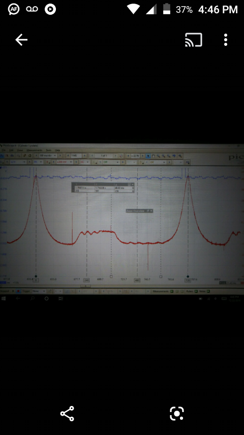

And the sweet thing about in cylinder pressure transducer is once u get the specs there is no need for dial indicator or a degree wheel and taking of a bunch of stuff
  • Gazmendhajra
6 years 10 months ago #36048 by Gazmendhajra
This is were my exhaust needs to open 154 degrees Wich is 26 degrees bbdc and close at 358 Wich is -2 degrees+ -2 degrees Wich equals 204 came lobe. And intake opens at 355 and closes at 591 if u put it on a 360 degree wheel that would be 5 degree btdc and closes at 51dgrees abdc Wich equals 236 cam lobe .and I think is 3 degrees overlap bc -2 and 5= 3 over lap

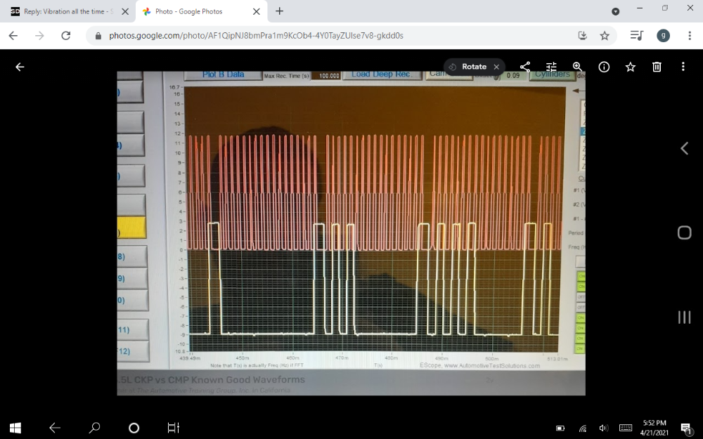

5 years 6 months ago - 5 years 6 months ago #48364 by Gazmendhajra
I'm sorry guys this case study was a year a go but didn't want to leave it open without a fix ,the problem was I didn't analyze the waveform .and the problem was in front of me the whole time it was a tooth missing on the crankshaft signal plate when I was looking at the known good cam and crank I thought it was ok but I missed it .
Last edit: 5 years 6 months ago by Gazmendhajra.
  • Gazmendhajra
5 years 6 months ago #48401 by Gazmendhajra
Well I was wrong and I have the correct signal plate there are two types and there is no way a missing tooth would cause a waveform to look like that don't know what I was thinking ,still think it was timing or cam lobe problem I will never know got rid of the car .sorry for the confusion.
