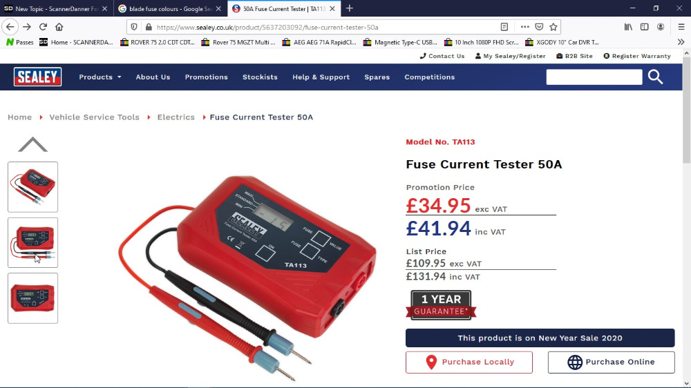

Sealey TA113 Amp Hound Parasitic Drain Tester Unboxing Rough & Ready Bench Test was created by Andy.MacFadyen
This is an extension of a thread kicked off by Dylan located
Here Link to Original Thread
Unboxing: Well packed arrived promptly in mine arrived good condition although Dylan had problem out of the box that luckily turned out to be a minor issue with his but read his post in the other thread.
First reaction seems like a quality item, it is however one of those tools where you have to read the instructions before trying to use it as the user controls are a bit dated by modern standards.
Link to Instruction Sheet PDF
I had originally intended to test it using a 12v Lead-Acid booster pack using decade box as variable load however I had an Bluetooth battery monitor complete with an inline mini blade fuse and as I previously found draws about o 20ma and decided to use this as a load and compare the readings with a low range DC clamp round the power + supply wire.
Having figured out how to switch it on and enter the fuse type and amperage I tested it with fuses from 1 to 20 amps in the fuse holder.
Conclusions
(1) It works.
(2) It dosen't have menu selections for all blade fuse amps ratings, although this affects accuracy it isn't a deal breaker just choose the nearest available.
(3) Accuracy is surpringly good and the results are repeatable.
(4) It is great as a way to find the crircuit causing a current drain without pulling fuses.
Remarks
Ideal way to use this is in conjuction with a low range DC amp clamp meter or amp clamp+scope.
Value for money & cost at the current UK sale price (below £40 deliverd) it is a bargain but ...........
Read the instructions first and keep them to hand

Thanks for the review Andy! Good to know the tool is pretty accurate. I still have to put mine to the test. Next parasitic draw will be mine
Good point on using it in conjunction with an amp clamp.
