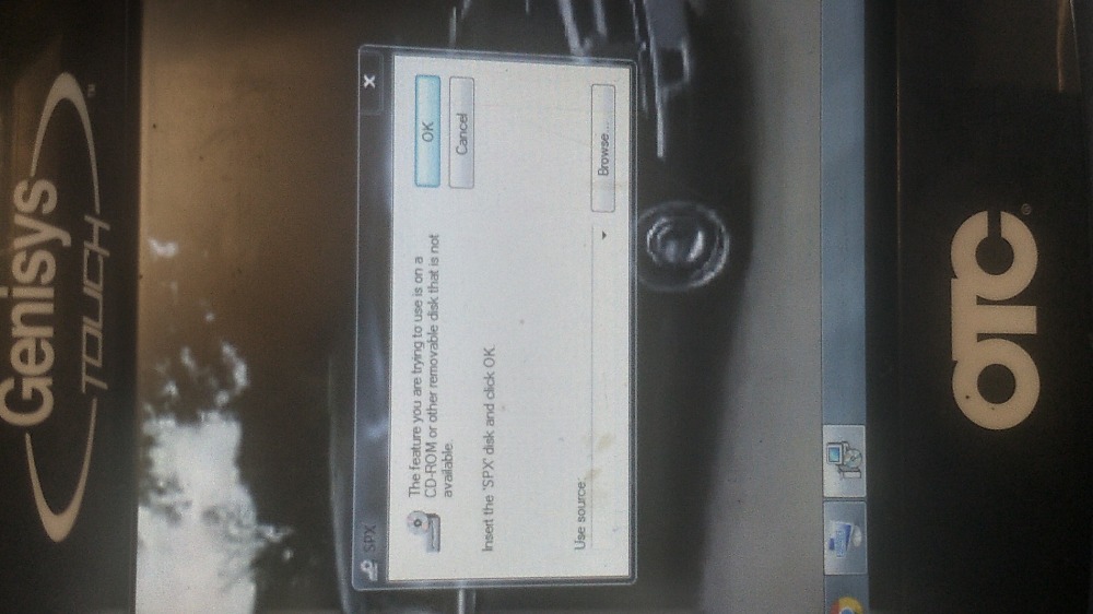

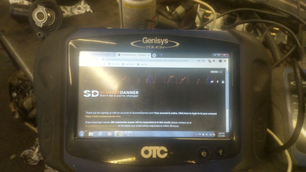

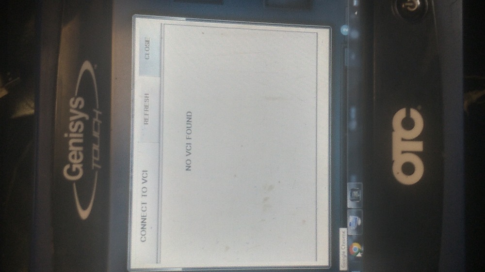

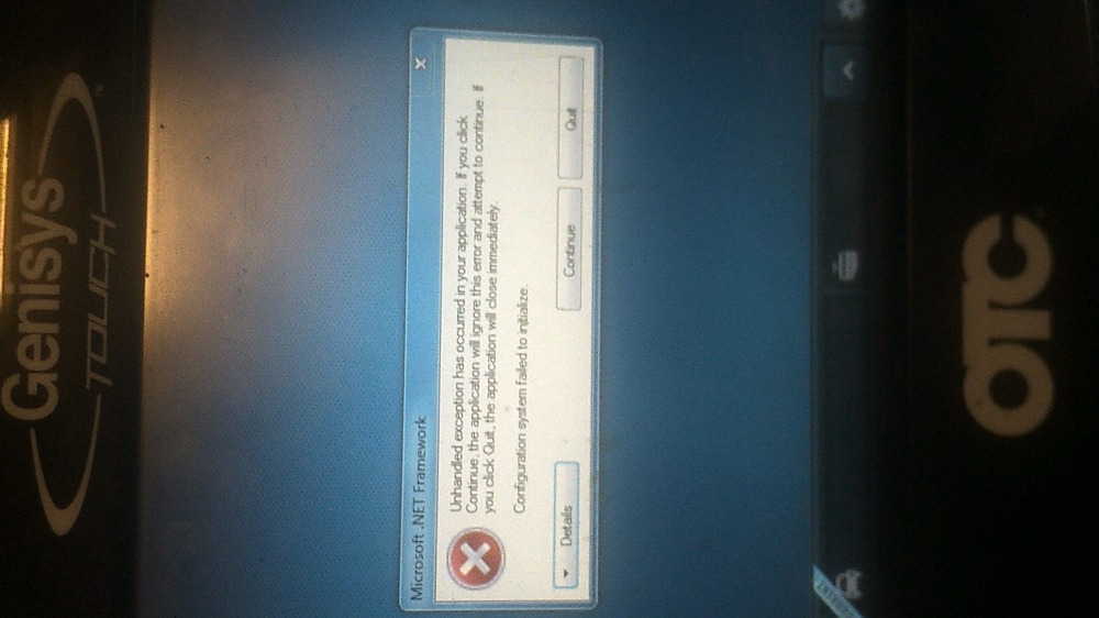

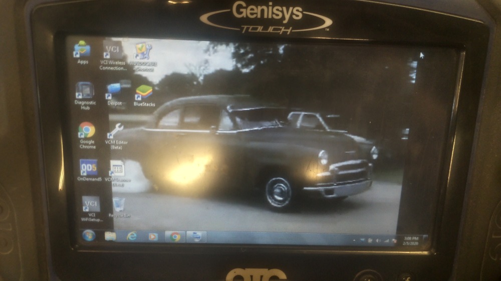

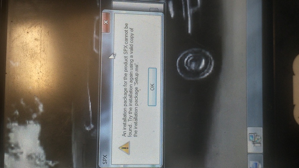

Hey all, long time reader first time posting. Bought a genisys touch that had some prior issues and thought I would try and do what graywave did. I have some knowledge with operating systems and the like but for some reason I cannot get this unit to work as it should. Before we unlocked it I've always had a .framework error when trying to connect to a veh. Also the vci will not connect through Bluetooth so the only way to diag is via USB cable, this was also an ongoing problem. Vci is visible on my PC, laptop and phone and on the tablet itself when running win7, the hub does not see it. Very frustrating. So we unlocked it hoping I could fix the problems in Windows. No luck. Also have a new error popping up asking for spx install disc. Also have questions regarding depot. Pics below of the errors I'm dealing with. Hopefully someone else has done this or ran into this problem.
Thanks in advance
Thanks in advance
