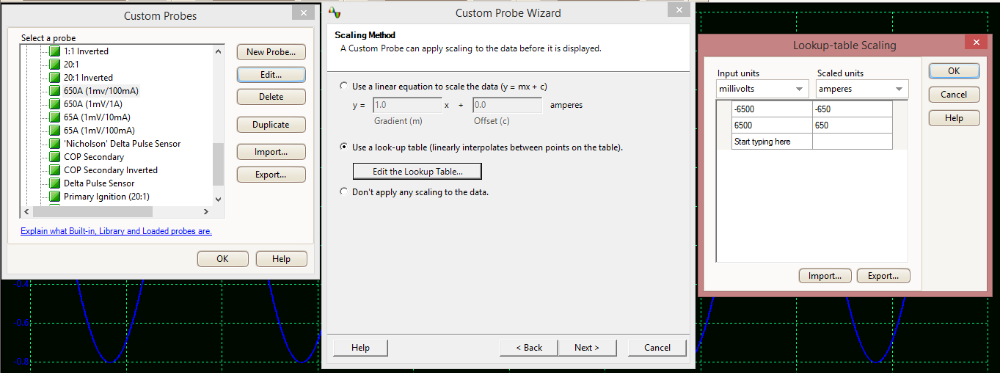

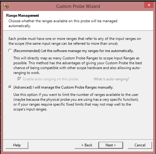

6 years 8 months ago - 6 years 8 months ago #37489
by Paul P.
Never stop Learning.

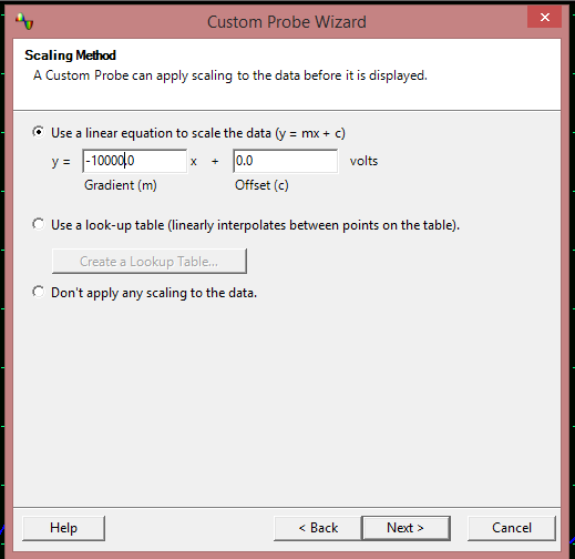

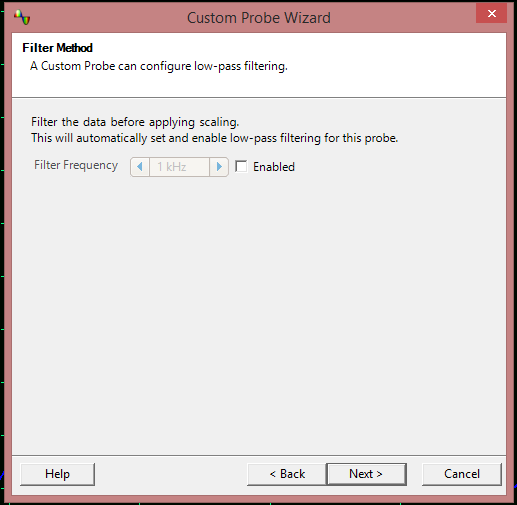

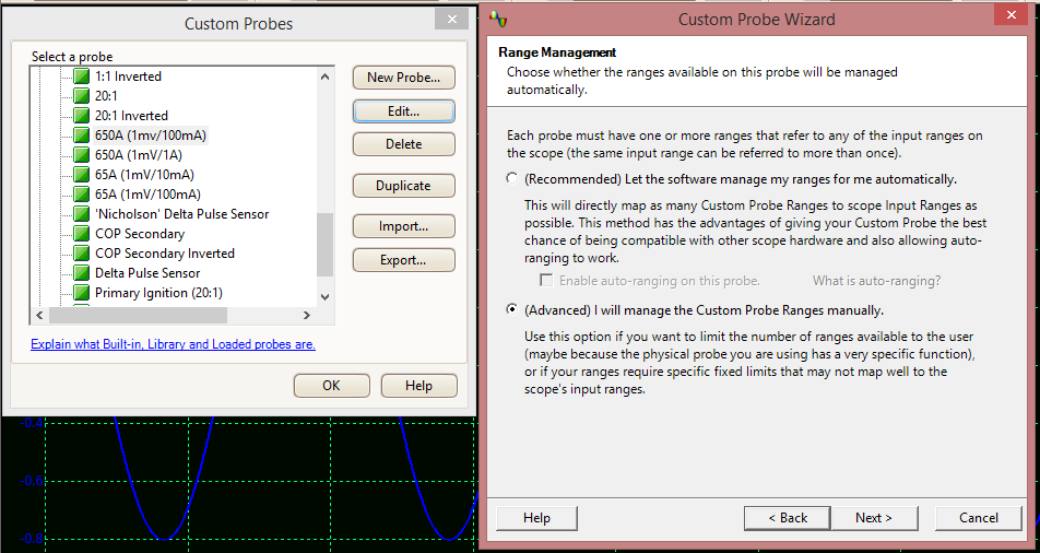

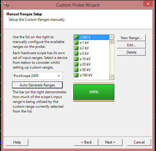

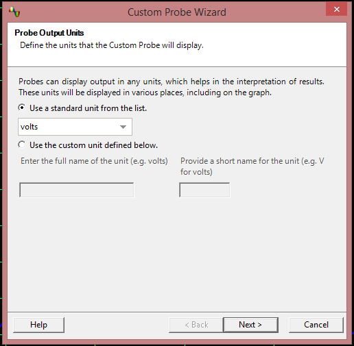

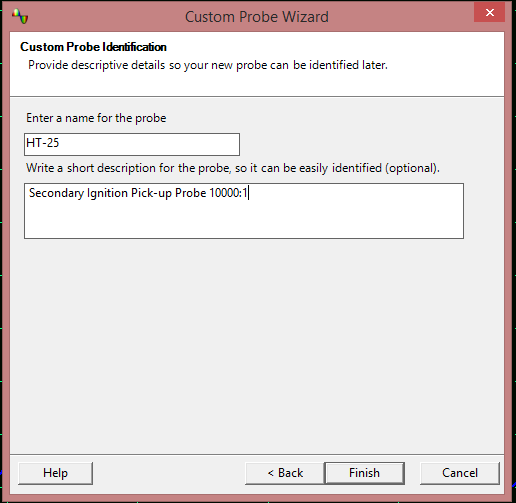

Replied by Paul P. on topic Hantek CC-650 Amps and Sec. Ignition probe HT-25 with Picoscope 2205A
HT-25 Custom Probe
Tools>>>Custom Probe
I used a '-' in front of the 10000 to invert the waveform because, without it, the waveform may be upside down!
Select Advanced
Choose Your Scope from the drop-down and Hit Auto generate ranges.
*** Note you may not need all of these ranges, you can highlight and delete the ones you do not want!
Having the ability to filter the waveform here is an awesome feature because it saves you from having to do it later.
I strongly recommend leaving it alone for now until you are comfortable with the waveforms you are seeing and know what to expect.
Give your probe a name and your are done. I made 2 here one for the HT-25 Inverted and one without inversion. Both my probes were different lol!
This went rather well, so i will post the Amp Clamp Custom setting too. Just give me a bit.
And I would strongly recommend you watch these to videos:
Paul

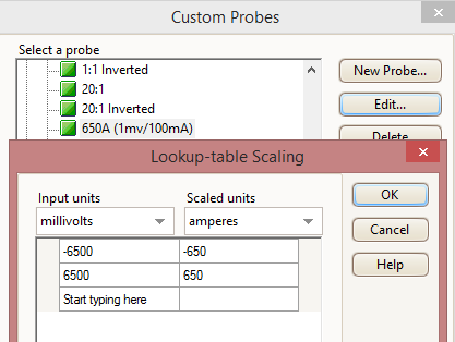

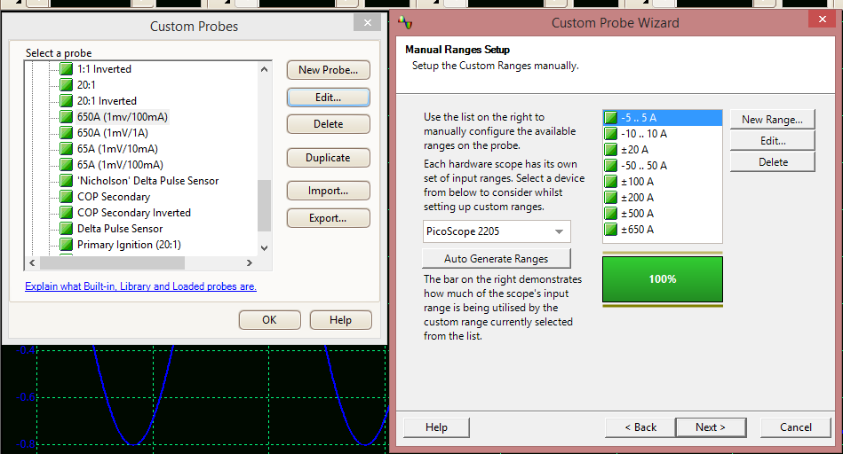

6 years 8 months ago #37490
by Paul P.

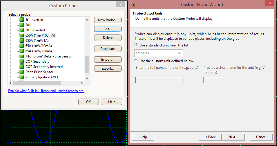

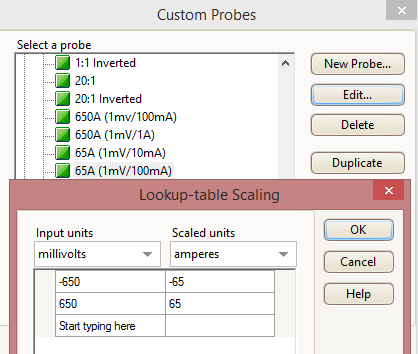

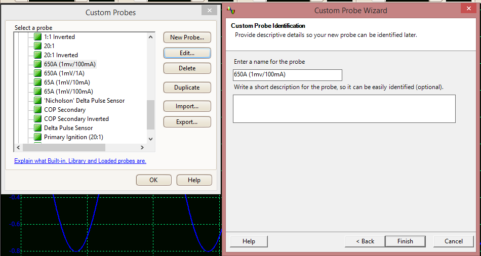

Hantek 650A Clamp (1mV/100mA)
Here I started in the 'edit' mode so we could see the data, you will select a new probe!
Select the look-up table and edit it, make it look like the table I have shown.
Select Advanced again.
Select your Scope Model, then hit Auto-Generate. Again you may not need all of these ranges and some can be deleted.
Name it, Finnish and you're done!
Next, I will post the data table setting for the 650 and 65 A Clamps with their respective settings

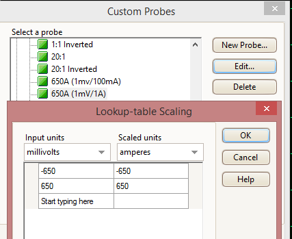

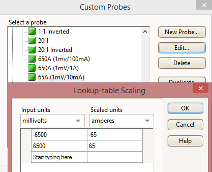

6 years 8 months ago - 6 years 8 months ago #37491
by Paul P.
Here's the data table for the 650 and 65 Amp Clamps with their respective settings;
Repeat and Rinse and you'll have four new custom probe amp clamp settings!
