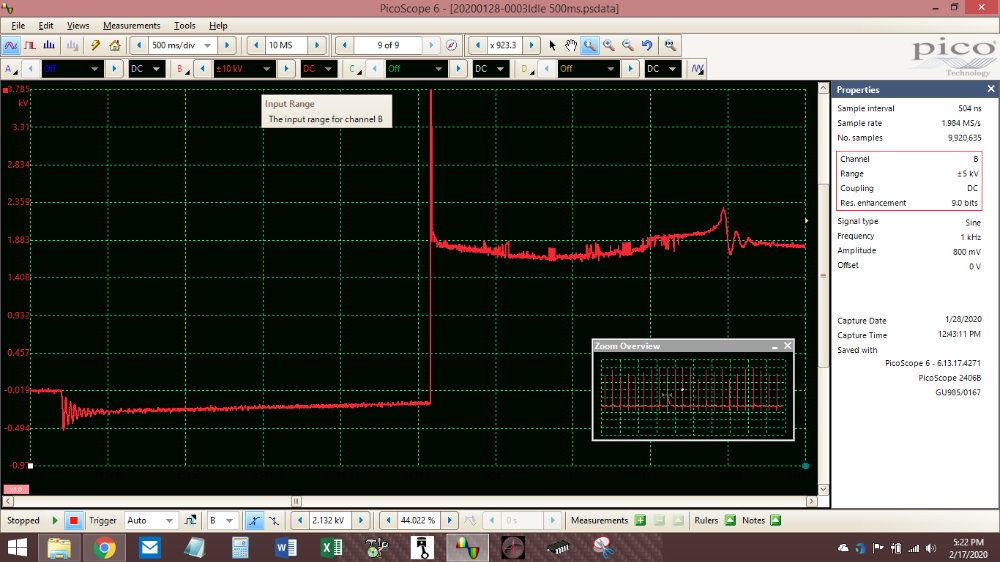

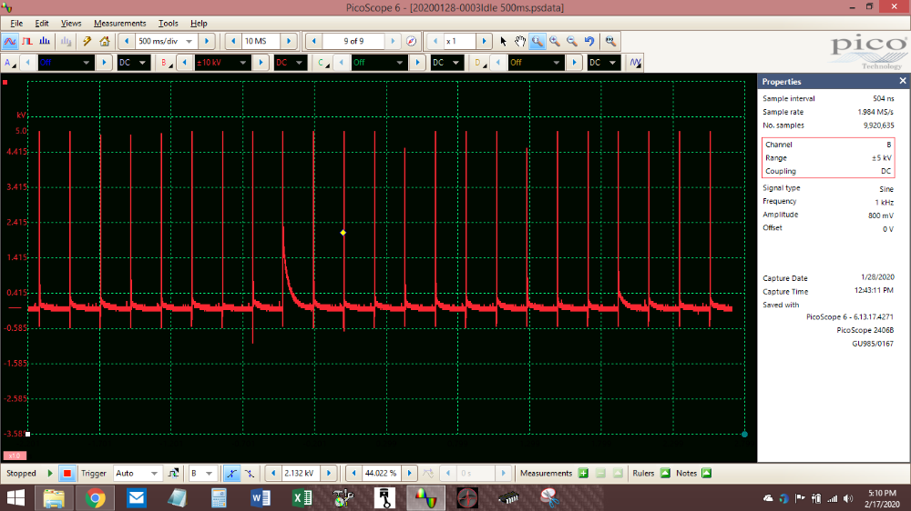

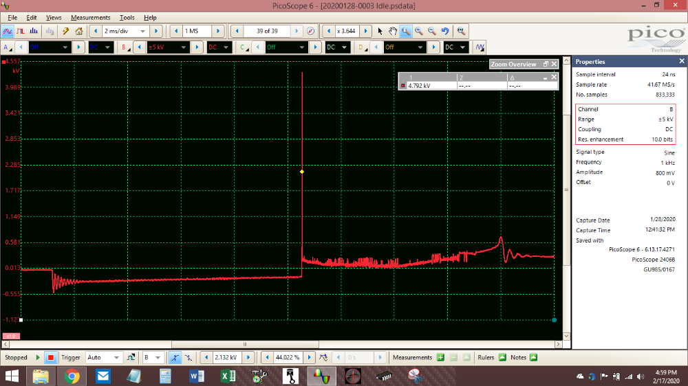

These photos are Secondary Ignition with the HT-25.
In this photo I'm am watching the spark occur with the motor running. Notice the time base 2ms and the sample rate 1MS, also there is a trigger to keep the waveform stabilized.
In this photo I have more time on the screen (500ms, the scope is in STREAMING mode ) and increased the sample rate.

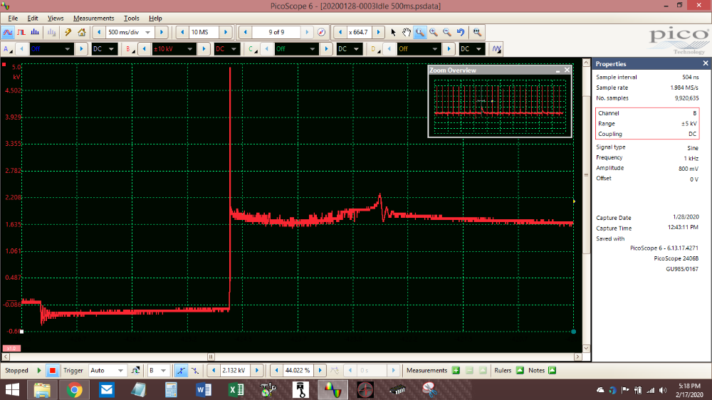

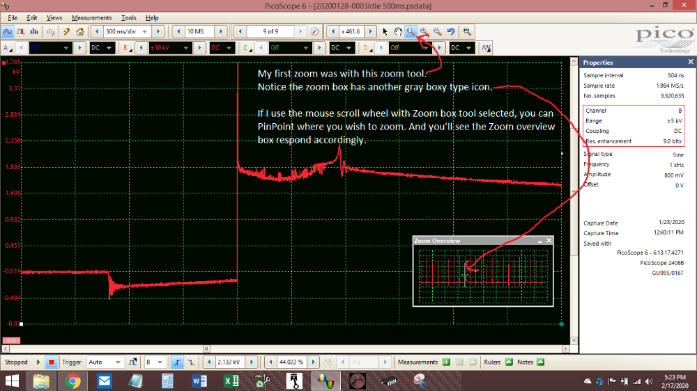

See the Spark that is 2 to the left of the trigger diamond? That spark occured outside of the combustion chamber(Cross-over). Here is the power of the Pico, in the next photo I'll ZOOM in and it will be 8-bit vertical Resolution, the next will be the same photo but with a little more resolution to clean it up!
with 8-bit
and now a little resolution enhancement
You can use the mouse scroll wheel to zoom in as well...
So as a general rule of thumb, when taking captures you want to see as they are occurring, use a smaller time base and a lower sample rate.
When using a longer time base 200ms and longer, you'll need to up the sample rate.
