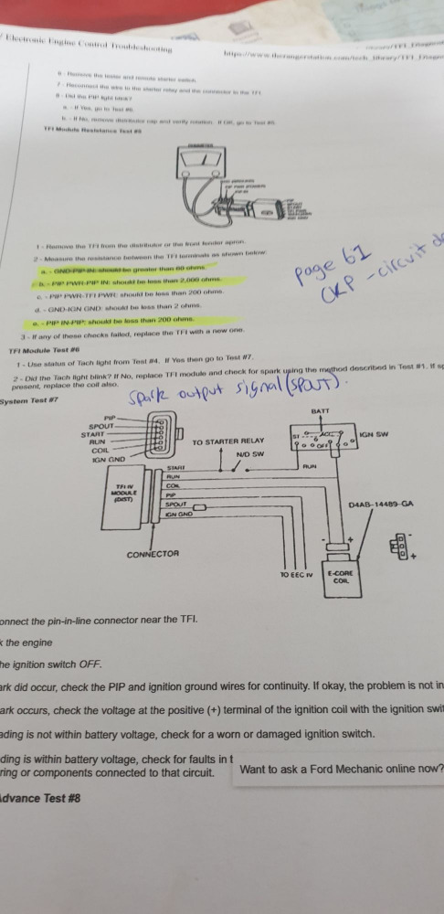

PIP is crank signal. Something specific to Ford is that during crank the CEL will go off showing it’s getting RPM signal.

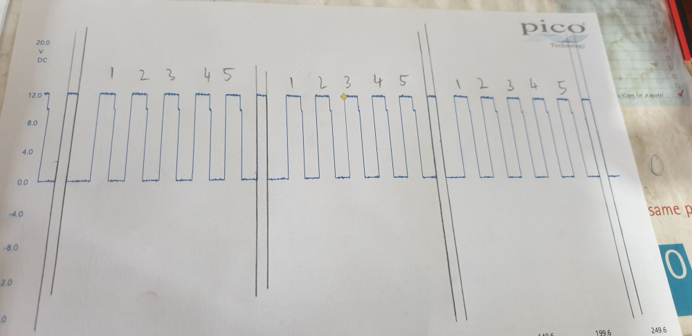

Okay sweet. found it and got a waveform. whats the easiest way to convert this to an rpm and graph it?

also a question on the above waveform would i say the 5 wider waveforms would be ther reluctor then what is the narrower waveform represent?

Repetition = Revolution
You can use rulers from the bottom left and drag them to where you want to measure. Should display rpm between
Or click measurements, pick channel, change measurement type to frequency, and choose between rulers... and place your rulers. Frequency is pretty much the same as RPMs. Its a measurement per second and RPM is per minute
