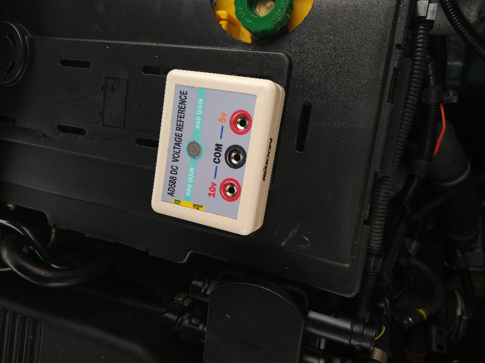

Voltage readings on multimeters can drift off if the internal battery is low a precision voltage source like this one doesn't cost much and will let you know if you can trust your meter.
Also very useful for making sure you are on the right scale when using a scope
