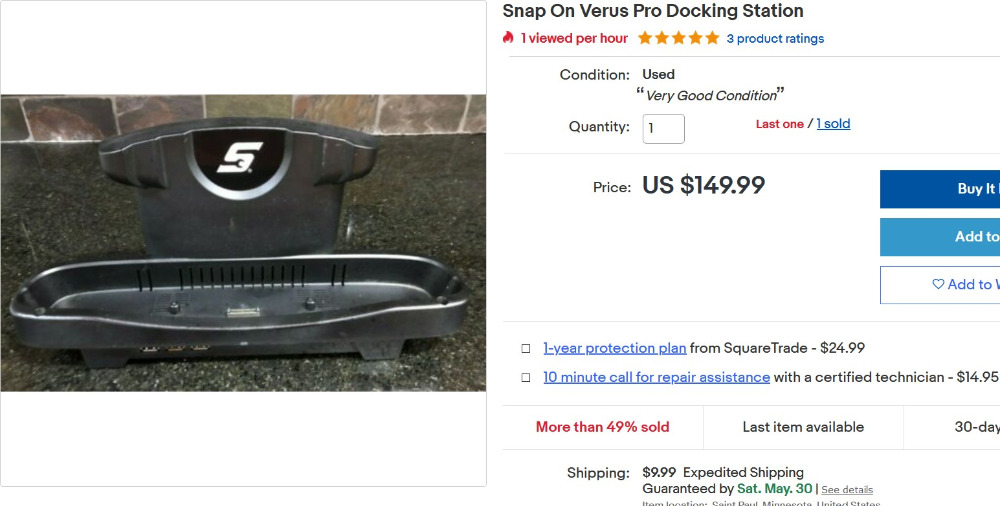

Guys, just bought a used Verus Pro (D10) and would like to know how to project it to my diagnostic cart's computer monitor...which port on the Verus is used ???....TIA !!...I project my Pico using the HDMI port from my laptop to the monitor and works great !!

You cannot connect a monitor, directly, to a Verus pro. You will need the Docking Station. (Part # EAA0365L04A)
shop.snapon.com/product/VERUS-PRO-Access...-Station/EAA0365L04A
There's one listed on Ebay, right not, for $149.99. We can't post links to Ebay, but here is the Ebay Item #:
eBay item number:
313067458375
Alternatively, you can log in, remotely, to your Verus from your laptop using Windows Remote Desktop Connection. This will allow your Verus' display, and total control, to be accessed on your laptop.
