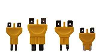

last year and the instructor gave us these parts and a diagram to build this tool that you put in place of the fuse that keeps blowing. It lights up while the short is present so you can isolate it or do wiggle tests. The problem is that I lost the diagram and don't remember how to build it, ha. I remember you were supposed to get those GTC fuse things so you had a good way to plug it into the fuse place and add long wires to it so you can bring it in the car with you if needed. He also said that the yellow things were important but I don't know what they are. Some kind of capacitor I suspect, with xx30 UF400 on them. Does anyone have an idea of what I'm talking about here? I'm working on a short to ground now and thought this would be helpful.

Not exactly what you are asking for but you'll find these on Amazon and you can build your gear; the company is general technologies corp. Or just blow a fuse and solder some wire and a socket to it...

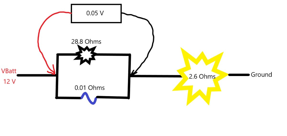

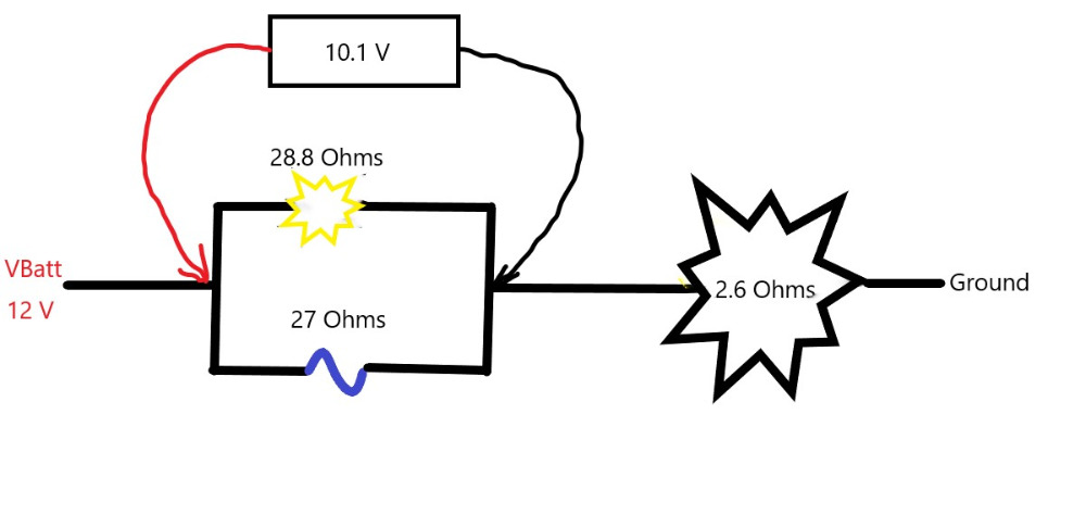

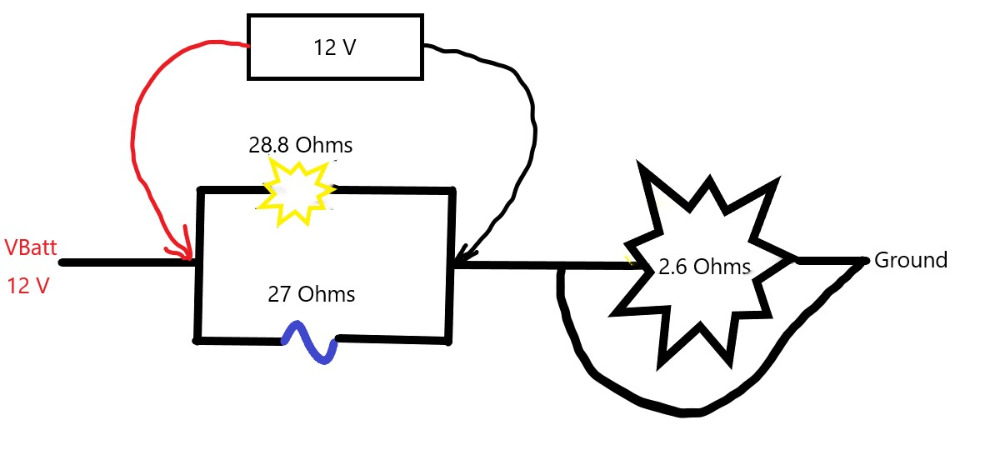

The indicator lamp is 5W and the load lamp is 55W in the following example. I've used hot resistances for them calculated from wattage. And I'm using the specs for a 10A e-fuse from the datasheet I linked earlier in the thread.
Here's the circuit under normal operation. The e-fuse and indicator lamp are the first resistance in a series resistance circuit with the load lamp being the second resistance.
Now with the circuit shorted to ground you've got system voltage across both the indicator lamp and the e-fuse. Lights the lamp and trips the e-fuse. Total current limited to less than 1 amp.
This is the tripped circuit with the short removed. Most of the volt drop is still across the indicator lamp and e-fuse. Indicator is still lit which is why I questioned how useful this device will be in the real world.
