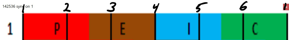

A piston chart helps us determine what position any given cylinder/piston is, in the 4-stroke cycle. It is used in conjunction with a "Sync". The "sync" is a signal that will mark the location of one cylinder. For example, an Ignition Firing event. Ignition Firing events happen VERY closely to TDC. So, If we mark the Ignition Firing Event of cylinder #1, we have essentially marked the TDC position of cylinder #1. If we mark two consecutive (same cylinder), Firing events, then we have marked out 720° of Crank rotation. 4-Strokes. A piston chart is placed in between these two "Sync" marks.

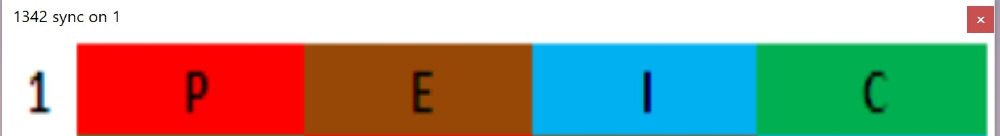

This is the top line (one cylinder) of a 4 cylinder piston chart. It is divided into 4 colors. Each color is 180° of crank rotation, representing one of the four strokes. P = Power, E = Exhaust, I = Intake, C = Compression.
This is the top line of a 6 cylinder piston chart. It, too, is divided into 4 colors, 180° each. But, it also shows, 6 partitions.

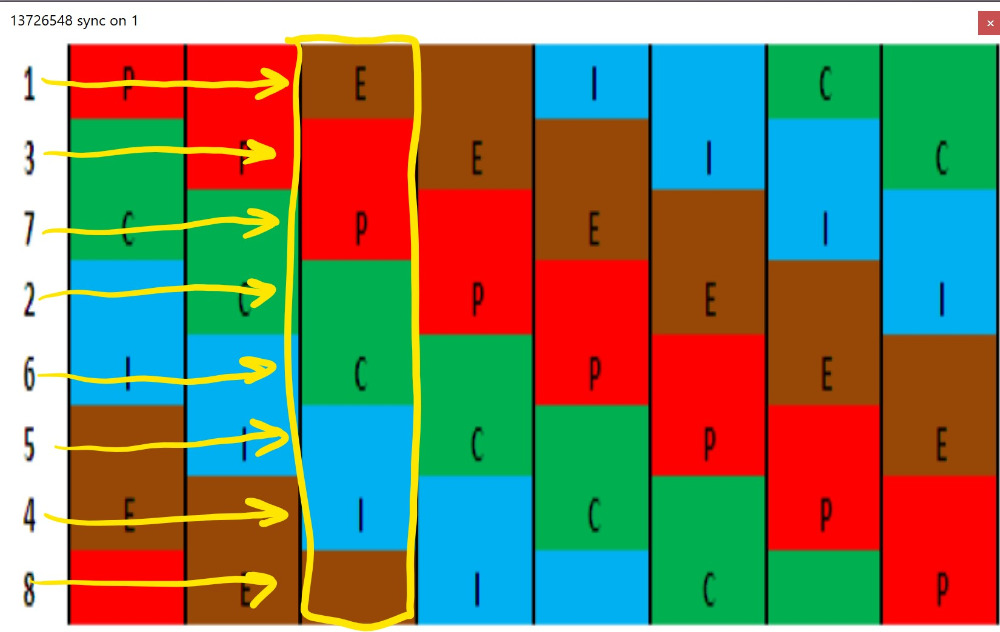

Now, let's plug in the Firing Order and bring in the rest of the chart.
Looking at the yellow box, we are 180° after TDC of Cylinder #1. Cylinder #1 is beginning its EXHAUST stroke. At the same time:
Cylinder #3 is halfway through its POWER stroke.
Cylinder #7 is beginning its POWER stroke.
Cylinder #2 is halfway through its COMPRESSION stroke.
Cylinder #6 is beginning its COMPRESSION stroke.
Cylinder #5 is halfway through its INTAKE stroke.
Cylinder #4 is Beginning its INTAKE stroke.
Cylinder #8 is halfway through its EXHAUST stroke.

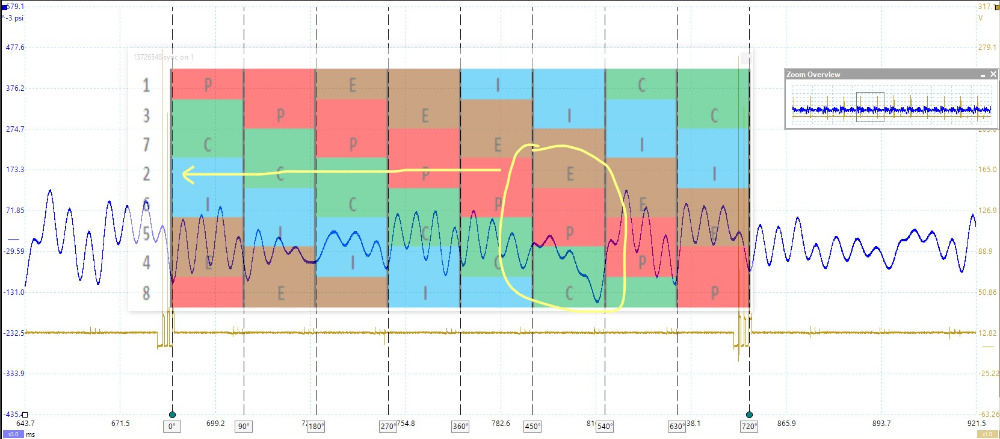

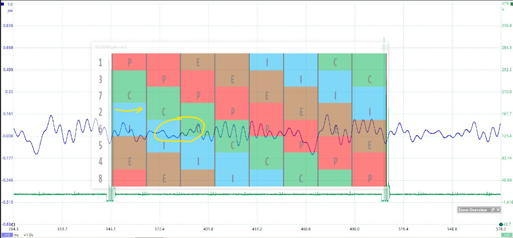

Lay this over a tailpipe pressure waveform, for example, and you can see what position any cylinder is in, at any point in the waveform.
This image shows a misfire on Cylinder #2. You can see the exhaust pressure dive, as the #2 exhaust valve opens, indication of a misfire.
We can, also, see that during cylider #2 COMPRESSION stroke, Exhaust pressure is elevated, indicating Exhaust valve leakage.
This "fish-bite" misfire could be felt, but flagged no codes, or misfire counters.
