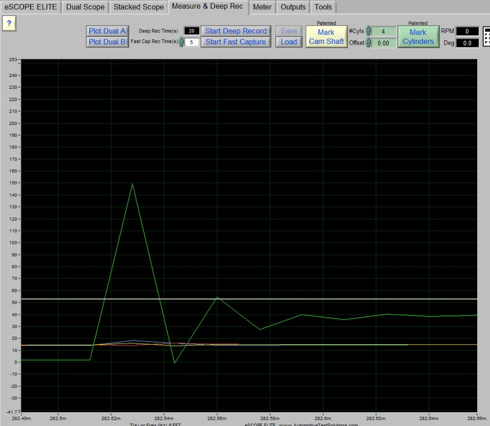

My biggest complaint about eScope is the lack of individual channel scaling (in Deep Record Mode). I had other complaints, too. But, I have gotten use to them and have learned how to adjust. Like offsetting traces. I like Pico's click and drag method of moving traces up and down the screen. eScope uses a cursor button to "jump" the traces up and down.
In short, this scope makes things quick and easy! I would highly recommend it to a mobile guy that want's to get in, look at the data, see the fault, and get out.

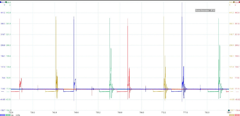

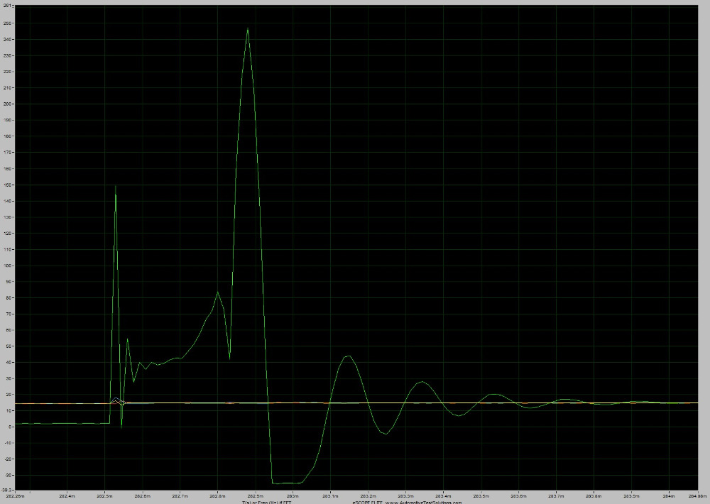

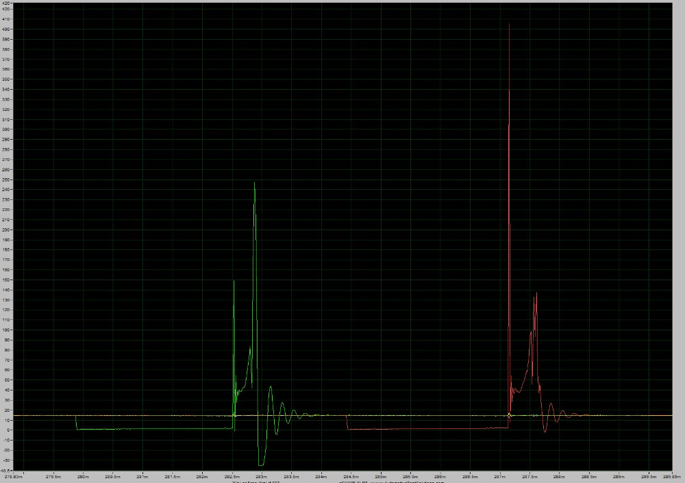

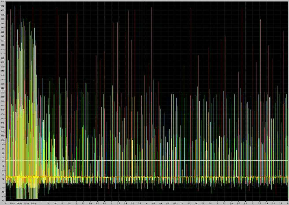

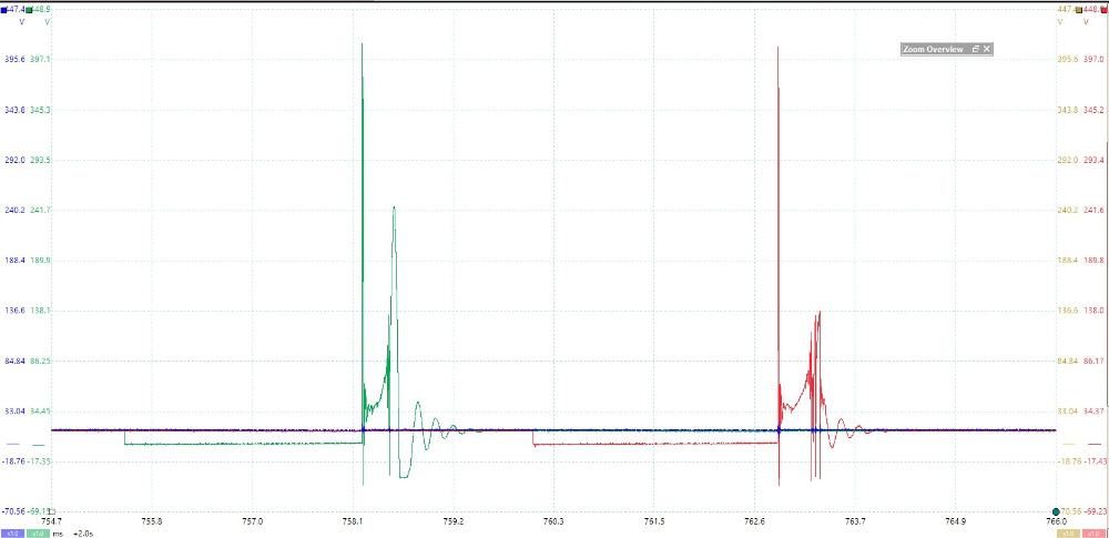

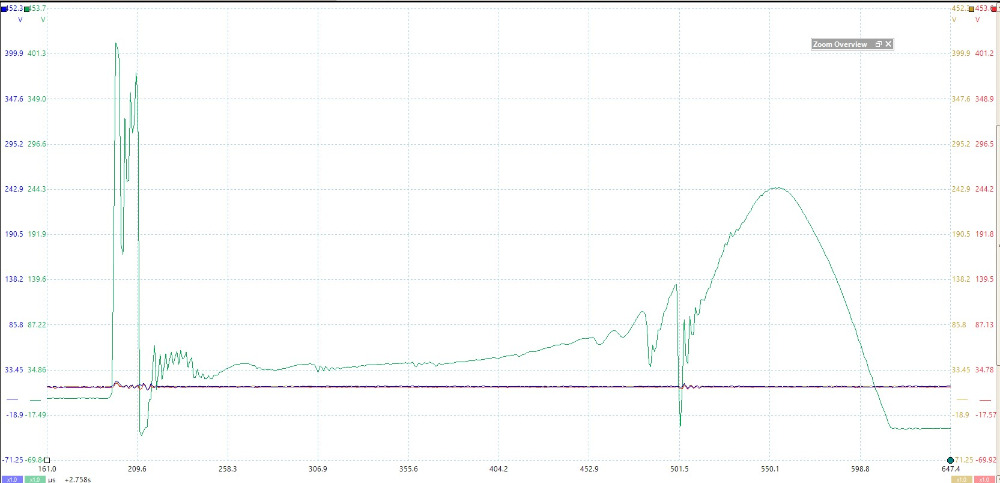

When it comes to pure scope sampling power, and saved waveform manipulation, I have to chalk that up to the Pico column. ATS eScopes 1 Mega Sample per second/channels can't compete with Pico's 400 Mega Samples per second/channels. ATS, also, can't compare when it comes to Math Channels and Reference waveforms. If eScope has these features, I haven't found them.

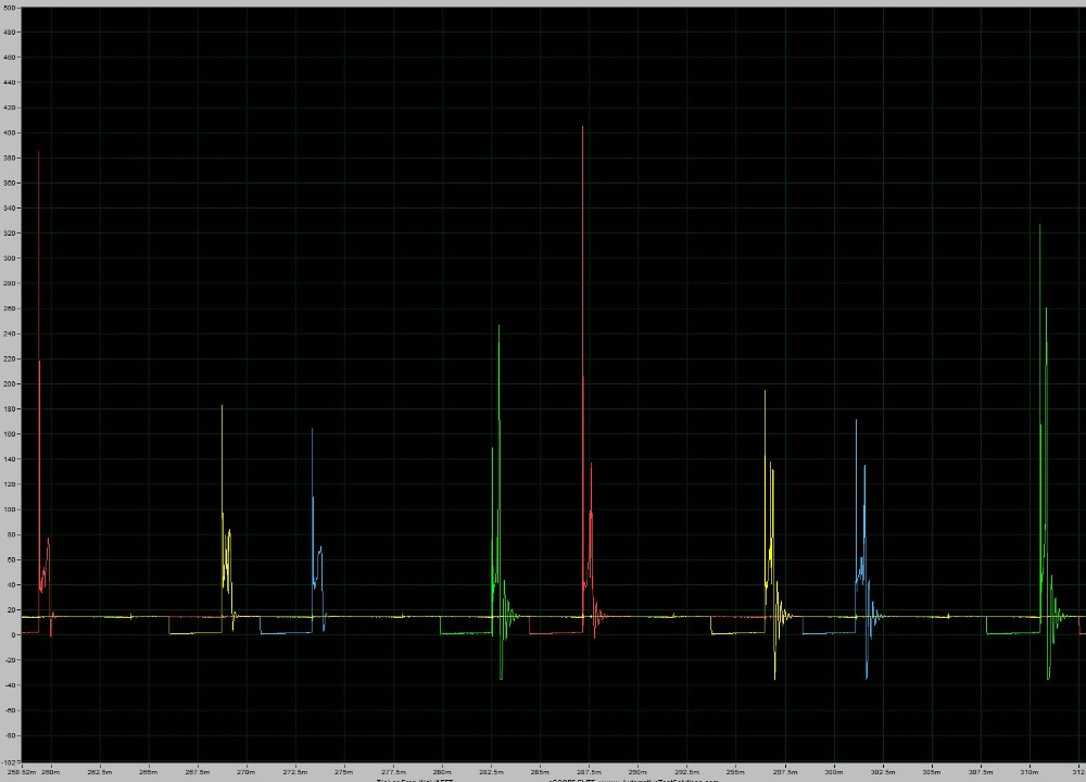

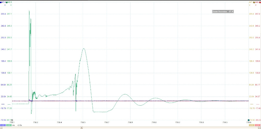

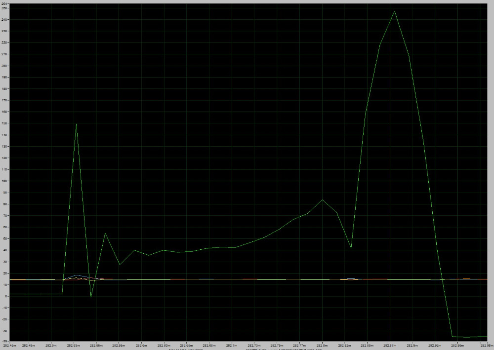

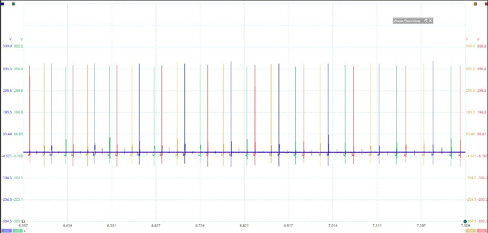

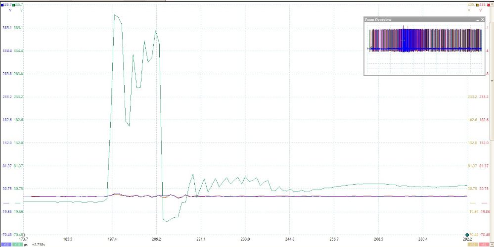

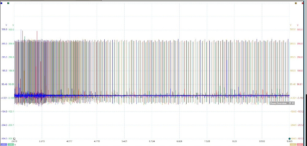

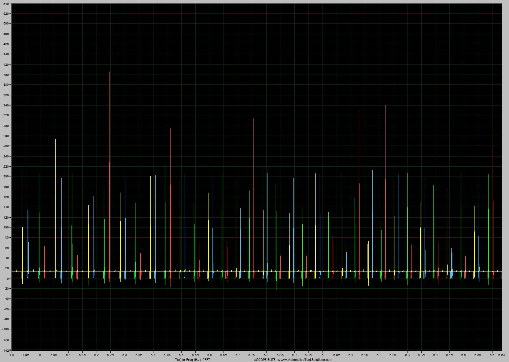

Here are some side-by-side comparisons. Both waveforms are the exact same capture, captured simultaneously, with both Scopes. The firing event you see in the eScope capture is the EXACT SAME Snap-Throttle firing event captured with the Pico. (This brings up another plus for the eScope. The eScope can handle 500V input, without attenuation. This capture with the Pico required $250 worth of attenuation (4 channels).
To push the limits of the sampling, I captured Primary Voltage of 4 coils, all at one. The buffer starts off with a snap-throttle and goes to idle. You can see, right of the bat, that the eScope has some aliasing. Peak voltages appear to be all over the place. But the Picoscope shows a, fairly, consistent voltage spike for each firing event.
Now, I'll start zooming in. The firing events of each scope are the EXACT SAME Snap-throttle event.

Thanks for the very good comparison / write up. That's good imformation!
